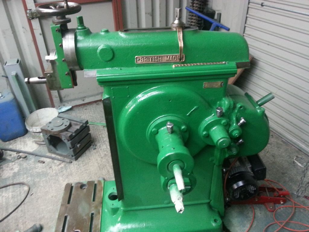

      Got a bit more painting sorted today and fitted the cleaned up oil cups, getting there slowly.

                ha ha it lives
                https://www.youtube.com/watch?v=3WZh3rSVOl0
                Edited By mark mc on 29/11/2013 13:30:34
                Edited By mark mc on 29/11/2013 13:31:32
                #136677
                  Splendid progress Mark !!
                  I wish my projects went so well.

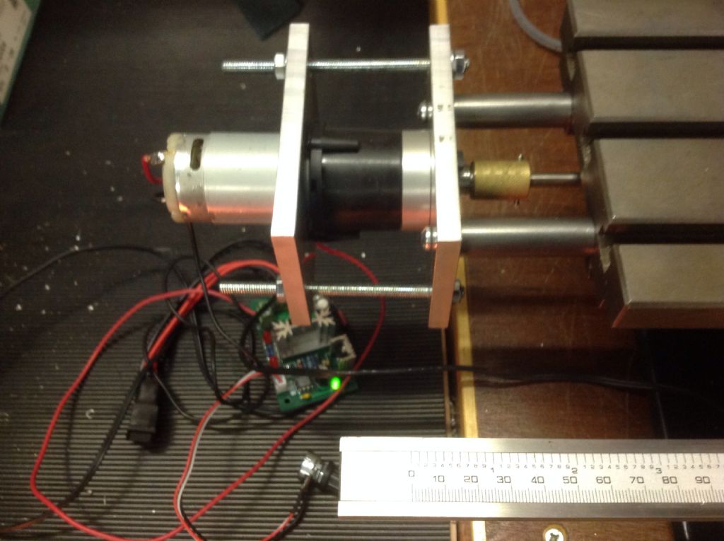

                              image.jpgI've managed to get some time to work on my DIY SX2 power feed. It's based upon a couple of examples I've seen on the web, so no apologies if you recognise any bits! First run today, and really pleased with the result. Next step is to mount the electronics. I think I may mount this remotely on the other side of the mill, not on the drive as per the examples I've seen. Spent less than £30 so far, so really pleased with that as well.

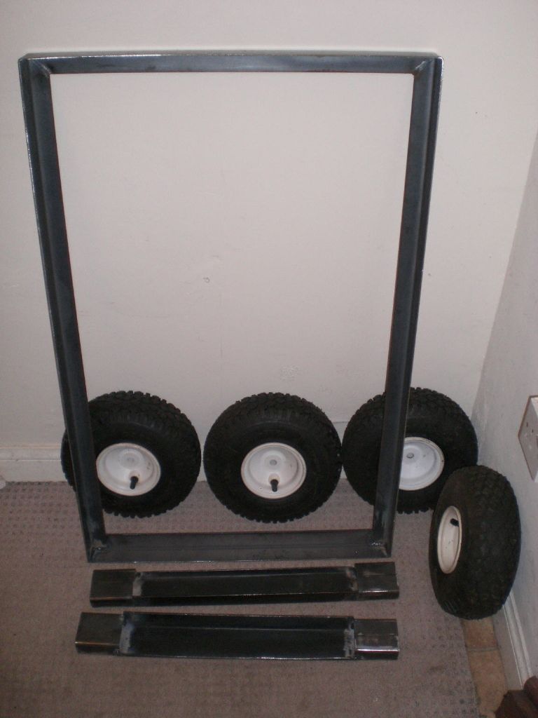

                                    Hi, not today but yesterday afternoon, started to make a small four wheel trolley to suite four wheels that I've had for quite a while. It will be approx 900mm long by 560mm wide, the wheels have pneumatic tyres and are 10" diameter. The trolley will fit in the back of my Astra Estate comfortably and will be reasonably lightwieght and will have a simple turntable for steering.
                                    I've made the basic frame, which is a couple of offcuts used as a test pressings from work and a couple of cross bearers made from a couple of parts that I salvaged from an old reclining chair I once had.
                                    Regards Nick.
                                    Edited By Nicholas Farr on 01/12/2013 19:38:15

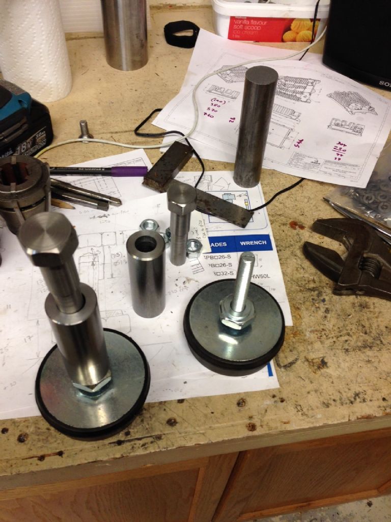

                                          The only machine mounts I could find (and there were quite a few of them to choose from) all had short fixing studs, so I had to make up some female bolts (looks like a bolt with a female thread at the end) so they could fit on my Bridgeport clone milling machine. And the front 2 mountings on the base of the machine are hollow, so I also had to make up a couple of spacers to pass the load from the feet up to the inside of the machine base, 4" from the ground. Nothing's easy!
                                          Machine mounts with spacers and female bolts
                                          Worked out nicely and after a bit of trial and error, the machine is finally on the level and a lot more stable.

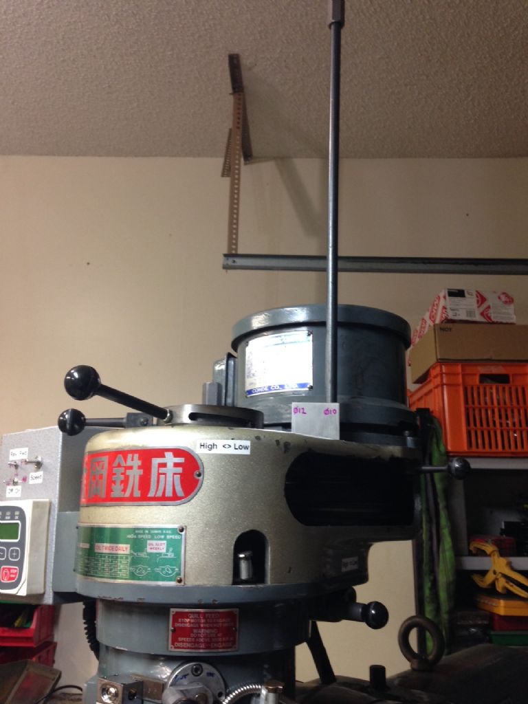

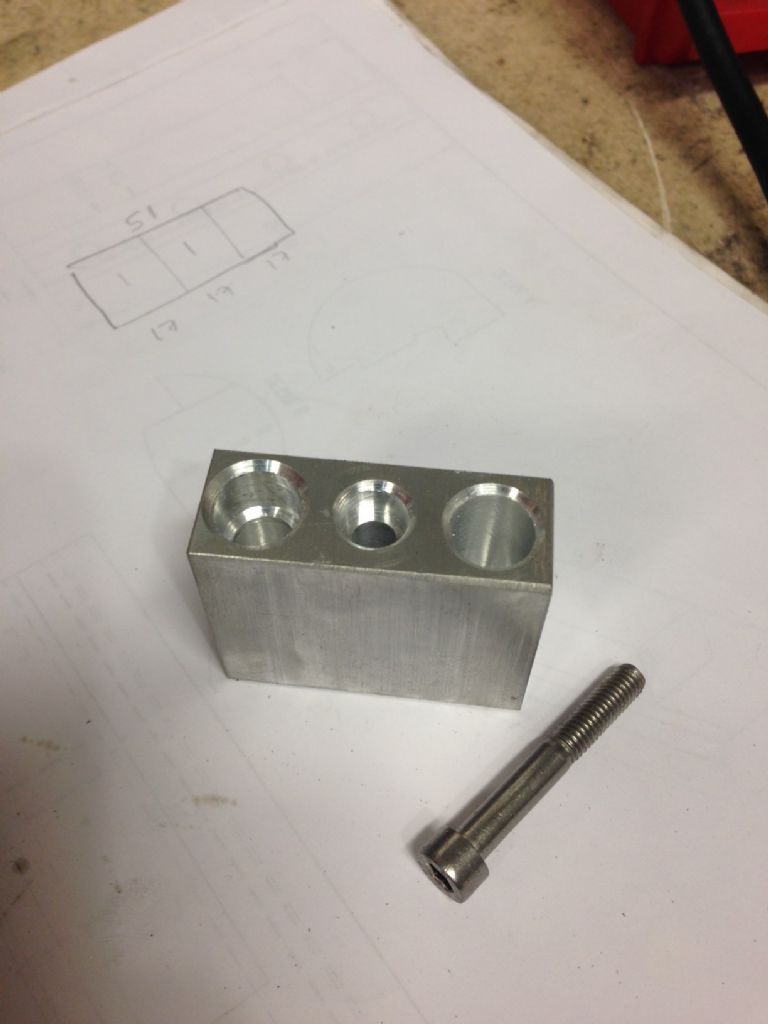

                                          Next day (Sunday), I made up a small block to hold my 2 drawbars on the head of the milling machine. The previous holder I mounted on the side of the machine near the knee works fine but each time I want to change from the drilling chuck to the collet chuck I have to swap the drawbars over. Sounds simple enough but doesn't speed things up keeping the spare at the other end of the machine.
                                          Drawbolt holder
                                          This is what it looks like in use. The spare drawbar is literally only inches from where it is needed now, ready to be swapped over:
                                          Drawbolt holder in use
                                          Didn't take long to make but should save a lot of time in the long run. Been meaning to do this for months…..

                                            Darn it Muzzer, you're showing me up; I never bothered to bolt down, or level, my Bridgeport. embarrassed The most I did was stick a wedge under one corner to stop it rocking. Still, really nice work. How's the parting tool holder going?
                                            Regards,
                                            Andrew
                                            #136927
                                            John Stevenson 1
                                              @johnstevenson1
                                              Shouldn't really matter much on a Bridgeport. When I had mine I opened a tin of Tapioca and blew it under with an air line.
                                              Stiffened it up no end.
                                              #136928
                                              Anonymous
                                                Posted by John Stevenson on 03/12/2013 12:14:47:
                                                That's no good, I don't like tapioca. Now rice pudding, that's different, especially with the skin and a spoonful of jam in the middle. smile p
                                                Andrew
                                                #136937
                                                Muzzer
                                                  @muzzer
                                                  Garage floor's not very flat or on the level and any wedges I put under the edges soon worked free. Now it doesn't shake so much and the table is actually level too.. Besides, they don't seem to sell tapioca here – almost as rare as metric fasteners which is odd, given that Canada is even more metric than the UK. The system may be metric but the materials come from the US.
