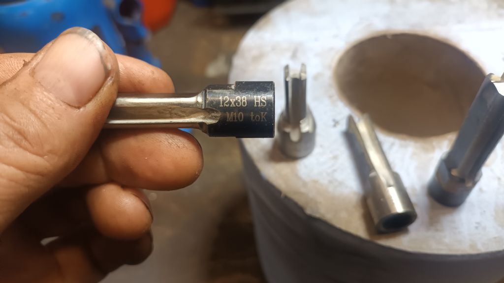

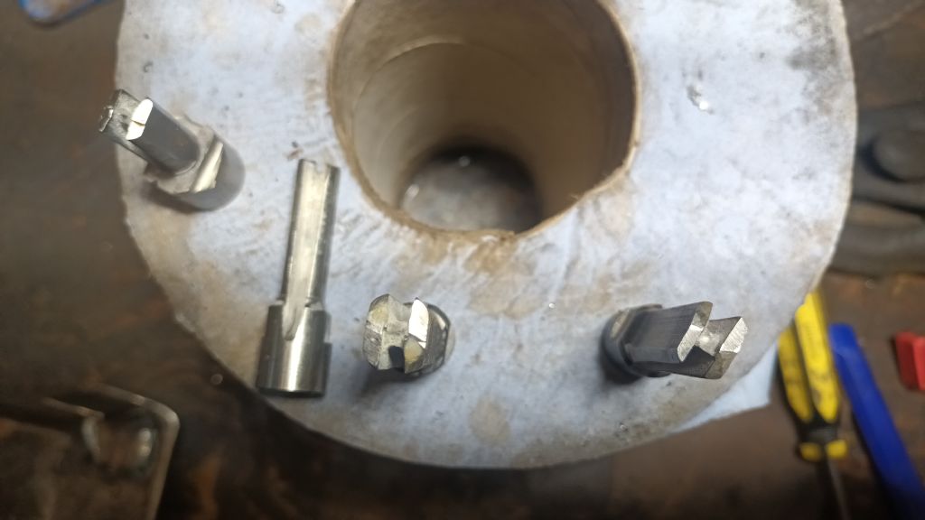

      Help identifying these would be appreciated. They are thread m10 on the end
      Thanks Colin

          Special made internal wrenches, but I can't imagine what for!
          Pete
          #658025
          HOWARDT
            @howardt
            Thread insert tools? Can’t quite work out with the numbers on the one I can see, first ought they may be insert tools or tang break off but the length doesn’t equate or the long grooves on the diameter.

              Internally threaded router bits.
              Like these
              #658047
                Posted by Andy_G on 26/08/2023 09:20:30:
                Like these
                I thought 'chipboard' straight away. Then wood work.
                #658055
                Mark Easingwood
                  @markeasingwood33578
                  Hello,
                  Not sure they are router cutters, but they might well be "slot mortise bits," generally used in the furniture making industry, as opposed to the Joinery manufacturing industry.
                  I think the KITY range had a slot mortise attachment.
                  Mark.

                    The one in you hand has M10 on it, are they threaded for mounting?
                    #658092
                    Andy_G
                      @andy_g
                      Posted by Mark Easingwood on 26/08/2023 12:19:59:
                      They could probably be either, but those don't look (to me) like they have end cutting ability that I think a slot morticer would need (but there are probably more types than I know about).
                      M10 internal seems to be used on all sorts of industrial routers (hand or bench), morticers, etc.. Seems common for automated routers for PVC window frame construction.
                      Have a look for 'Rotox' cutters: (Example )
                      (Other makes using the same fixing are available).
                      #658202
                      colin hamilton
                        @colinhamilton16803
                        Thanks everyone. So it looks like they are for wood working. I'll stick them on a shelf somewhere and forget that I have them!!
