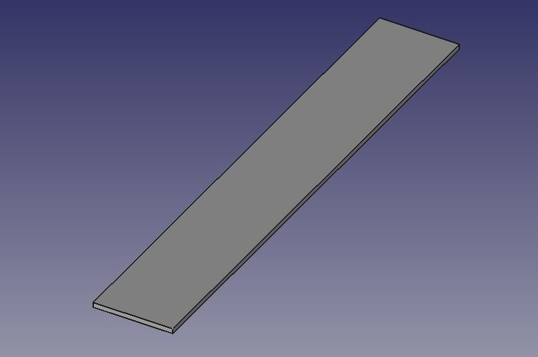

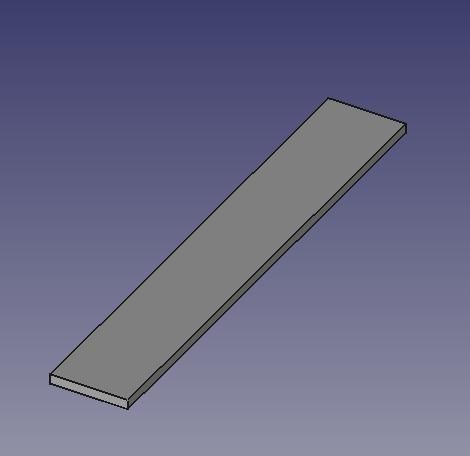

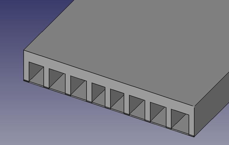

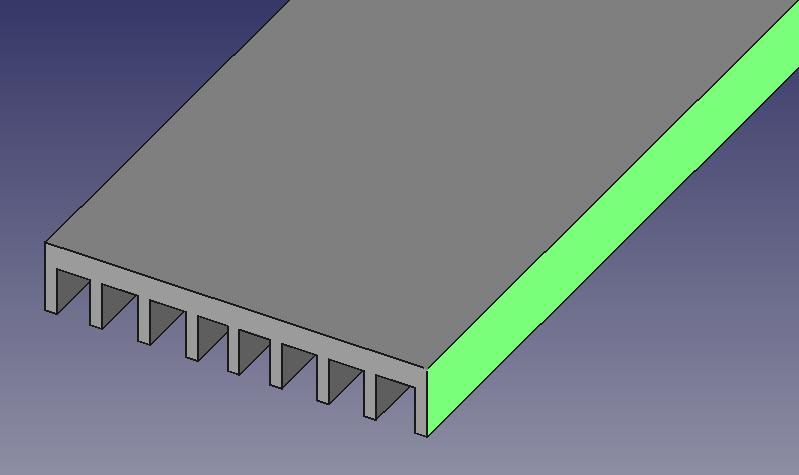

                                          #592869
                                            Posted by Michael Gilligan on 04/04/2022 13:09:55:
                                            Posted by Donald MacDonald 1 on 04/04/2022 12:52:46:
                                            Just forget I mentioned it, Don
                                            Feels as if Don has fixated on a particular answer and is unable to tune into other ideas! His reasons for rejecting Michael's suggestion show it hasn't been understood, sigh. However, I'll have one last go.
                                            First, a single sheet of anything is bendy. (Try waving a sheet of paper)
                                            Second, doubling the thickness of a sheet by gluing two together is still bendy, despite being twice as heavy:
                                            A much better approach is to increase the effective thickness of the sheet by fitting deep ribs:
                                            It's the increase in depth highlighted in dayglo green that makes the difference. Ribs, or even better a honeycomb, are lighter and stiffer than Don's two boards, use less glue, and there's nothing difficult about the construction.
                                            My images shows nine open longitudinal ribs, which might be overkill, and stiffen end-to-end but not sideways. Michael's honeycomb fixes this, or alternatively a second sheet could be fixed underneath. If the top sheet only is loaded, then the lower sheet can be much lighter than the top – 3mm hardboard would do.

                                                      Posted by JasonB on 04/04/2022 16:35:19:
                                                      Well there are difficulties for Don to construct that. He will need to be able to cut parallel strips of for the ribs, he will need to face the outer surfaces and he will need a flat surface to make it on.
                                                      Hope not, I would make the ribs out of DIY Store Smooth Planed Pine, like wot B&Q sell. This stuff is 18x44mm deep, other sizes available.
                                                      Assembly, lay sheet flat on floor and glue thin edge of rib to it. Dowels from rib into the sheet would reduce the strain on the glue. Or instead of dowels: screws, or those rotate in hole cam wotsits that clamp onto a screw-in spigot. as found on self-assembly furniture:
                                                      I'd probably just glue the ribs unless the table had to take more than average table weight.
                                                      Glued, staple or pin the lower sheet of hardboard, if it's thought worth the bother.
                                                      I hope Don has room to lay his sheets flat somewhere, because gluing them without taking on a warp whilst they're leant on a wall or straddling a horse will be difficult.
                                                      Edited By SillyOldDuffer on 04/04/2022 18:33:55
