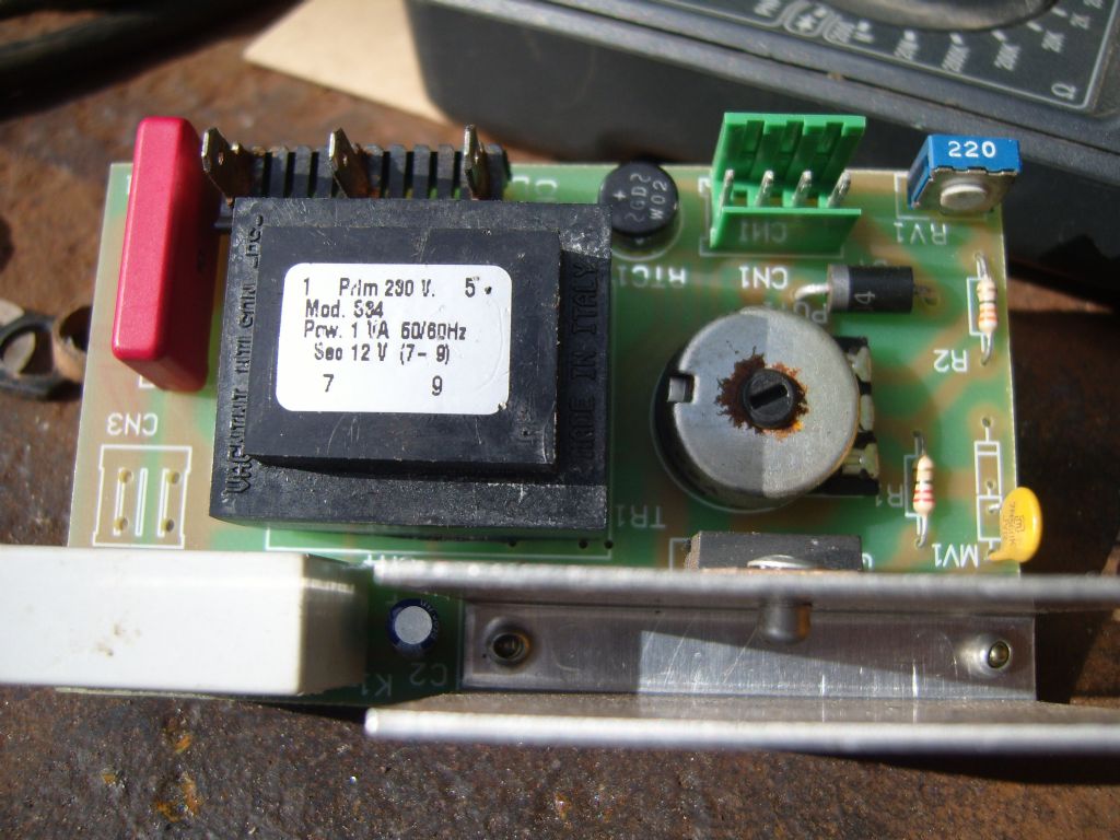

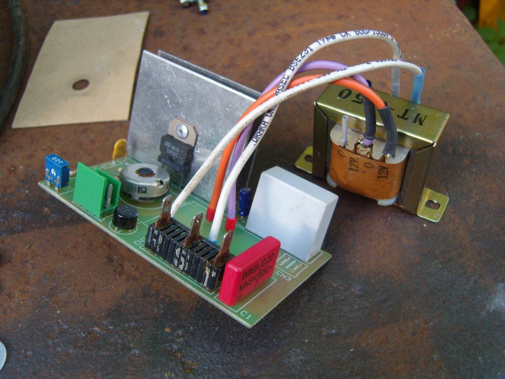

                            I was making a 10ft by 4ft metal trellis welding 6mm bar. The welder settings was halfway as I always leave it on that and the weather wasn’t extreme like it has been. I forgot to mention the gas still comes out the nozzle when you pull the trigger but I think this is a separate item. I think I’ve put a few pictures up in my album if I’ve done it right showing the inside of my

                              Hi George, it is quite common for a simple valve in the torch opened by the trigger to allow the gas to flow. However, in your second photo, it looks as if there is a piece of silver foil under the fuse on the circuit board, if so this ought to be removed and a replacement fuse of the correct value to be put in. I had and issue with my small MIG welder which was similar to yours and mine was as simple as the transformer on the circuit board failing.
                              It was replaced with one that I had, but I had to mount it off the board.
                              I would check that out as a starter first.
                              Regards Nick.

                                Well I’ve had a good look tonight at the internal parts of my mig welder and put some more pictures in my albums, I still can not see or make out the thermal switch???
                                I have removed the circuit board which controls the wire feed? The blown fuse looks like a 2amp one. Looking at the board the transformer which I’ve pictured on the board looks like it’s arcing or burning inside? Looks very sooty would anyone be able to point me to where I might get a replacement or how to fix it

                                  Hi George, I doubt very much you will be able to fix the transformer if it has failed, all you will be able to do is replace it, but you will need to know the output voltage and current. You could try someone like **LINK** or **LINK** for a replacement that would be suitable.

                                    I can't see a damaged transformer in your latest pictures, however there is a relay that has contacts which are showing some signs of distress and this has blackened the clear plastic case above them, normally caused by contact arcing. It may be worthwhile removing the relay case and try to clean the contacts. Contact cleaning tools are or were readily available and normally have a thin blade that has diamond dust or similar impregnated in it. Used to be used for cleaning contact breaker contacts on cars.
                                    May improve things but there again mat do nothing but worth a try and its easy to do. Power disconnected of course.
                                    Cheers Martin
                                    PS
                                    Judging by the pictures the fuse looks to have been subject to serious over current when it blew. The fuse link, copper wire, has a wide rupture gap and there is melt back of this link. It would be interesting to see if a replacement fuse suffered the same fate, if so that may be why some idiot used aluminium foil as a replacement be it a stop gap measure or not.

                                      Thank you for the advice on cleaning the relay with a fine diamond fill. I have done that and today I have used the welder for a Solid 2 hours welding various metals and it has not cut out once where was before it would have cut out within 10 minutes of its first use. Unfortunately I could only find a 3 amp fuse of the size to fit so I put that in as a temporary measure whilst I get the 2amp one.it would be interesting to see if the 2 amp fuse blows simular to the old one in the future? I’m not saying it’s fixed by any means but it’s working at the moment.
