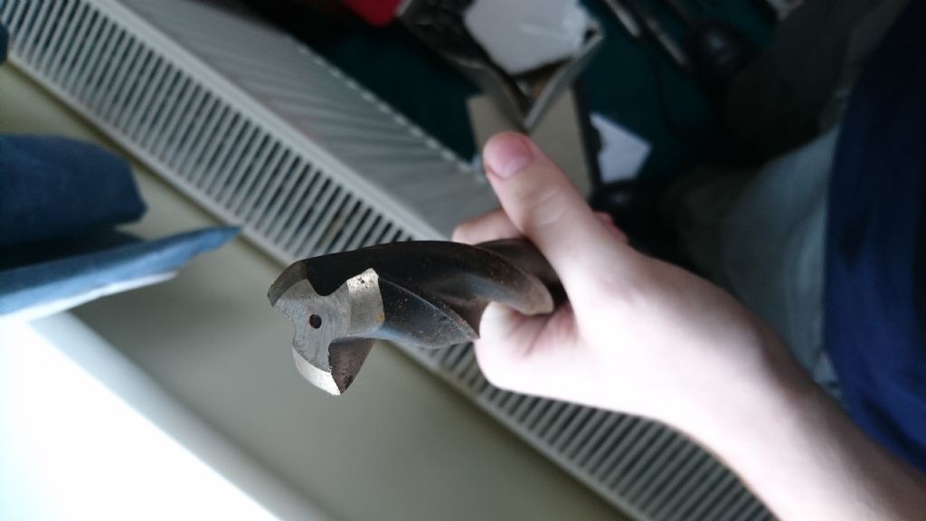

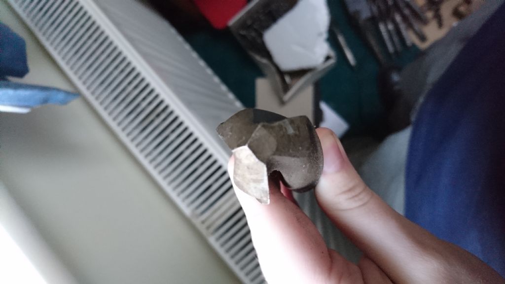

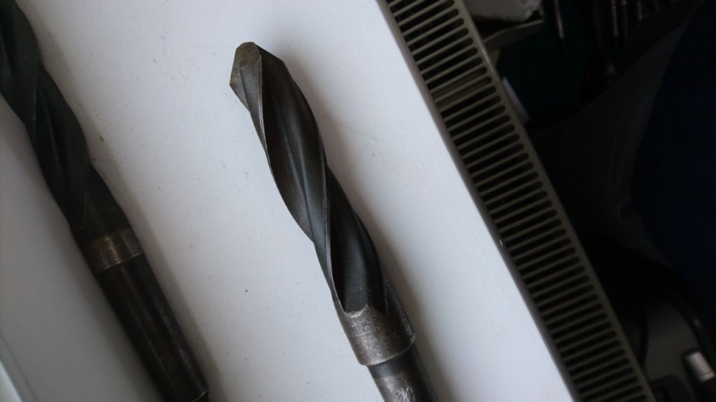

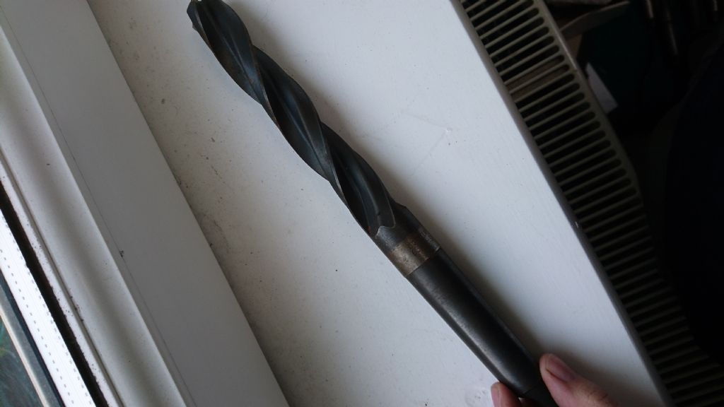

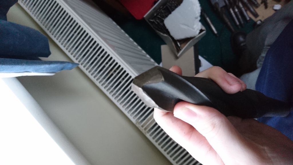

      Got a big ole bunch o big drills. Going to move the MT3 ones on since my machines are MT2. Found two odd ones in the batch though. Anyone know what they might be for?
      1 5/32" dormer
      63/64" dormer

            i think they are core drills for drilling castings
            #322521
            Clive Foster
              @clivefoster55965
              Three flute drills are said to be better at opening out holes than two flute. Especially cored ones in castings which are pretty much inevitably less than accurate unless high end pressure techniques are used. Probably a stability issue.

                Core drills need a pilot hole but are otherwise excellent. I think they come in four flute style as well.

                      core drill to drill cast holes to true up used them on cnc mill back in the 80s on precision barometers when I worked

                        Indeed this is a core drill my friend, and they're quite unusual so i'd hold onto them, they are quite expensive and limited to purchase.
                        They are the tool for opening out holes already drilled, hence the blunted end. The idea is that the hole ends up being less "triangular" than the variety twist drills often do and therefore more circular, the more flutes you've got the better it gets, (not sure how much better).

                            Two flute drills have a tendency to cut a tri-lobal hole, three flute drills don't have the same tendency.

                                      Have used 3 flute carbide in the past – they produce straight holes to reamer limits.

                                          I have a number of 3 and 4 flute core drills. I sharpen on the same equipment I use for 2 flute drills. In a pinch, they can be sharpened by hand. The clearance angle would be the same as on a 2 flute drill.

                                            Core drills great for opening out holes to then bore out. They don't grap and turn funny shaped lobed holes. Well worth having.
