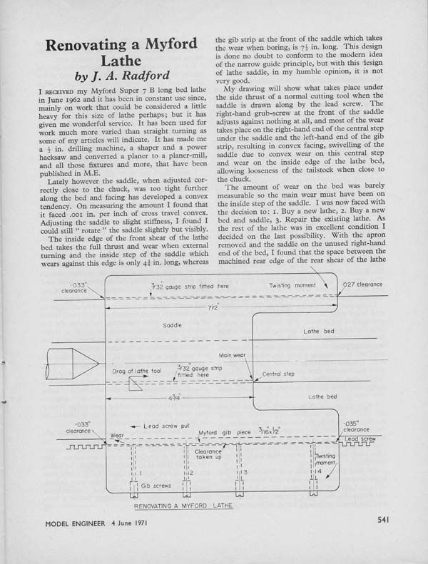

                      J A Radford was correcting wear in his lathe and wanted to utilise the un-used rear vertical shear. An argument against using only the front shears is that this is shared with the tailstock and therefore it is prone to more wear. The argument for the narrow guide is that for the same amount of play you get less rotation of the saddle than you would with a wide guide (I think!). By having both shears and the leadscrew all grouped close together there is less freedom of movement. I don't know why Myford changed though – was it just the wear issue?

                          I'm sure Radford wrote he couldn't understand why Myford didn't use the rear shear, I think it may have been his experience that caused them to change, for better or worse.

                                                  From Tony's site:
                                                  "One unusual aspect of the lathe's design (shared with the ML7) was the arrangement of the saddle; although this had equal-length wings at front and back, at the front (where the thrust was taken out on the inside vertical way) only half the length bore against the bed.
                                                  However, from August 1972 and Serial No. SK 108891B, the thrust was changed to bear against the full length of the saddle at the rear – the alteration being brought about by correspondence with an Australian engineer who had conducted the necessary practical experiments. This change also helped to ensure the success of the power cross-feed mechanism introduced in March 1974, from Serial No. SK 115830"
                                                  Presumably Tony meant NZ rather than Oz.. Because the inner side of the front saddle bearing is short to allow the tailstock to get closer to the chuck, the "narrow guide" does not have a particularly high aspect ratio so it is arguable that it is not a narrow guide at all. I'll see if I can find the Tubal Cain comment.
                                                  Here's the Radford article (page 2 is how he actually did the mod)
                                                  All very interesting, in theory at any rate. My S7 is one of the last "narrow guides" but I'm not sure I'm that bothered indecision.
