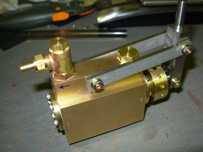

        Has anyone on here ever made there hand water pump for filling the boiler,and yes l know before l am told you can buy a casting kit ,but has any body made one from bar stock or plumbing bits ,there is a couple on the net who have done it ,but there is no plans ,any help please ,would be nice to make my own .

          There have been several in ME over the years – one designed by LBSC springs to mind – if I remember correctly it is in the construction articles for Tich, and was completely fabricated – no castings.

              The ME Vertical Boiler series that has recently finished started off with a hand pump from issue 4580 onwards

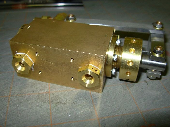

                The hand pump for a Super Simplex by Martin Evans is pretty nice. Here's the one I made for my loco. It would work fine for a stationary boiler as well. This was all made from bar stock. It moves a lot of water and is easy to pump even against 100 psi. The handle on this one is removable, it's a stainless steel tube about 8 inches long.dscn1592 - resized 4.jpg

                    Thanks John,
                    If you are interested in drawings for this pump I can probably help you out. Send me a PM if you are interested.
                    I changed which end the pump discharges from. I also made the intake holes in the bottom closer to the pump  body.  I also added a packing nut to the pump ram.  I usually use drawings like these as a point of departure and modify things as needed.
                    Here's a link to a few photos of the construction of this pump: https://supersimplex.yolasite.com/Emergency-Hand-Pump.php
