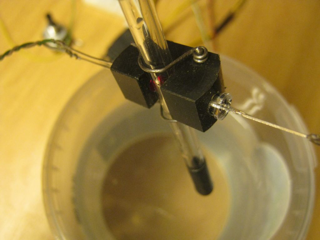

        Way back in 2016 there was some correspondence n the Model Boats forum about a water level sensor which clipped round the gauge glass. sensor
        I've tried pm'ing the author Jens Eirik Skogstad with no response, and tried (and failed) to post on the Model Boats forum. Does anyone have any info/experience? I'm not after probes which go into the boiler, I can sort that out for myself. I think Cheddar models used to supply similar, but I've looked at Clevedon (who took over from Cheddar) website and it isn't mentioned

          The circuit diagram and component list is there. It should be possible to build it from that info. I fancy it would be an interesting project and could be made fail safe with a servo gas valve. Noel

            I'm particularly interested in the sensor. Does it just shine a light straight through the glass tube, in which case why does having water in it make any difference. The industrial ones I've seen shine a narrow beam off centre through a much bigger gauge glass, and when there is water present it acts like a prism and deflects the beam. If this is how Mr Skogstad's sensor works having some more onfo could save me a lot of experimenting. I don't intend to use any of the circuitry, a processor will be much easier.
            #531309
              I suspect that the water filled tube acts as a cylindrical lens [rod lens] and spreads the light from the LED into a fan-like line.

                Not all ‘transparent’ materials are actually transparent to other frequencies of electromagnetic waves. IR is absorbed/attenuated by water.
                Perhaps think here of microwaves, which are readily absorbed by water in the food/drink..

                            As far as I can determine, short wavelength IR (800 to 2000nM) passes through glass, longer doesn’t.
                            However, according to Wikepdia, in this range, water has a low attenuation coefficient, with a minimum at 940nM, which is a popular value for IR LEDs
                            Attenuation coefficient – Wikipedia
                            Electromagnetic absorption by water – Wikipedia
                            which means that IR can get through that as well. Absorbtion coeff of water vapour seems to be very frequency dependant.
                            I suspect I’m going to use a probe and continuity, a lot easier, and as long as I make the probe AC relative to the shell I gather that deposits won’t be a problem.

                                      Unless I have the wrong end of the stick, Duncan is looking for a system that can measure the level of water in the boiler. I single sensor can be made to detect the presence of water at a particular level in the tube but I would think several sensors would be needed at different heights if this system is going to control a water valve or whatever.
                                      Noel S mentioned 'servo' in his reply, that might need some type of analogue sensing rather than just one 'above' and one 'below' sensors. I can see quite a bit of development being needed before one could be confident that the water meniscus was actually between the two sensors and not below the bottom one (or above both). That bit might be trickier than the optics.

                                        The video demonstrates a ‘radio control’ type of servo being driven by the circuit.
                                        If my understanding is correct, then the sensor is detecting the presence or absence of water at one particular location in the tube … which is not quite the same as sensing the position of the meniscus.
                                        P.S. __ Here is the, very brief, datasheet for the ‘Kingbright photo-transistor:

                                          Duncan, are you wishing to know if there is water in the gauge glass tube, or do you want to know the level of the water in the tube?

                                              I just want to know if the water is above a set height in the glass. The sensor in the Model Boats article has a LED and a phototransistor. It looks like a simple red LED, see photo below. This is positioned around the gauge glass, and detects water level on a simple on/off basis. It uses lots of components which can all be replaced by a processor (I think), but I'm trying to understand how the sensor works. As the original electronics has adjustment for 'photo sensitivity' I suspect the water attenuates the light and the signal is fed to a comparator, it would be a lot neater if the actual sensor was on/off, which can in principle be done by shining a thin beam offset through the glass, with water in you get much more deflection (refraction) but I've only seen this on much bigger glass tubes in industrial environment. I'm hoping to avoid having to miniaturise it myself (idle b*gger)
                                              Once I know that water had dropped I propose to turn on the pump, which will pump at a higher rate than the fire can evaporate the water, and if after a set time (short enough that the water can't get dangerously low if the pump doesn't work) the water level has not risen it will kill the gas.

                                                The amount of light that causes a trigger can be set, so that it is the change of light intensity that will change and activate a servo or relay. A capacitive circuit could be used, the presance of water would alter the tuned circuit and open or close the bypass valve. Noel
                                                #531524
                                                  I’m prepared to be proved wrong [please form an orderly queue] … but I believe I gave you the answer, Duncan
