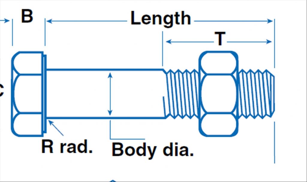

        Morning All
        I have justed watched a YouTube video the guy was making some dome headed hex screws and he made what he referred to as a 'washer undercut' under the head the purpose was to stop the head from damaging the paint work when tightened. I couldn't see very clearly what he had done and as I am making some hex head fasteners wondered if anyone could explain the technic

          I assume he means turning the underside of the head down to the across flats dimension for a few thou so that it doesn't mark the paintwork as it is tightened.  As far as the paint is concerned it is then a cheese-head screw.  I keep putting off doing this to the screws on a 16mm loco but it is much tidier than washers.

            I understand undercut to mean traversing a cutting tool with a clearance angle deeper into the work so avoiding the fillet left by the tool interfering with the screw seating when tightened.
            The depth of the undercut needs to be at least as much as the tool tip radius.
            Agree with Brian the method to help avoid damaging paintwork.

              Is this the bolt head feature which you are refering to ?
              It is used on high tensile bolts.

                I've always known this feature to be a 'washer face. Is this a term that is common/uncommon as I have used it on occasions and other people have looked at me as if I'm from another planet?

                  'Washer face' is the term I've always used and it's called that in the fasteners section of my 'British Standard Handbook No 18'.

                      I don't know why you wouldn't use the same 30 deg. chamfer down to AF diameter that's on both sides of a standard nut. The paint would be affected in almost the same way – if anything with less damage, due to the absence of a right-angled edge.

                        They do make 'washer faced' nuts as well. chamfer one side and washer face the other.

                                    Thanks for all the comments I did have in mind it would be as Paul's drawing but like Vic I have never seen one
