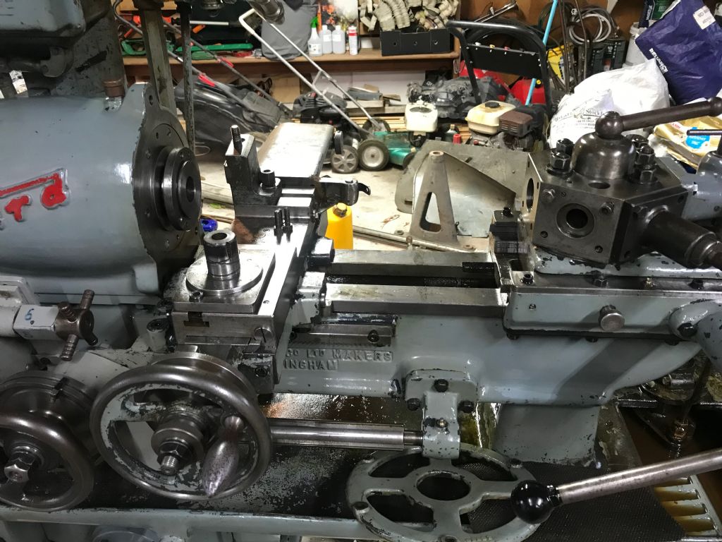

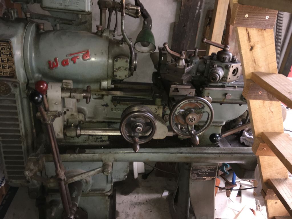

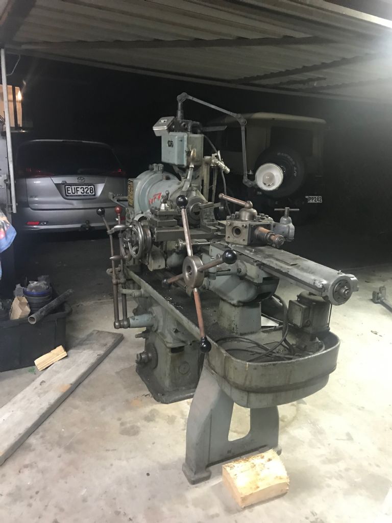

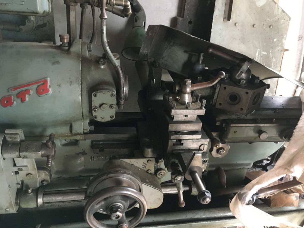

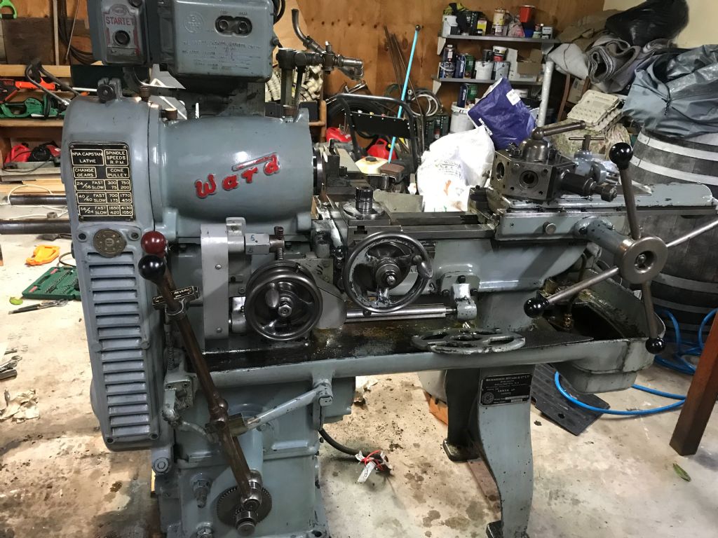

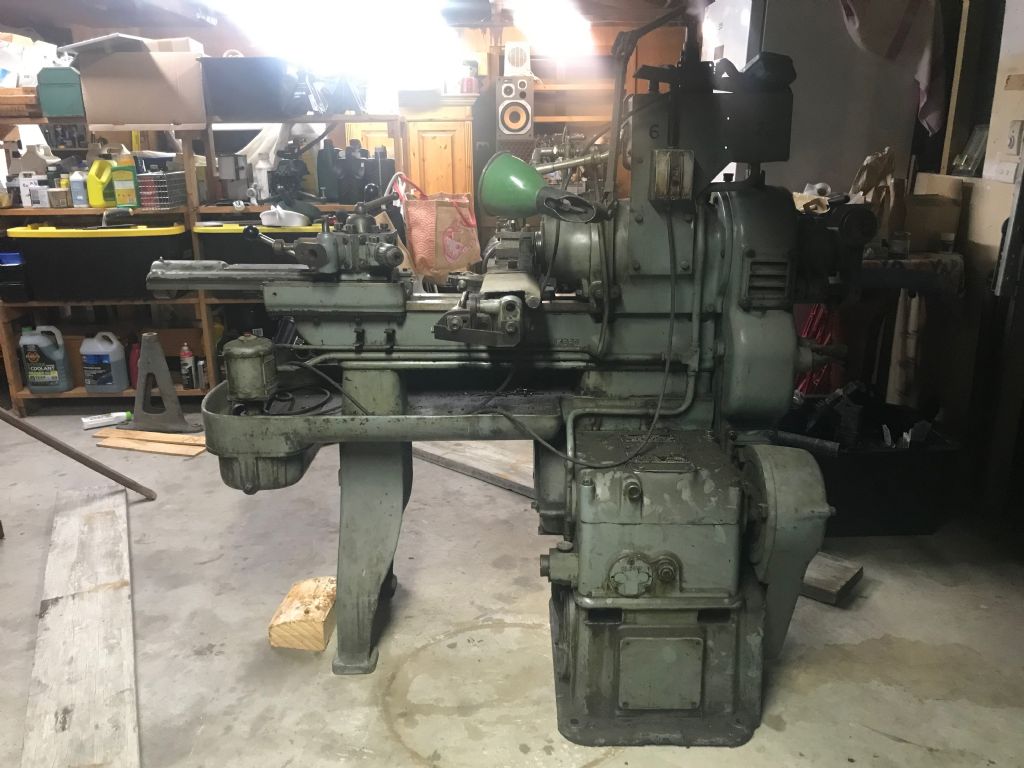

      Hi everyone, Im new here. Yet to start doing any model engineering, although I am doing a maintenance engineering apprenticeship here in New Zealand.
      I recently came into a Ward No1A lathe in very good condition, looks like its hardly been used. Im currently setting it up and swapping out the motor for a single phase one, but I also want to change the oil in the gearbox. It says to use an acid free mineral oil of medium fluidity. So far Im leaning towards an ISO 46 or ISO 68 hydraulic oil but does anyone here have any better suggestions?
      Also any further information on these lathes, things to look out for, tips and tricks, manuals etc would be greatly appreciated
      Cheers
      Thomas

              ISO42 or 68 is pretty standard and shoud be OK.
              Have you considered a VFD rather than single phase motor?
              Robert.

                Many years back we used a straight mineral oil for all machine gearboxes including 1, 2, 3 and 7A Ward capstans probably an SAE 40 oil, it all came from a 1000 gallon tank with a label on it saying General Lubricating Oil.
                Nice to work on, well nicer than Herbert capstans, that's only my opinion. most had War Finish tags on them, they were still running when new company management decided to shut the machine shop and contract it all out that was 1990ish.
                Colin

                  Cheers guys,
                  I had thought about a VFD, that was going to be my first option until I found that the motor could only be run on 400 – 440V, our standard domestic supply is 230-240V so that was no longer an option. A single phase 3hp motor will be fine and easy enough to get here.
                  Theres no war tags on my lathe, looks to have been purchased new here in NZ and forgotten about. Looks to have barely been used. The previous owner bought it off an old engineering firm that was shutting down in the 1990s, and he barely used it at all. Once I get a 3 and a 4 jaw chuck for it Ill be away. Will make a morse taper tool holder for the turret, will bore it with the tools in the chuck so that it is concentric to the spindle bore. Ill upload some pics once I convert them to JPEG

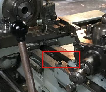

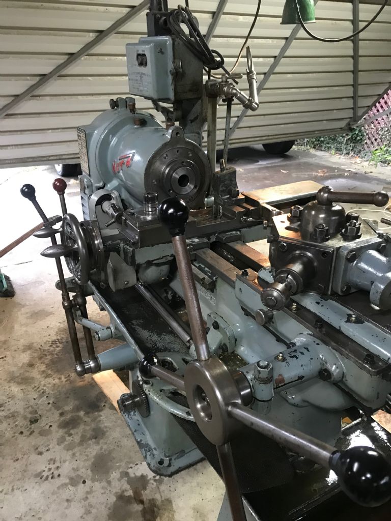

                              It's a capstan lathe, ideal for certain types of repetition work, where up to six different cutting operations are performed in sequence by rotating the capstan. They're really for churning out multiple copies of the same part in a jiffy, but can be used conventionally too.
                              Things to watch out for: these are production machines, likely to have been worked hard. Bed wear is to be expected, because most saddle movement occurs near the chuck, where it develops a trench that eventually upsets accuracy. The saddle grinds out a sloping cavity in the bed, and sinking into it alters the cutter height.
                              There's a suggestion of bed wear in the photo, might just be grubby:
                              How much bed wear matters depends on what the lathe is used for. In a production setting, the lathe would be taken out of service as soon as it failed to meet tolerances (which could be slack or tight). Depending on the economics, the bed might have been reground (only possible a few times), the machine moved to less demanding work, or scrapped.
                              In their day capstan lathes were usually worked to death, but CNC changed the rules of the game. CNC meant that many manual lathes and mills were either sold in good nick, or became second-fiddle for short simple production runs were setting up CNC wasn't worth the effort. So used much less heavily than in the past. As time passed, setting up CNC got slicker and quicker, making it ever less likely that a capstan lathe would be thrashed. Eventually the shop might decide they needed the space more than the machine, and a capstan lathe in good order would become available for far less than it cost new. The condition of a second-hand machine depends on its history.
                              The amount of wear can be gauged with a straight edge, but I think using the lathe to cut metal is a better test. A manual operator can often adapt to the shortcomings of a badly worn machine and still do good work. Slight or moderate wear may not matter at all because home-workshops rarely work to tolerances.

                                  I got very lucky with this one, theres next to no wear in the bed. What you see in the photo is just oil. Theres no tight spots, backlash is next to non existent. There is even a good deal of the original paint left in the swarf tray! I would guess that it spent most of its life in the back corner of a workshop gathering dust instead of being used and abused
