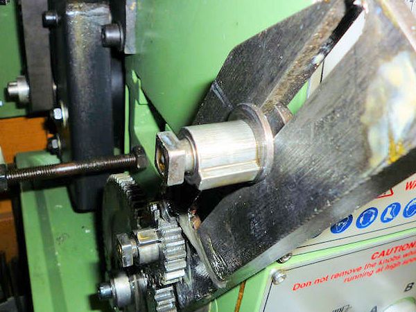

                                    I set mine with paper as above and use the washers supplied on the gear stub shafts to make sure the gear faces don’t scuff. I get a little mild whine and chitchat from the gears, but it sounds healthy and benign to me.

                                        I set mine with paper as above and use the washers supplied on the gear stub shafts to make sure the gear faces don't scuff. I get a little mild whine and chitchat from the gears, but it sounds healthy and benign to me.
                                        Do you mean putting the washer on the gear axles, where the lube nipples / horseshoe is?

                                          Ross, you should have something like:-
                                          Starting from the right there is a T-nut that slides in the banjo, a washer / spacer (these can be different thicknesses), the collar with key that the change gears fit on. All this is on the square headed stud that screws into the T-nut. The groove at the left hand end of the stud takes the C-clip that holds everyrhing in place. It can also be helpful to put a thin paper or plastic washer between pairs of gears on the same stud to improve lateral spacing (stops the gears rubbing). There are also some spacers for when there is only one gear on a stud (shown H on the screw-cutting chart)
                                          As George kindly suggested a look at my website here is a link to Journeyman's Workshop a blatent plug but you may find something of interest, my lathe is a lot older than yours!

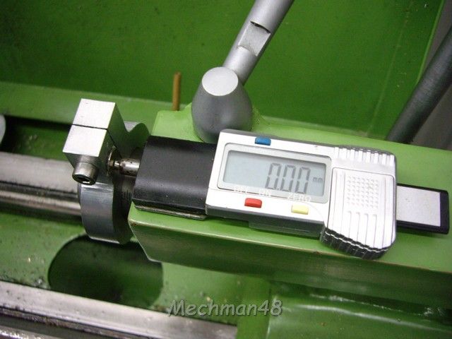

                                                Re. dro's… I use a couple of digi tyre depth gauges on my lathe, one on the tail stock & one on the cross slide both fixed by 5mm neodymium magnets glued on to the under side,& 3mm ones glued on to the end of the probes, small but very strong grip & both work spot on for me. If I'm not using the tailstock one I use that for the saddle longitudinal travel, never had an error, other than of my making…
                                                Tail stock dro…
                                                Cross slide dro…
                                                George.

                                                  Thanks George! Whats the maximum travel those things can read?
                                                  Cheers
                                                  Ross

                                                    ​I've taken the stops off the slides end & I can get up to 37mm travel which is fine for the final finishing to length / up to shoulder / final dia. I did make one out of a 150mm digi vernier & that worked ok but wasn't happy with the faff on locking it every time but could get 135 mm reading with that…
                                                    George.
