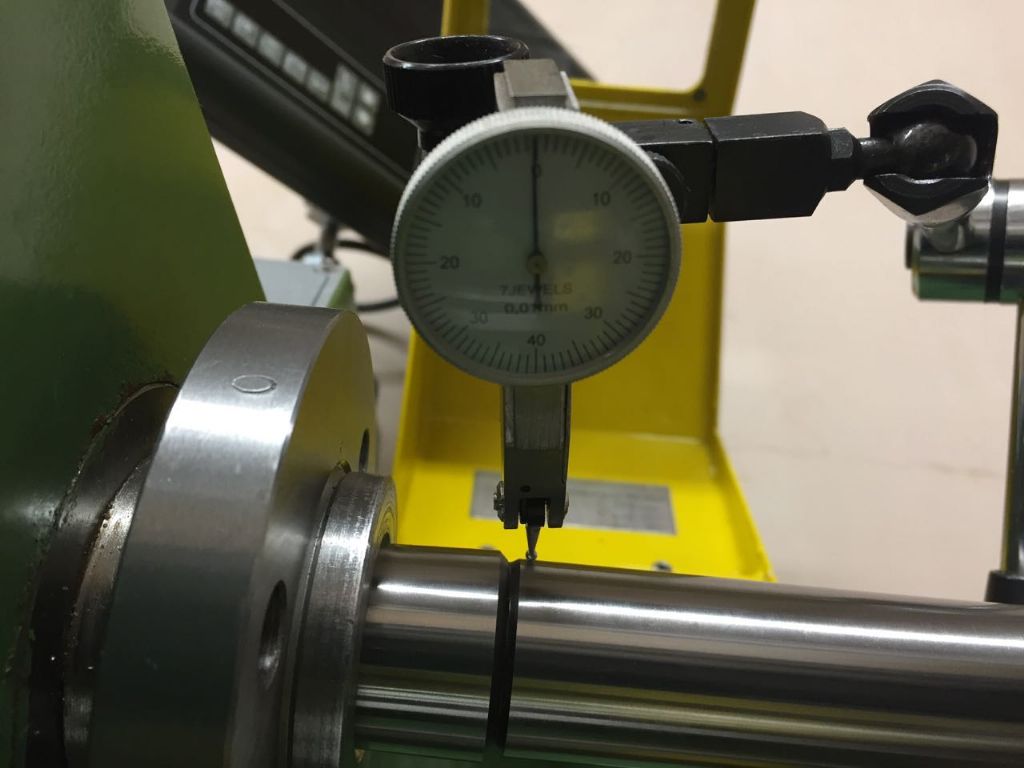

        Following on from my previous thread about strip down for cleaning, I have made good progress with the setup of the new lathe. Whilst still on the pallet i fitted the Z axis DRO at the back of the bed below the saddle and assembled the stand that I bought with the lathe. With help from my son, the lathe was lifted onto the stand and bolted down, and I could get on with fitting the X and Z1 scales on the DRO system.
        I then spent a good few hours just turning different materials and getting a feel for what to me is a much bigger machine. Feeling confident, I decided to turn the 11mm shaft for my Hemingway power hacksaw build, which uses ½ inch round bar as the starting point. I had a live centre in the tailstock as the shaft is 5⅛ inches long and I thought it was going well until I measured the diameter at each end. I had 10.98mm near the headstock and 11.24mm at the tailstock end!

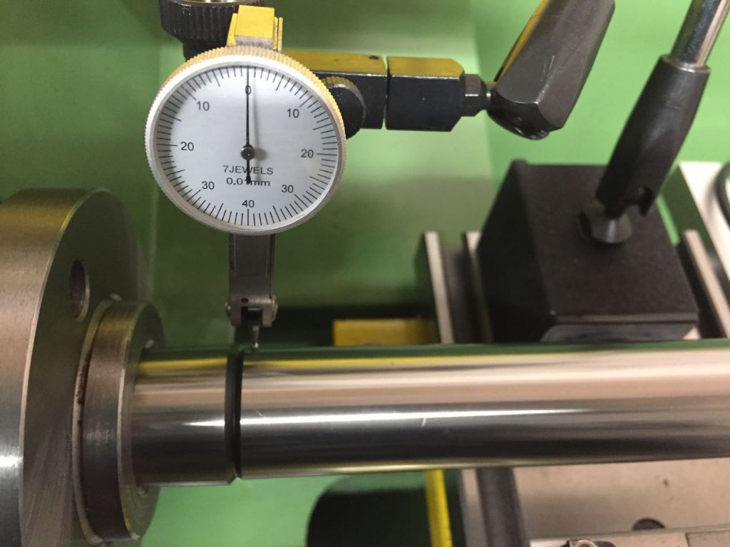

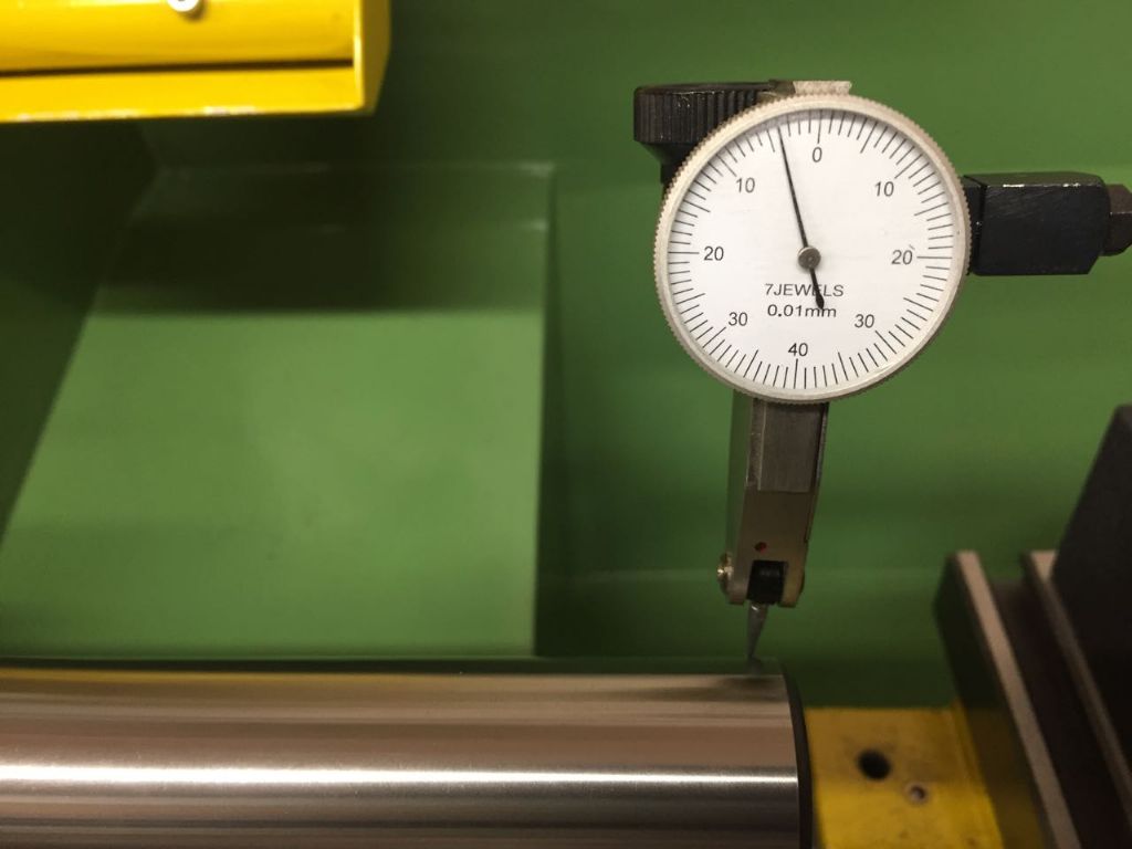

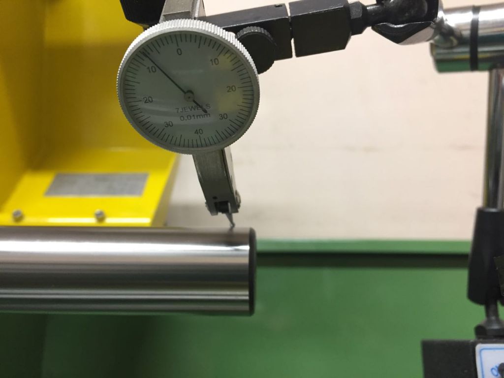

        Today, I set about taking some measurements using the ground test bar that I bought from Warco with the lathe. I set a lever dial indicator up on the cross slide and measured near the headstock and at the end in both lateral and vertical planes:-
        Zeroed at the headstock for lateral deflection
        Lateral deflection 0.04mm
        Zeroed at the headstock for vertical deflection
        Vertical deflection at end 0.07mm

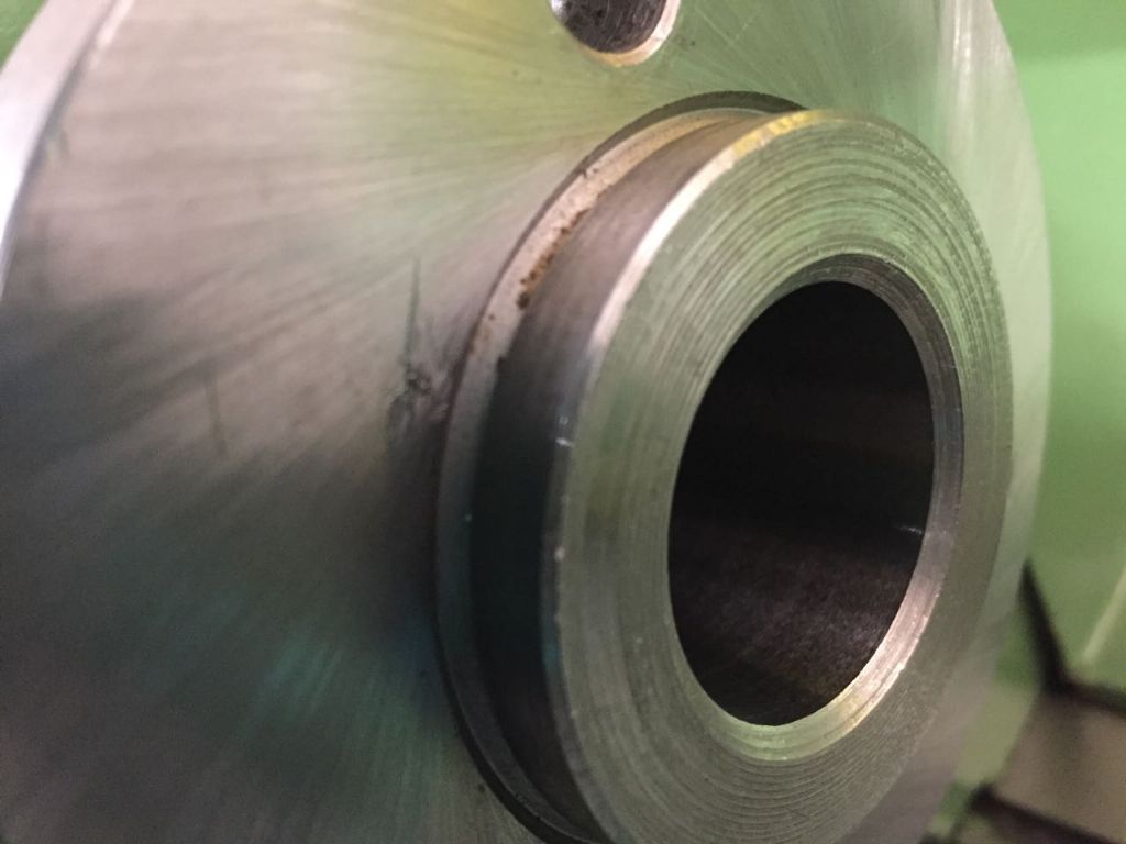

        Whilst I was doing these measurements, I noticed that there was a blemish on the spindle face, almost like a small weld spatter that was securely attached and needed removing with a riffler file and some emery. This must have been affecting the alignment of the chuck:-

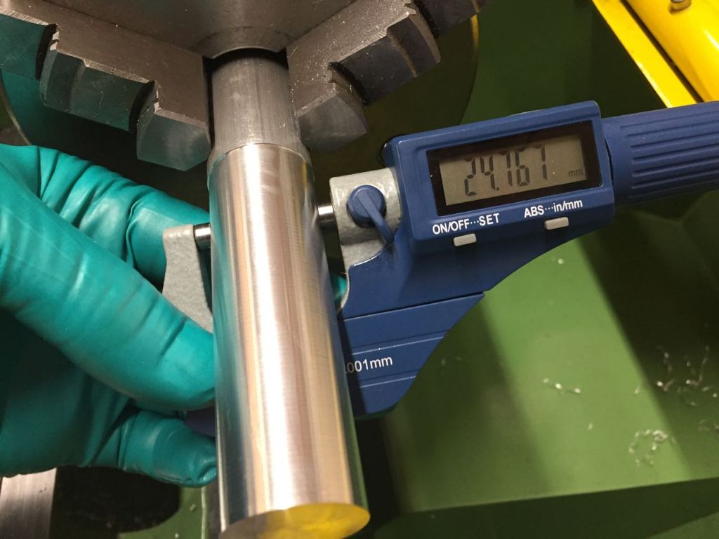

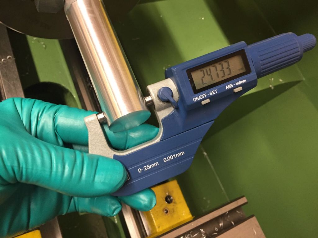

        Finally, I did a test turn as recommended in other threads on this site. I didn't have a piece of steel 25mm round bar so used aluminium.
        Chuck end diameter
        Far end diameter
        So the difference between the two measurements is 0.034mm.
        I realise that I need to shim the bed to try and reduce the variation, but am unsure how to do this on the WM250, as unlike an ML7, the bed has one bolt at the tailstock end and two bolts on the long centreline of the bed under the headstock. Any help/ advice would be welcome.

              The "Twist the bed until it turns parallel" school of thought originated in parts of Nottingham. But it is poor way of making up for a lightweight flexible bed.
              However, better quality lathes should have sufficient stiffness in their own bed. The instructions for my Kerry say to undo the bed holding down bolts to finger tight only, and it is supported on wooden shims to let the bed find it's own level. Clearly the orientals think the same way if it your lathe has a 3 point mounting.
              That being so, you need to contact your supplier and send the photos you have posted here. If anyone has an older lathe with similar problems, you may well find an adjuster under the headstock which will allow the headstock to be rotated on the bed by a tiny amount. (The Kerry has such a device). Use with care, because you also need the lathe to face off very slightly concave (about 0.001 in 10" diameter or so).

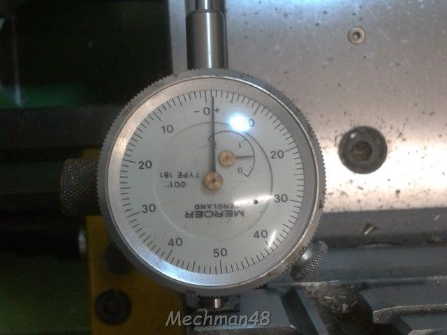

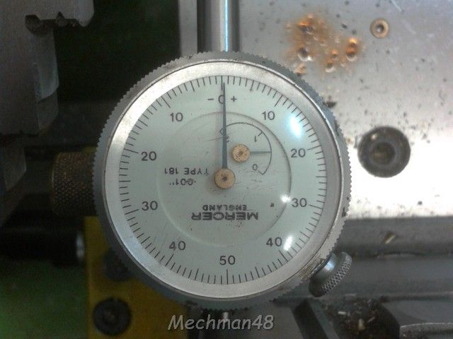

                    mechman48
                      @mechman48
                      I had similar probs with mine initially, chuck run out was unacceptable, I checked the spindle nose & nothing untoward until I checked the chuck back plate… found a burr the was throwing it out of true, stoned this off & all was well, did a tailstock alignment check, some minor adjustment required. Machined a test piece & mic'd headstock & tail stock ends, within .0045" of ea. other, less than 1/2 thou"… good enough for me.
                      Burr on back plate…
                      Chuck run out before finding burr… .0015"
                      ​After burr removal… .0005"
                      ​ Test piece after minor tailstock adjustment… .00045"… 1/2" thou over 6 " is good enough for me…
                      Must do another check this year see if anything has moved ?
                      George.

                        @howardlewis46836
                        No lathe with twist in the bed will turn parallel.
                        Without using the tailstock, clock the Alignment Bar, (preferably using the Morse Taper, if it has one) at each end of the bed and adjust the feet of the lathe, (Adjust with nuts or shims) until you are happy with the results.
                        THEN, you put the Alignment Bar between centres (trim them up before use!) and check to bring the Tailstock centre into line with the Headstock centre.
                        Then you can check that the Headstock and Tailstock centres are in vertical alignment.(DTI or trap a 6" rule, Razor blade between the centres; it should be vertical)
                        When all is acceptable, you should then be able turn parallel.
