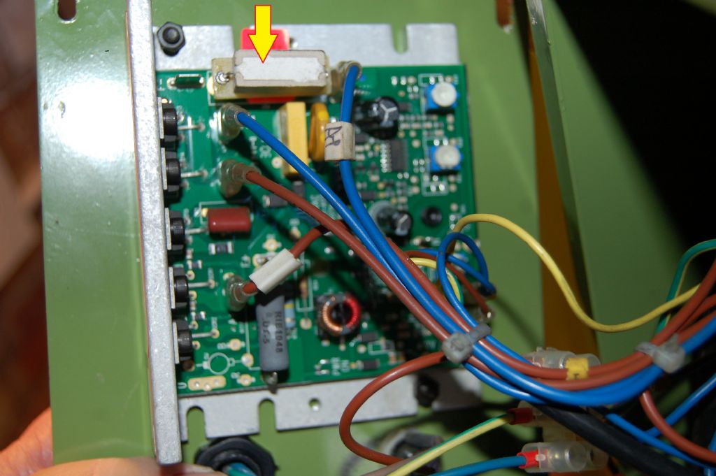

                                    SteveW
                                      @stevew54046
                                      Check out earlier threads. When mine died it was just this resistor. Not pressed fully home. I checked motor with 12v charger.board.jpg

                                      Dusty
                                        @dusty
                                        Well some sort of success it appears the speed control is working O.K. I got the result that John described, the only thing was the NVR needed holding in and started buzzing whilst doing the test.
