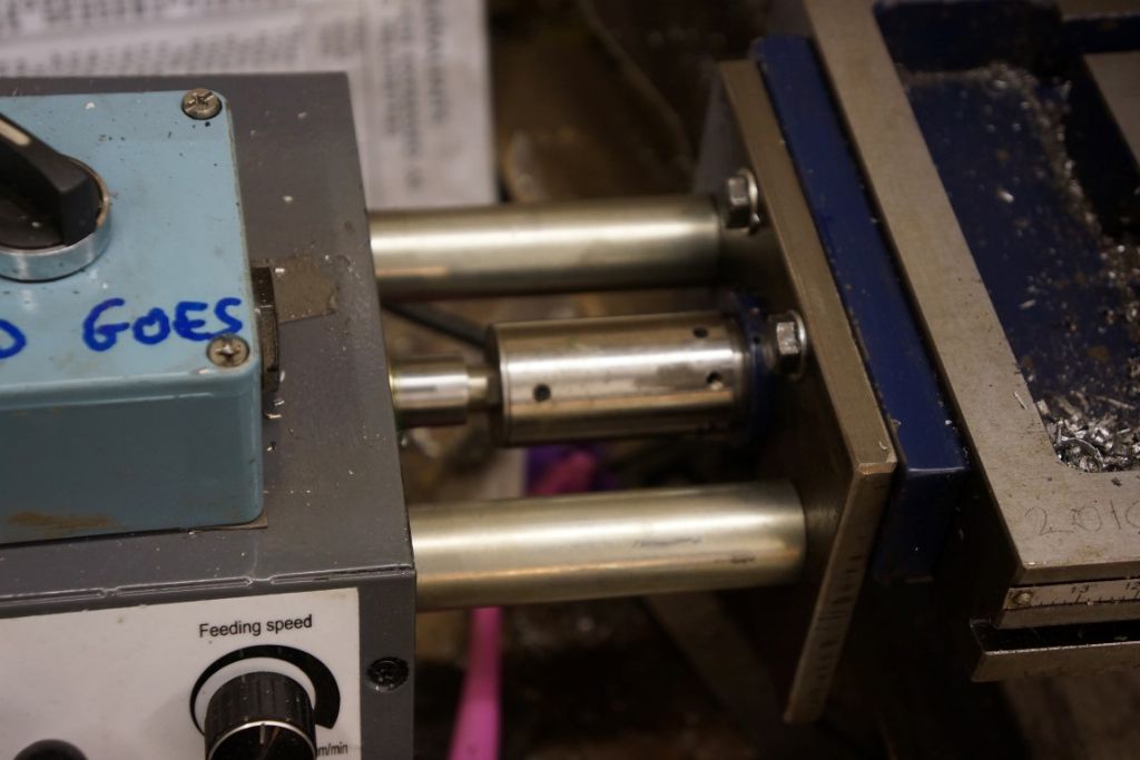

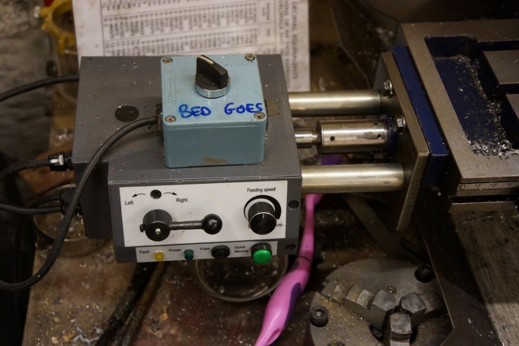

          dsc01369 (medium).jpgI fitted a axminster seig power drive that was on offer for about £200 IIRC
          some photos here
          simple fix
          The part on the coupling between drive and bed is a quick release for if i wanted to use the manual handle in actual fact it overruns easily so I neednt have bothered
          I've had it fitted 3 years of so and it works fine
          I fitted the switch box on top so the feeding speed stays put as original switch was on the back of the pot so you had to start it from zero every time
          the "bed goes" is just a memory jogger

              mines a RDG version of the wm18 (weiss mill)
              Axi now want 299 for the powerfeed but I still think thats worthwhile as its almost plug and play
              Just the plate some spacers bolts and a coupling
              the coupling screws onto where the handwheel was…. then locked by a grubscrew this sets the end float on the shaft
              Remember to remove the handle off the opposite end ( out of balance when feed is going fast !!! ) leave the wheel though
              In operation I use the switch on top to start and stop the motion rather than as standard the sitch on the speed control pot….just remove wires from switch and bring them out to new switch on top….you can also jog by moving switch not all the way.
              at the end of the pas you have to switch off move the handle to opposite sense ( left right) then switch back on
              just moving the handle to opposite causes an error
              the limit switches would fit easily with the seig brackets but I dont use them as i dont leave the mill going by itself
