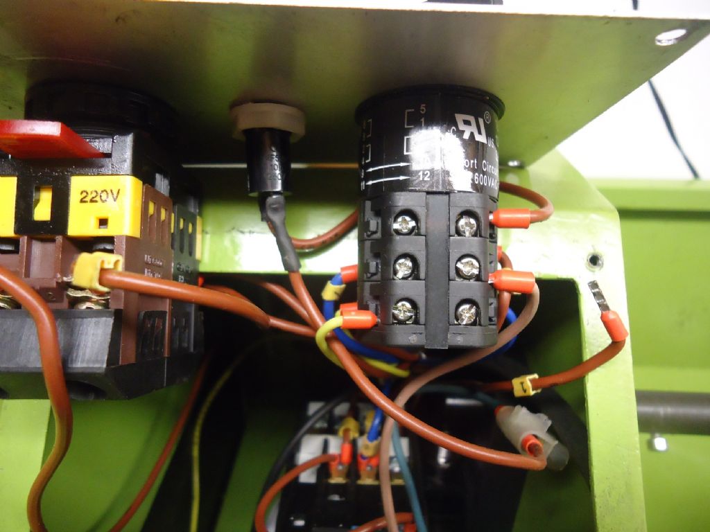

                                  My WM250 VF lathe has always had a problem with the on/off switch pop popping until eventually it gets going and until now I have put up with it. However, having moved into the new workshop the lathes power now comes from a different consumer unit located in the new place and they don't like each other.
                                  The lathe is now unusable as every time I press the ON button it trips the breaker. So today I removed the four screws holding the front switch panel in place and squirted some contact cleaner where I thought it would do its best, worked the switch on and of a dozen times or so and replaced the panel.
                                  Turned power back on and hit the ON button – 'nuffing! Machine would not power up. Removed panel again and could see that a brown (live) wire had come adrift but from where?
                                  Maybe the switch cleaner has done its work and maybe it hasn't but until I know where that wire should go I'll not know. The only clue is that one of the empty terminal clamping screws on the forward/reverse knob is loose but without knowing for sure I am reluctant to avoid total meltdown in case I get it wrong.
                                  I know there is a circuit diagram on the rear of the headstock which I took a photo of when the lathe was being relocated but it is so blurred as to be unreadable. I am able – with difficulty – to move the lathe for another pic of the circuit diagram but there is a lot of weight involved and spinal surgery with a further slipped disc since is not exactly the incentive I need. Anyway, I am not a genius in the "sparks" department so maybe even a clearer schematic would have been wasted on me.
                                  All in all I think it has to be a replacement switch but I STILL need to know where the loose wire goes.
                                  Pulling the panel out it looks like this from above:
                                  From underneath it looks like this: (note the rogue loose wire).
                                  Any help would be much appreciated.
                                  Rik

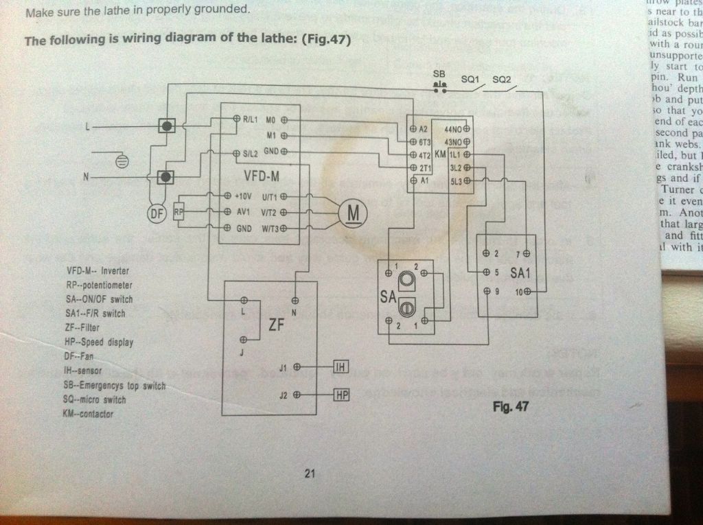

                                      Rik was there no circuit diagram in the manual? there is for my 280.
                                      #183337
                                      Rik Shaw
                                        @rikshaw
                                        Thanks Jason – of course there is a schematic in my manual. Sometimes the obvious is not so obvious. Age perhaps?
                                        Rik
                                        #183338
                                        GarryC
                                          @garryc
                                          Rik
                                          In case this helps – its for the 'new' WM250V inverter drive model..
                                          Regards
                                          Allan.
                                          #183340
                                          Rik Shaw
                                            @rikshaw
                                            Thanks Allan – I'll file that under future/maybe!
                                            Rik

                                                  Having in the last few weeks taken delivery of my repaired lathe from WARCO who had fitted a replacement speed control board I was looking forward this afternoon to running it up and doing a little work.
                                                  All went well for about twenty minutes albeit with the start button making its usual stuttering and false starts. No worries though as long as the thing worked – and then – I pressed the start button and the breaker tripped on the consumer unit in the workshop. Oh no, not again pleeease!
                                                  Tried starting again six times and each try the breaker tripped. By now I was beginning to feel slightly sick that my very expensive repair was for nothing.
                                                  Next thing I tried was to plug lathe into the house circuit and tried again. Press start button, chuck revolves briefly then lathe dies. What the four and a half is going on I thought.
                                                  Decided to check front panel fuse, it had blown. Replaced it and tried again. Same thing, another blown fuse and once again for luck, another blown fuse.
                                                  Replaced fuse, disconnected lathe from house circuit and plugged it back into workshop circuit. Pressed start button and the breaker tripped. Checked front fuse – it was still OK. Repeated several times with same result.
                                                  Apart from calling WARCO on Monday I am once again up a gum tree with a duff lathe again.
                                                  With the WM250 V-F out of its twelve month warranty but still under two years old from new I am reluctant to spend yet another £277 (or maybe more) on another repair which may or may not work.
                                                  Anyone want to buy a s/crap lathe?
                                                  Rik
