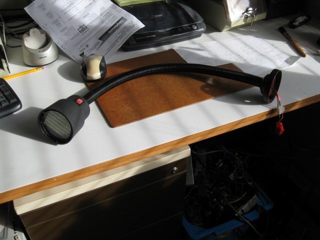

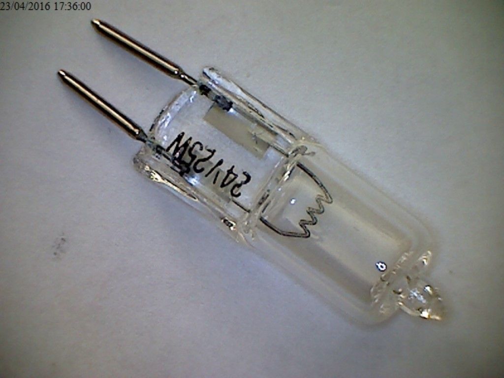

                  Hi Windy,
                  Does the lamp look like this ?
                  img_1307 (small).jpg If so it may be a 25 watt bulb. I have bought rwo of these lamps and both had 25 watt bulbs in them. This is what they look like.
                  Note the light fitting in the picture has an LED panel fitted at the moment to try out.
                  Edit.
                            I have just found this source for 24 V 50 W bulbs.
                  Les.
                  Edited By Les Jones 1 on 23/04/2016 18:07:47

                      Hi Rex,
                      The lamps in your link are 12 volt Windy needs the 24 volt version. When I bought the lamps shown in my last post the plan was to use 12 volt bulbs when the 24 volt ones failed as these can be obtained easily. (For example Screwfix, Toolstation and I think I have even seen them is some of the Pound shops.) 12 volt lighting transformers are also easy to obtain and relatively cheap. It may even be worth Windy changing over to 12 volts if there is room for the extra transformer in the control box on the milling machine.
