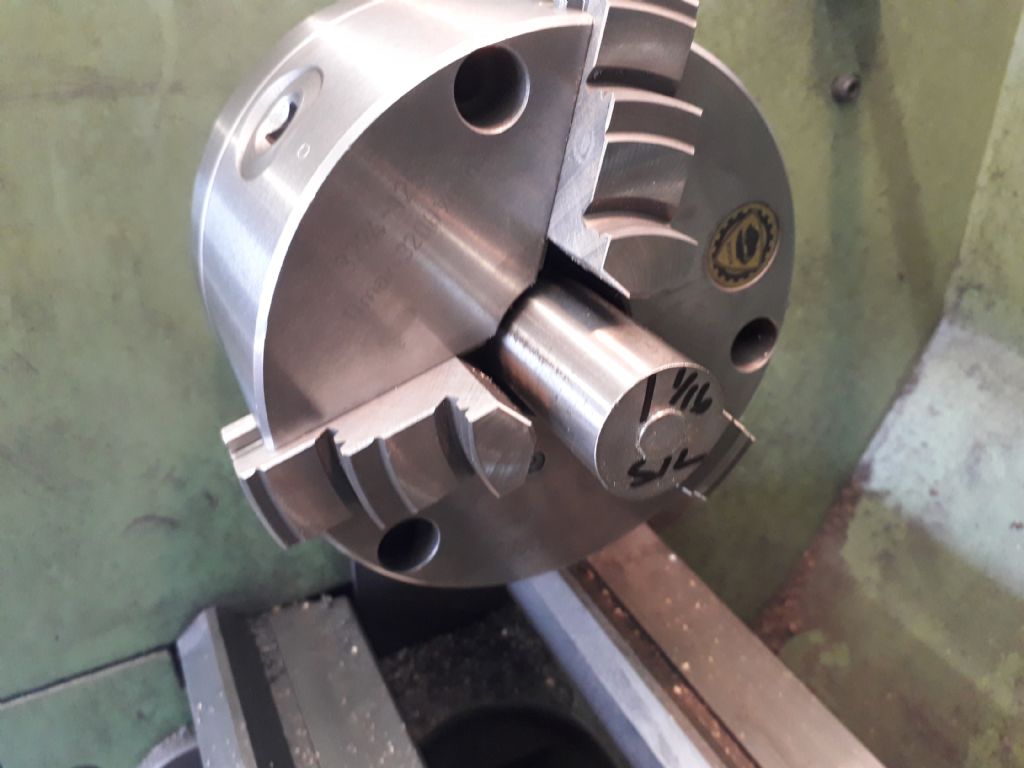

                          I suspect rik's will pass more. As I said the 280 is also sold as 26mm bore and the bore gauge up it earlier today shows 28mm at the narrowest part of the taper as I reported above.
                          This is almost a full length of 1.063" silver steel that goes in without a problem, could not quite get 1.125" in.
