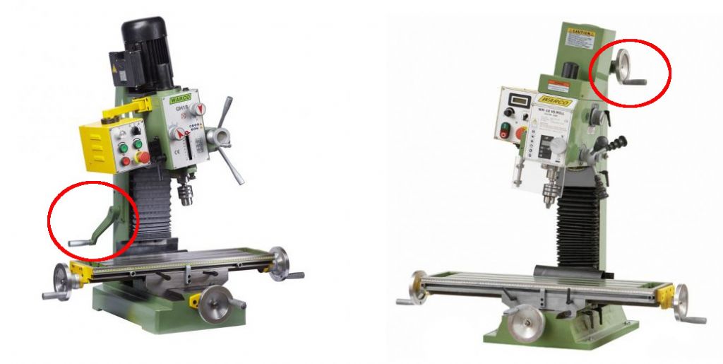

                  I have a WM18 and was interested to compare specifications with the GH18. The GH18 is slightly smaller which could be useful if space is short. Apart from the motor controller, WM18 definitely electronic, not sure about the GH18, the other difference is the position of the Z-axis lever, WM18 on the right:
                  I'm nearly 6' tall and find reaching the handle on the WM18 a bit of a stretch. It might be awkward for shorter persons. The GH18 has the handle much lower on the left, easier to reach but I wonder if the control box might get in the way in some positions?
                  I think the two machines are of similar capability. I don't worry about electronic vs plain motor control myself, but the position of the handles might help some buyers go for one rather than the other. If non-electronic is a requirement best to ask Warco, what's inside the GH18's electrical control box is a mystery to me!
