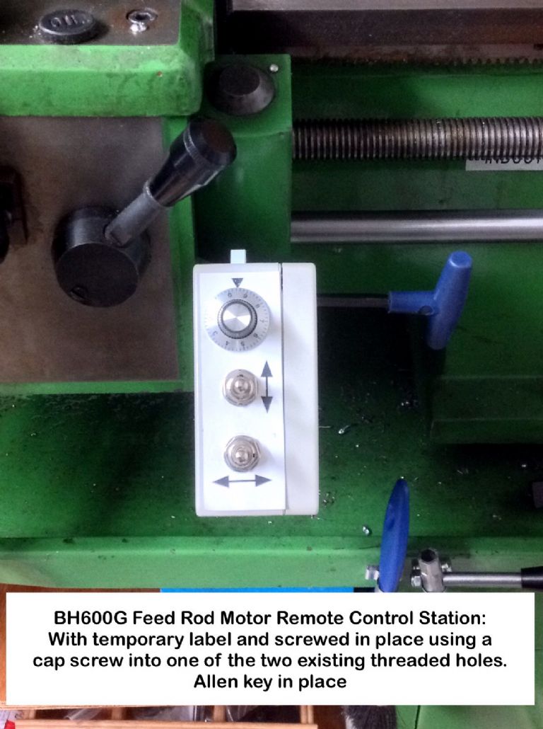

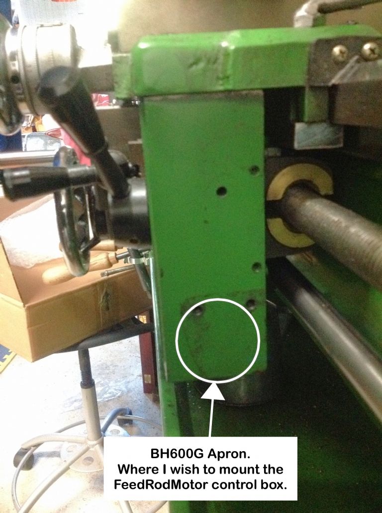

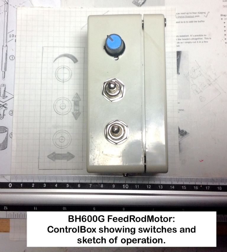

                                    #173505
                                    OuBallie
                                      @ouballie
                                      Four months side-tracked!
                                      Back on track at last, but need help please, this time for ideas on how to mount the remote control station to the side of the Apron, but able to be removed easily, so a slide-in housing of some sort.
                                      It's being mounted where the Spindle Direction lever was and no longer needed.
                                      Depth of Apron is 60mm.
                                      Apron:
                                      BH600G FeedRod Motor
                                      Remote Control Station side biew:
                                      Remote Control Station front showing controls and sketch of proposed decals:

                                      #173511
                                      Les Jones 1
                                        @lesjones1
                                        Hi Geoff,
                                        One suggestion. Make two keyhole slots in the back of the control box to match the existing threaded holes and make two shouldered screws to fit the existing holes.Also make a springy plate to go on the back of the box (Or fixed to the casting under the shouldered screws.) so the box had to be pressed against the casting to hook it on the keyhole slots. You could also counterbore the inside of the box at the top end of the slots so the box had to be pressed against the casting to remove it from the keyhole slots.
                                        Les.
                                        #173541
                                        Bazyle
                                          @bazyle
                                          How about any one of the mounts used for bicycle lights – there have been various, or sort of relevant to ME a loco lamp. Or a dovetail like a QCTP (also used on the CVA fro dial indicator mounting)
                                          Have you built in an auto stop feature/trip?

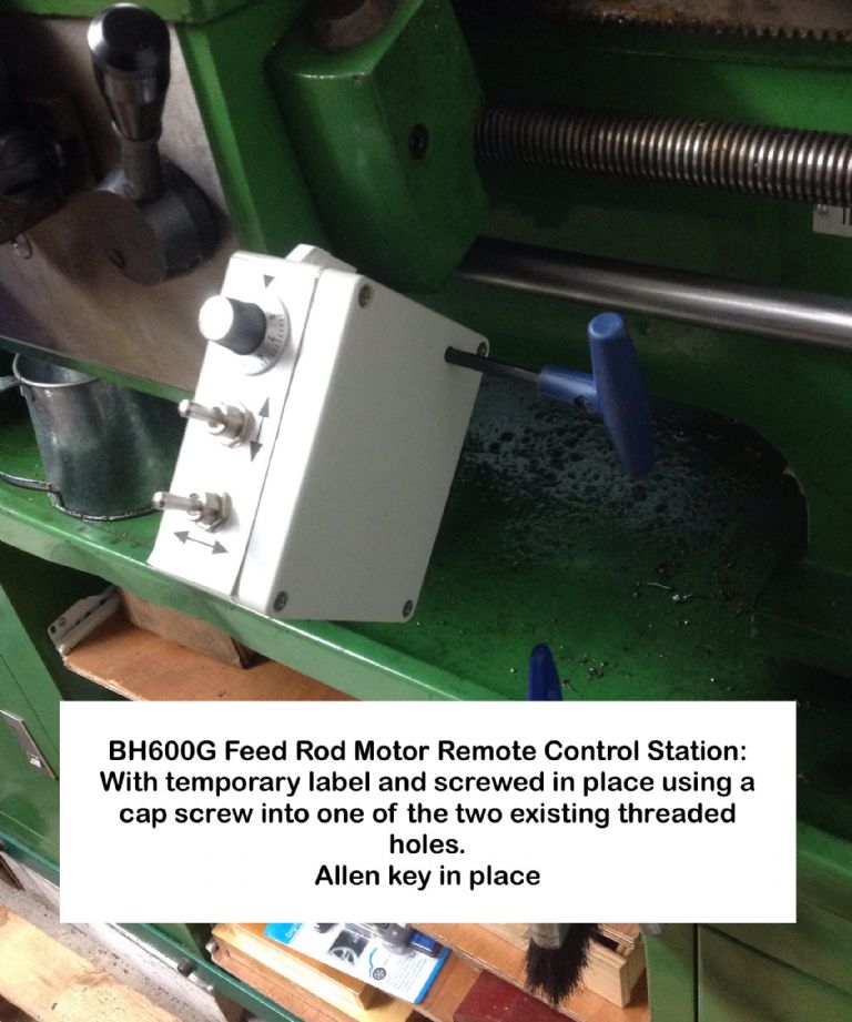

                                          OuBallie
                                            @ouballie
                                            Les & Bazyle,
                                            Thanks for the suggestions.
                                            Fitted the Threading Dial and that prevented the RH tapped hole from being used as it wouldn't allow the Remote Control Station (RCS) from being swivelled into a more useful position to operate the switches.
                                            I had already drilled one hole in the RCS some time ago, so just measured up and drilled a corresponding one in the cover in order to pass an Allen key through, and into the cap screw head.
                                            This works a treat, and can be tightened up so preventing the RCS from swivelling, now that only that one fastener is used.
                                            Used TouchDraw to do the label, emailed it to myself then printed it out at 30%.
                                            Just need to make a permanent label, with thanks to and as per 'mikesworkshop'.
