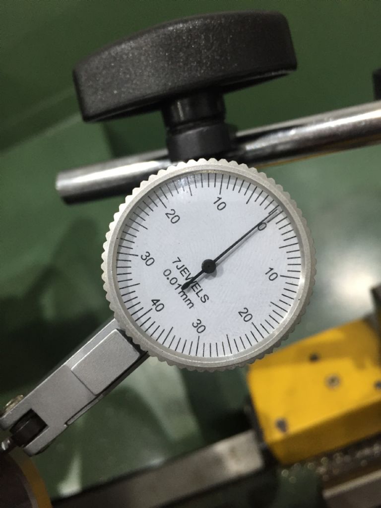

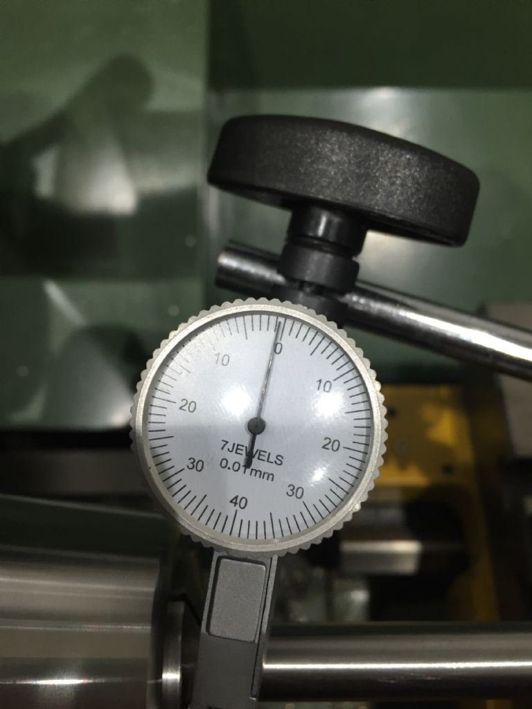

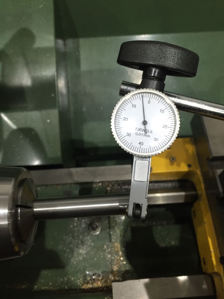

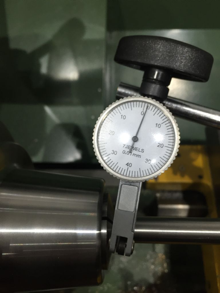

                            Hi J, Yeah the back plate is all in as it should be… initially i machined the back plate so it was a shrink fit but when i clocked it the chuck was really out, as much as 0.5mm so i decided to separate them and skim some more of the black plate so it was a "loose fit" i put quote marks around it as it was still a snug fit but with slight play. I then bolted the chuck back up and chased it round with a soft hammer until i was getting close. The problem is i don't know whats actually out dont know this might sound daft but i don't want to be chasing my tail around for accuracy if i don't have anything accurate enough to prove my findings. For example my clock is only a cheap axminster DTI and reads in 0.01mm (not sure if thats accurate enough) but the silver steel i have is some i picked up from a metal merchant that had it on a shelf in the back of a factory so how accurate is that?
                            Also my DTI fluctuates, sometimes when i spin the chuck the DTI doesn't appear to move then if i rock the chuck the the clock flickers, then it will jump then it won't??? So I'm not that impressed with that. But is that the clock or is that the chuck/ silver steel? I have added some photo's to show the 0 point and the furthest the clock has traveled. Just getting so frustrated!

                                Please let me know if i am being to harsh on my equipment. I know this is hobby kit and I'm not machining parts for aerospace but the way i look at it is if there is unacceptable run out on a collet or my measuring equipment is inaccurate then how am i going to machine to an accurate tolerance? Im just trying to get an idea of what is acceptable and should i settle for that will do?
                                Regards, Steve

                                  Forgot to add these as well thinking sorry chaps…. But this shows what happens when it jumps (admittedly its further away from the chuck) But should i expect it to be this far out over such a short distance? Were probably only talking 4"?

                                    I see that you are using what I call a 'Watchmker's Style' collet; so I have to ask … What is the actual diameter of the silver steel test bar ?
                                    As discussed on the recent 5C collet thread; they are strictly 'one size' and if the bar is undersize it will only be gripped at the front of the collet, and will therefore be free to rock. … and similarly; if he bar is oversize, it may be gripped inside the colet, and rattle loose at the front [and it may wreck the collet].

                                      Possibly the mount rather than the indicator. Also it looks like the base is on the cross slide which you might have nudged, or it might just move under the pressure of the indicator. Try arranging it to indicate the movement of the cross slide and experiment with small movements of the handwheel.

                                        Hi Michael, interesting read regarding the 5c collets i had no idea the stock going to be had the be exactly the right size, lesson learnt from now on! However in this case i made sure that i got a piece of 1/2" silver steal to marry up to my 1/2" collet.
                                        Regards to your post Bazyle, what do you mean about the mount? Are they not a stable base? If this is the case i can swap my base as i have just picked an eclipse one up for a tenner! So I'm really chuffed with that, might give that a go tomorrow? I don't think i nudged the wheel however that would make sense?
                                        #221919
                                          Best tip I had about these bases was from John S. Replace the rod with the omega-spring in it with a rigid rod, the whole thing will suddenly become more accurate.
