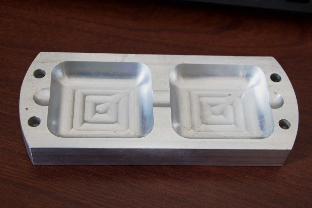

        My wife changing jobs has revealed this apprentice piece that has been sitting on her desk at work for many years.
        It is a very simple piece of CNC machining, but it has a history. It was created in the summer of 1981 in the apprentice training school at BAe Weybridge (Brooklands). We were the first year to have access to a shiny brand new CNC mill. May have been a Bridgeport or a Cincinnati, my memory is not that good. We were writing raw G code on a Commodore PET (no graphics or even a hard disk) and then transferring it onto the mill via punched tape. The instructor had been on a very basic course, so he was learning along with us. It was all very exciting for us young apprentices at the time! Alas we only had a few days of time allocated, so this was the one and only piece created.
        Vintage CNC

          Through holes to bolt it to the desk to stop it growing legs ?

            Stuart Bridger
              @stuartbridger82290
              Posted by Nigel B on 17/06/2017 10:46:17:
              Nigel B
              Like the idea, but the holes are blind, as per drawing
