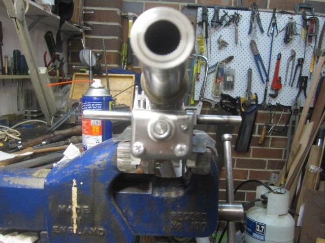

          Ady1
            @ady1
            Kewl rifling. Can you tell us how you did it?

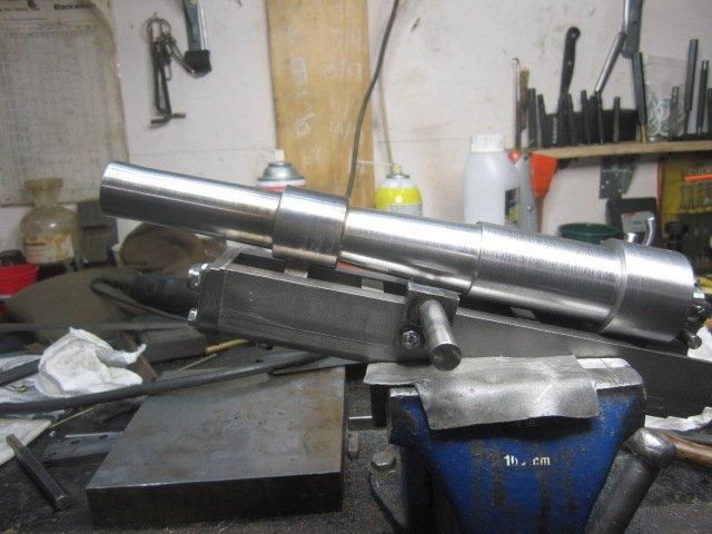

                  #119026
                  bob gould
                    @bobgould42821
                    Given all the indubitable skills and talent on this forum; any ideas on how one would achieve that rifling??>>
                    #119039
                    bob gould
                      @bobgould42821
                      #119059
                      bob gould
                        @bobgould42821
                        #119036
                          Homemade broach very similar to a spline broach would be a possibility. I think taking it out with a single cutter for each groove would see the cut wandering off over such a length.
                          J
                          #119049
                            J
                            #119069
                              J
                              #119038
                              Ady1
                                @ady1
                                Bob Gould
                                Is the rifling straight or has he imparted a slight twist in it?
                                #119052
                                Ady1
                                  @ady1
                                  Bob Gould
                                  #119072
                                  Ady1
                                    @ady1
                                    Bob Gould
                                    #119056
                                    bob gould
                                      @bobgould42821
                                      i'm pretty sure it has a twist
                                      #119070
                                      bob gould
                                        @bobgould42821
                                        #119091
                                        bob gould
                                          @bobgould42821
                                          #119066
                                          Jeff Dayman
                                            @jeffdayman43397
                                            A spline broach used on a rifling bench would be the likely method. The rifling bench is a long table with workholding features at one end and a helical cam (helix geometry matching the rifling twist) to mount and guide the broach at the other.
                                            There will be a twist in the rifling – the purpose of the rifling is to get the projectile to spin during flight, which stabilises it.
                                            I'm not any sort of gun expert – the above is the sum of my expertise on rifling.
                                            JD
