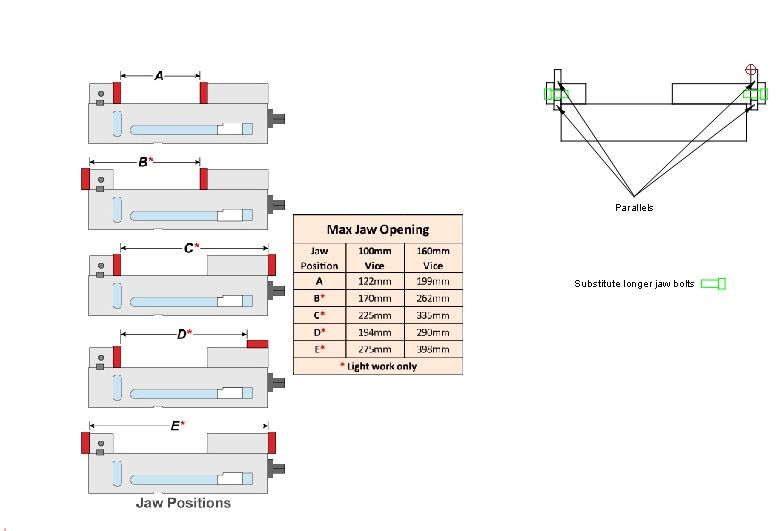

                          My experience, when I got a Warco VMC mill ( looks to have smaller work area than yours) was to buy a versatile SG vice from ARC. I went for the largest one and nearly gave myself a hernia lifting it out of the packaging and onto the table. It was obviously too big and a swift phone call to ARC allowed me to take it back and swap it for the smaller, 100mm, one. I particularly like the multiple positions that can be achieved with the movable jaws. With a bit of thought and jiggery-pokery, they can be used to hold material that doesn't fit between the jaws in their normal positions. The limiting factor, in my case, is not the vice but the machine's travel in the Y-axis. If it's a major problem, I resort to removing the vice and clamping to the table. I try to avoid that if I can to save the trouble of re-tramming the vice every time. I showed an example of extending the jaws in a similar thread not long ago:
                          ARC vice
                          Using the parallels in this way, with longer retaining screws increases the maximum distance available to clamp by at least 30mm to something in the region of 250mm+ as well as increasing the gripping area of the "jaws".
                          ( My 2d )
                          Original vice dimensions from ArcEurotrade's site.

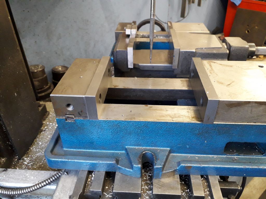

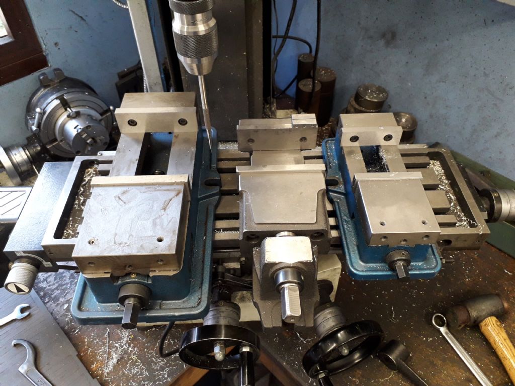

                                  Looks like I already had a photo
                                  100mm versatile, 4" K4 and 80mm versatile all without swivel bases on my X3 mill all at full conventional opening
                                  Edited By JasonB on 10/11/2020 10:20:39

                                  Lee Jones 6
                                    @leejones6
                                    Toys!
                                    Would you say, from the man with all the gear, the 100mm Versatile is the one to go for?
                                    OOI, why do you have 2 of the small ones? Are are they different enough to justify owning both?

                                      Posted by Roger Vane on 10/11/2020 08:44:22:
                                      Although I started off with a Vertex K4, I also treated myself to a Warco DH-1 vice which I now use for most jobs. I find it to be very accurate, and with a 175mm jaw opening it covers most of my needs. The optional V-jaws and high-jaws make it even more versatile, Not cheap, but well worth considering if your machine is large enough to accept it.
                                      Me too. As the DH-1's extra range is achieved with removable jaws, I expected accuracy would be compromised but it's not been a problem.
                                      The vice is a good match to my WM18 and anything too big for it is clamped to the table. I rarely use the swivel base.
                                      Buying a bigger vice for a small mill is a bit of a booby trap in that modest holding improvements require a much heftier vice. A 150mm vice is massively bigger and heavier than a 100mm of the same type, and sales photos rarely make this obvious. Loss of milling headroom may be serious.
                                      PS While I was thinking, I see Jason posted pictures of vices illustrating the size problem. Must type faster!
                                      Edited By SillyOldDuffer on 10/11/2020 10:34:02

                                          Don't know about that, the table was not long enough to get the 90mm and 34mm Type 2 ones in the shotwink 2
                                          I don't have "two small ones" the 80mm wide on the right of the photo takes up a a slightly larger table are than the 4" K4.
                                          If buying just the one on your size mill then the Versatile 100mm would probably be the best bet, the SG iron offers similar holding capacity but a smaller footprint as there is no drip groove around the base but you have to use separate clamps .
                                          I did not really have to justify owning them all.
                                          The K4 was bought back in about 2007 when I got the X3 and has served me will, I like the fact it has a solid base in the middle which is handy to rest short but tall items on and the fact I can get a square up close to the edge of the jaws to set work vertical. Hold down lugs are close enough together to make it easy to fit onto my 6" rotary table. It does suffer a small amount of jaw lift.
                                          The 100mm Versatile was originally sent by ARC with a selection of other items to use in the "milling for beginners" series but after talking it over with Ketan it was felt that it was too large for the SX2.7 so he sent me the 80mm version. I've only used the 100mm a couple f times when I have had a need for the larger opening, the 80mm was used for the machining that went with the series and now tends to live on the KX3 CNC mill as it fits on well within the swarf trough and has been big enough for what I have wanted to do on there. The larger width of the base has not been a problem as I don't have to look at a Y-axis handwheel but that can be an issue if you don't have a DRO. Barely measurable jaw lift. I would have sent the 100mm back with the mill at the end of the series and bought the 80mm but Ketan said keep it all.
                                          The 90mm Type 2 does not get that much use, again part of what ARC sent though the taller jaws have meant it was able to hold some round items where the half way mark would have been above the top of the other vices jaws. No jaw lift on this type.
                                          The 34mm Type 2 was a Xmas pressie and is useful for small items but does not come out of the draw that much.

                                              To answer your query at 10:12:41, I think we are talking about different vices. I'm referring to the SG versatile vices. They come in 100mm and 160mm flavours – no rotary base. I already had a vice with a rotary base that I bought with the mill. I soon found that was a mistake for me. I needed the extra headroom without the base and removed it, never to use it again. The 160mm SG vice is a beast – really heavy at 30kg and more suited to a Bridgeport sized mill. The 100mm size, although no wider than your existing vice, would in my opinion still be an improvement both in terms of increased headroom and, like the description says, versatility. I certainly wouldn't exchange mine for another design.
