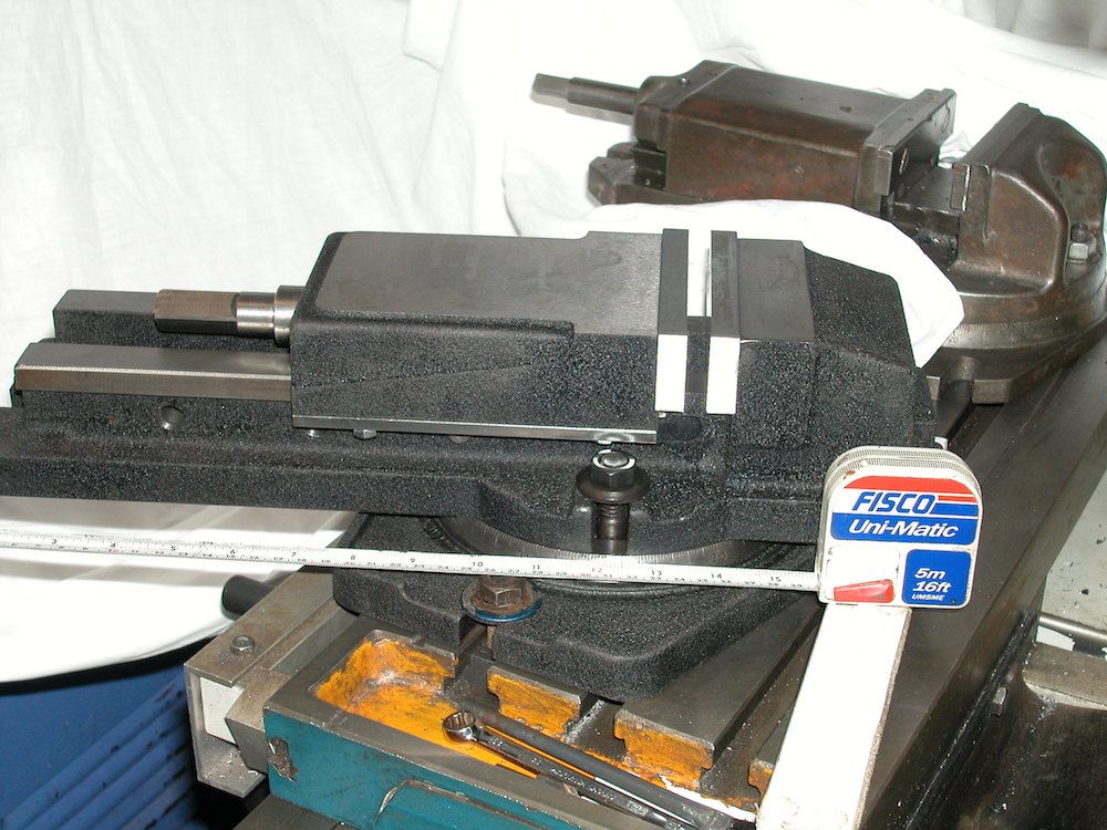

                                My go to vices are a pair of Vertex VJ400 110 mm jaw width / 180 mm max opening purchased from Rotagrip on a show offer when I had my big square column bench mill.
                                I'm convinced Rotagrip cocked up the show pricing but my credit card came out smoking and I've never regretted it.
                                Basically an economy version of a hydraulic vice with screw drive. Actual screw driven closing range is about 2 1/2 inches but the nut is located by a simple pull out pin with three alternate positions for openings of just under 2 1/2, 5, and 7 1/4 inches. Specification accuracy is 0.01 mm / 100 mm, mine came out better when I checked them but the figures are long lost.
                                Currently £325 from Rotagrip **LINK**
                                http://www.rotagriponline.com/index.php?page=shop.product_details&flypage=shop.flypage&product_id=19436&category_id=125&option=com_virtuemart&Itemid=29
                                Which still seems pretty good value. The hydraulic version is £300 more!
                                I keep the 3" vice in the background for use on angle plates and sine tables.
                                In defiance of popular opinion I keep the swivel base on.
                                A Bridgeport has ample room under the quill and keeping the swivel makes it easy to set the jaws parallel to the slots for normal use. I find that, once set, simply pulling back against the locating bolts before final tightening is repeatable to a thou or so in 4". Good enough for most jobs. Generally the bolt down slots on a vice aren't super accurate in position so you need to either accept the need to a djust each time you fit it or do a bt of re-working. Jason reports that his Arc supplied vice was pretty much dead nuts on as delivered. I reckon he was either lucky or Ketan sorted out a special one for his mate! From what I've seen something in the region of 5 to 10 thou error across 4" in jaw allignment when using simple pull back is more typical. Not bad given that the slots are rarely fully machined.

                                          I'm impressed by the capacity / weight ratio of that ARC 125 mm Versatile. At 22 kg its actually a bit lighter than the Vertex VJ400, which is said to be just under 25 kg, so its respectably handleable.
                                          According to Google Andrews Kurt tips the scales at nearly 38 kg, a couple or three kg heavier than my 6" Abwood so shifting is very much workout time.
                                          If they had been around at that relative price I might well have bought ARC Versatiles instead of my Vertexes as, for me at least, the useful capacity would have been similar.
                                          I'm unconvinced as to the utility of the extra jaw positions as the work holding is fundamentally via a small lip which seems less secure than one would ideally like. Although willing to be convinced to the contrary by photographic evidence I'm not sure I'd have the nerve to actually try.

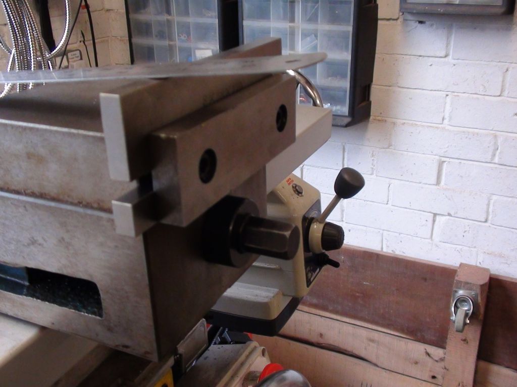

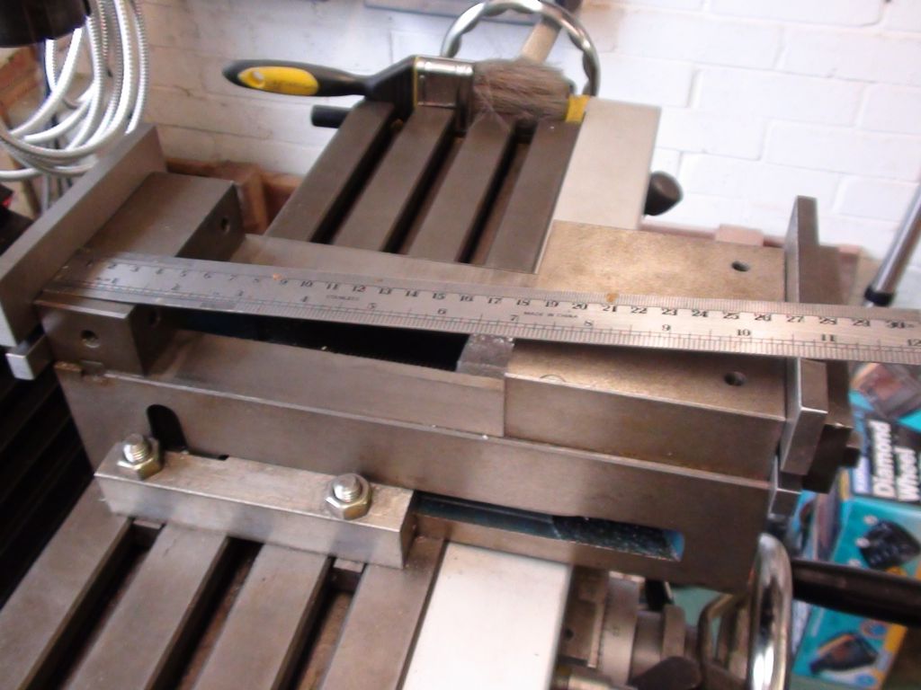

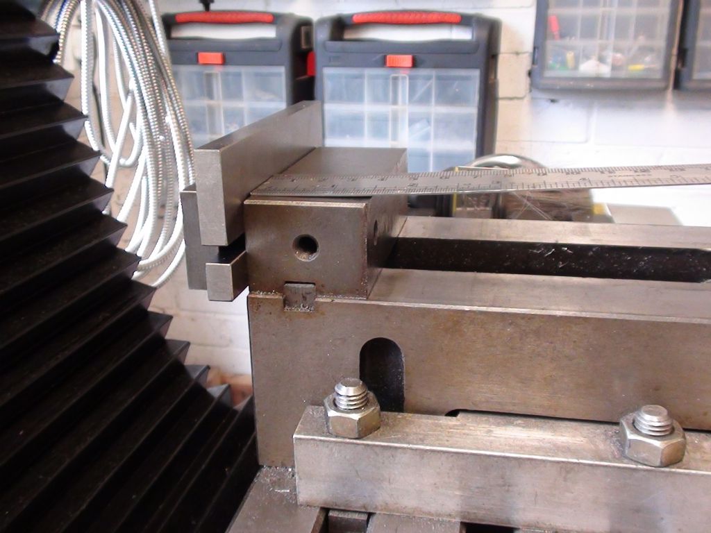

                                              I don't want to labour the point, but, as I pointed out in another recent thread on vices, posted by Nick Chelf, there is a quick way around this "problem". Link to thread.
                                              Using a couple of pairs of parallels (12mm and 28mm x 8mm in my case) mounted thus:
                                              photo showing parallels in position photo showing parallels in position_2
                                              …. and using some slightly longer screws, it is possible to extend the gripping range to around 220mm (or 10½ inches, if you prefer). I would only use this as a temporary set up but I have mounted a rotary table this way for a quick job, to save having to remove the vice and then replace and re-tram it.
                                              maximum capacity 10.5 inches
                                              Surely I can't be the only one who's done this dodge?
