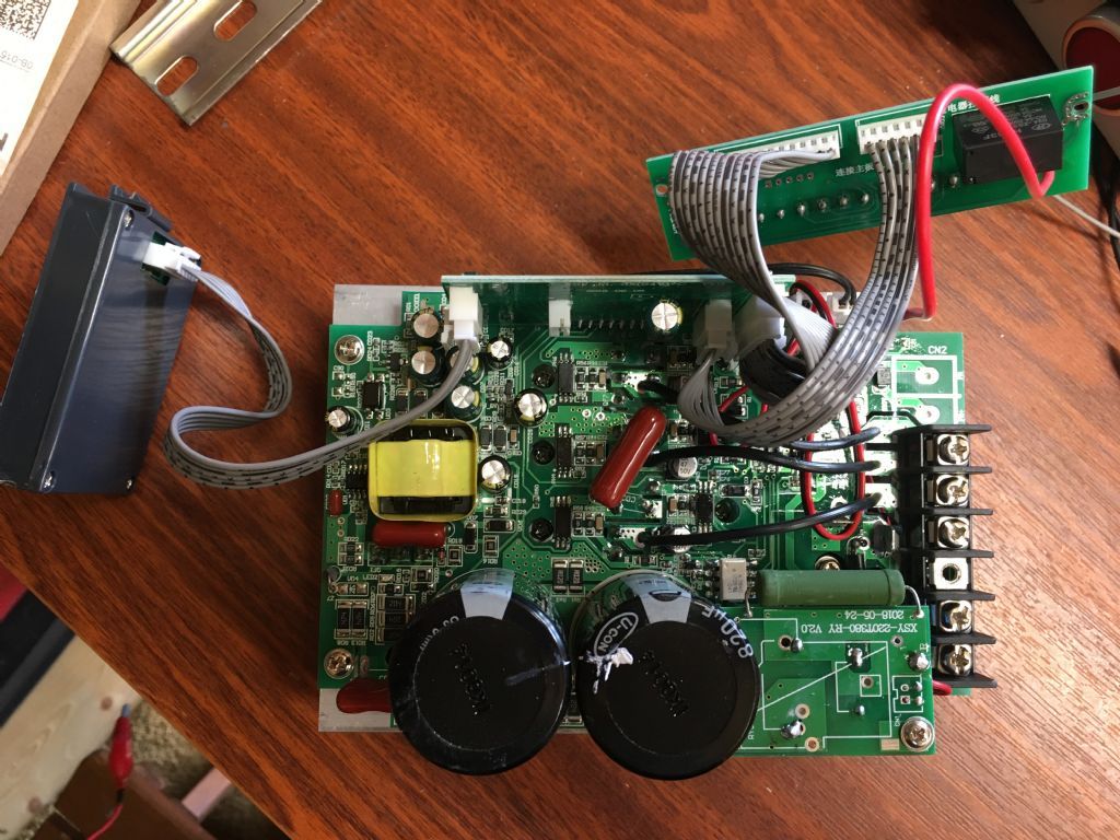

      Hi all,
      I have an inverter to convert 220VAC monophase to 380VAC triphase (XSY-220T380-RY is the marking on one of the PCBs inside the box, bought as XSY AT4). It worked fine on my Schaublin 102 lathe, but when I tried running a newly acquired Schaublin 12 milling machine, something started burning in the inverter. (I later discovered that the milling machine only had 2 phases out of 3 connected through the power-on switch, so I suspect the imbalance may have caused some problems….but that's a problem for another day…..back to the inverter…).
      I opened it up, and the burned component is one of 2 components on the breakout board in the bottom left of the photo. I am trying to identify it to replace it, but there are no markings. I am hoping that someone can point me in the right direction as to what it is. It is mounted beside a power relay, JQX-105F-1 024D-1HS, which is a 24VDC coil, 250VAC 30A output, form A, sealed unit that seems to still be functional. As there is normally a flyback diode mounted directly beside a relay in DC applications, I suppose that the burned-out component is a diode. However, it's not a form that I recognise. As I said, it has no markings, it is green, axial, has a fairly heavy feel to it, has some kind of matt-ish friable coating over what appears to be a metal casing.
      Does anyone recognise it? If indeed it is a diode, what is the type and probable ratings so that I can find a suitable replacement?
      Is it possible that the relay itself is used as some kind of AC relay, and the green component is some other kind of current limiting device, like a thermistor or something?
      The first photo shows the green axial component removed from the burned board, bottom right, and placed on top of the large capacitor for the photo.
      The second photo is one I copied from a posting on this site showing the component in place on a functioning board.
      Thanks in advance.

          I can only see one photo, but the green component looks like a resistor to me – one that has got hot, judging by the circuit board !
          Can you put a multimeter across it?

            Like John I think it is a resistor, carbon as I see no ridges for wire wound. check the value on a meter. It may have got hot enough to melt the solder and could be resoldered on – what else failed ? The metal cap is the end cap, and it's size indicates highish wattage. Noel.
            #626681
            Anonymous
              It's a wirewound power resistor. Probably around 5 to 10W, and 5 or 10%. Often used as an inrush current limiter.

                  The green component reads OL on the multimeter, so open circuit. There are no other components that appear to be damaged.
                  Any idea of what nominal value would be suitable for the resistor? I may have some old PCBs lying around that have some resistors I could recycle, otherwise it'll be a trip to the local electronics store.

                        Component value codes are normally printed on the green body, which doesn't look to be damaged? The PCB that the resistor is attached to contains a relay. So almost certainly the resistor is part of a current inrush limiter. If the resistor has failed it is quite possible that the cause was a relay failure. So it would be worth checking the relay and drive circuit.

                              The problem with assumptions is that they can lead one up the garden path. The resistor is there to limit the inrush current due to input filter and DC link capacitors when the unit is first switched on. It is not intended to carry full load current. Once the capacitors are charged the relay is closed and the resistor plays no further part.
                              Apart from value, the important resistor characteristic is its overload capability. Wirewound resistors are very good at taking short term overloads without going pop. The resistor value will be set to give a maximum inrush current and the power rating is determined by the charge characteristics. These types of resistors are designed to run hot, up to several hundred degrees!
                              I suspect that the value will be rather higher than 12 ohms. On a practical note these type of resistors are often only available in the E6 series, which does not include 12.

                                If this unit was intended for use on a 13 or 16 amp domestic supply (it is not of course) you would expect it to limit the current to around 10 to 20 Amps at maximum supply. So that is 240/20 to 240/10 so 12 to 24 Ohms.
                                Note that even at 12 Ohmsthe resistor would have to be rated at about 3500W to carry the input current (17A) for more than a fraction of a second.

                                  Ah ha, hence if the relay fails, the resistor cooks. So a higher resistance than my sum suggests. I'd guess 150 ohms because the inrush current doesn't last long. Not betting the farm on it though.

                                    If the relay fails closed there might be problems, but the resistor overheating isn't one of them. If the relay fails open the following would happen. After the capacitors are charged the current drops to a small value; just enough to run the control electronics. This current will be much lower than the design inrush current so the resistor will be fine. If the VFD is activated and starts drawing a current higher than the design inrush current from the DC link capacitors the DC link voltage will fall. That will trigger an undervoltage and the system will turn off. It's quite likely the resistor will survive.

                                        I was able to get my hands on another VFD unit to check the value of the resistor. It turns out it is a 390 ohm.
                                        I checked the relay by removing it from the circuit and checking it. It's fine. The capacitors aren't shorted at least.
                                        I put it all back together, but still no joy. I suspect the mosfets may also be blown, so next step is to remove them and check.
