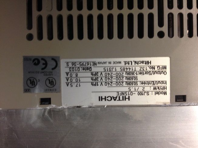

        Hi,I have just got a 2 hp motor and Vfd from a treadmill.The Vfd is a Hitachi SJ100.On the wireing panel there is L1,L2,L3, UT1,VT2 and WT3. and earth.
        Am I correct that I should connect the 230v mains brown to L1 blue to L2 and green earth.And motor wires to relevant terminals.

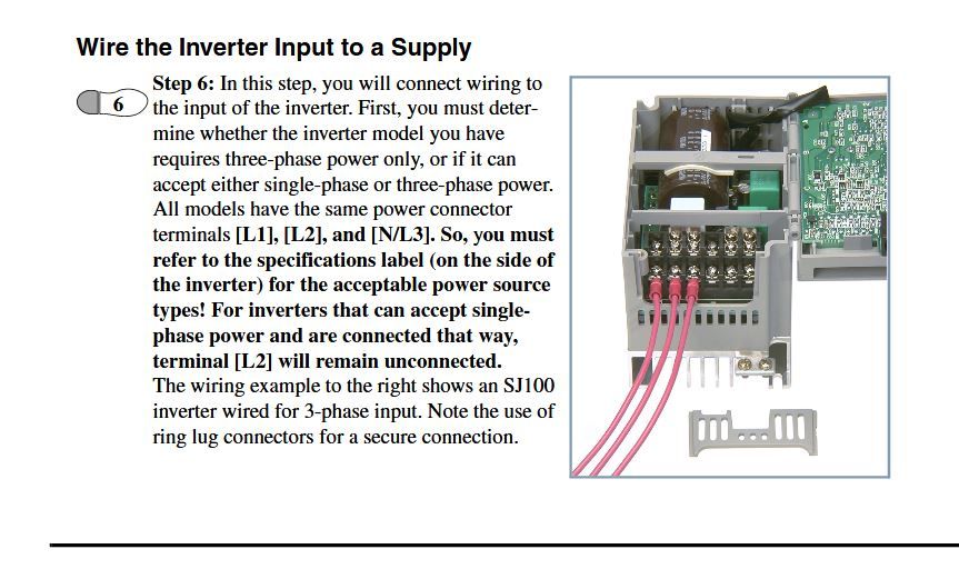

          I believe with that inverter, Live goes to L1 , neutral goes to L3 and L2 is unused for a 240v input.

            Manual is here
            **LINK**
            Suggest you read itsmiley

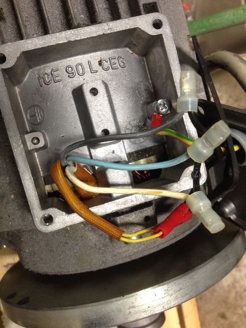

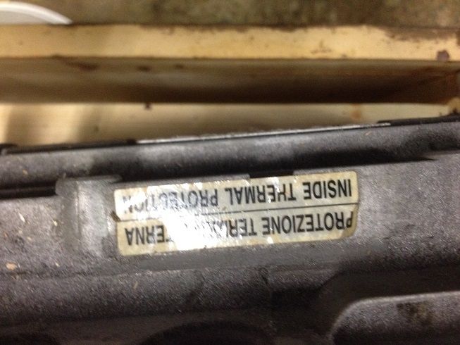

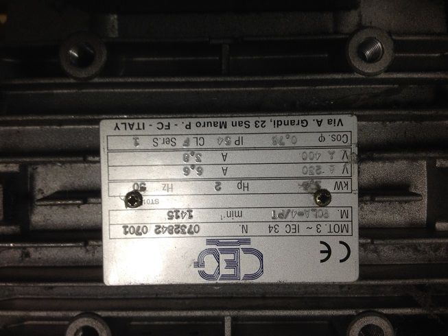

              vfd.jpgon motor.jpgmotor.jpgThank you for replies.When I opened the motor there were no posts but the wires were already connected as shown in pic.Which coloured wire should be attached to U,V,W.
              The two ywllow wires how should they be attached and to what.motor wireing.jpg
              Sorry pics are upside down again.
