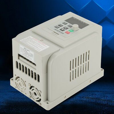

      The reason? The mains voltage connections are accessible without using any tool or having an interlock.
      The Ebay link above shows that the terminals on the 1.5Kw XSY AT1 are covered by a screw secured cover ?
      Could you link to the video of the one wth exposed terminals, please – the only one I can find is in Russian & the commentator has the terminal cover in his hand at one point.
      Nigel B.
      #458930
      Martin of Wick
        @martinofwick
        mgn,
        the little screw on cover protects all the low voltage control terminals.
        the high voltage connection wire go directly into the oval slots on the base below (one terminal per slot for avoidance of doubt). However, this appears to be a common feature of most VFDs.
        Clearly you don't want to 'hang one on the wall' in that set up condition!
        should have said that the screws to tighten the terminals for the HV side are also beneath the cover but recessed below the case  (and hard to see too!)

            I think I have sorted the VFD. I set the display to amps and observed what happened when the motor accelerated. The current became too high and the VFD tripped showing error 6 (over current protection). I set P34 (main rising current) to 10 instead of the default of 25. Now the VFD accelerates more slowly, the amps do not rise as high and it does not trip. Thanks to all for the support.

                  John, good news – reducing the start ramp rate to limit the surge is fine for interim, but for my peace of mind are you really using a 1kW motor that would actually account for approx. 5A current draw? Should really try to get to the right over current settings for your situation rather than skirt around the issue.
                  Need to also check that using the VR rapidly doesn't cause a similar effect.

                    Martin, the motor is .75kw not 1kw and is rated at 3.2 amps. when the motor is running at 50hz without load it now draws about 3.8 amps. This increases when under load to about 5amps. The main current overload P78 is set at 6000mA which was the default setting with this VFD not 3000mA as shown on the parameter settings. It was your earlier post that pointed me to the P34 setting which hopefully has cured the tripping. I dont know what you mean by VR but if you mean P42 (ramp down) then it is set to the default of 25 and seems ok.
                    #458954
                      Posted by john barnes 4 on 22/03/2020 18:31:46:
                      Martin, the motor is .75kw not 1kw and is rated at 3.2 amps. when the motor is running at 50hz without load it now draws about 3.8 amps. This increases when under load to about 5amps. …
                      I don't like the sound of that, something may be wrong. It should drawing about 3.2A under load, not 3.8A off load.
                      Does the motor get hot if left running with no load for several minutes ?
                      May be a measurement issue, do you have a wattmeter you can put on the mains input? One of these would confirm if there's a real problem or not.
                      I'm wondering if the motor has a shorted winding.
                        Is that 3.8A no load current measured on the input to the VFD or the 3 phase motor connection ?
                        If your'e running a 3.2A FLC motor at 5A measured on the motor tails be prepared to get another motor ordered before the smell and smoke appear.

                          John,
                          VR =potentiometer or the little knob used to increase or decrease the motor frequency. on some setups if I turned it too quickly it could cause a trip if the overcurrent was set close to run current.
                          Those indicated currents are a fair bit higher than I would expect for no load and load, but as noted in my previous post the display V I are not always completely accurate so treat as suspect initially (at indicated 5 A power draw would be just over 1kW if it were true) .
                          Just keep a watch on your motor and check it isn't getting unacceptably hot when the lathe is working. some people use one of those cheap digital temperature displays to check initially.

                          Ex contributor
                            @mgnbuk
                            Access to the power terminals is also via the screw on cover – you can't get a screwdriver through the cable entry slots to tighten the connector screws. The cable entry slots also appear to be sized such that accidental finger contact with the terminals is unlikely, partciularly so with cables going through the slots.
                            The point I was trying to make (unsuccesfully it seems) is that the assertion that the power terminals are are not shrouded or adequately protected against accidental contact and are thus a dire health and safety risk does not seem to be correct – the Chinese inverter does not seem to be substantially different to branded European or Japanese products in that respect. I
                            Other aspects of it's construction. circuitry, interference levels & documentation are all different issues, though !
                            I could be tempted to try one on the Triac if a branded one doesn't come my way – if I could ascertain that the analogue input was isolated. It would be mounted in a steel enclosure, with shielded cables, an input filter & ferrite rings on the output cables -same installation as a branded one in that regard.
                            Nigel B.

                                        John,
                                        non conforming display nothing to do with shielding. The best guide is to check motor temperature. If really drawing 5A on 750W motor when you put your hand on it will get 'aargh S***' hot very quickly.
                                        I assume that the display current is measured on the output phase, but I don't know for sure.
                                        I have seen on various setups higher than expected current on the display. For example, I am setting up an 8 pole 370W motor at the moment –
                                        plate indicates 1.3A at 400V 50Hz. display shows 1.9-2.1 A no load at 410v from a 220v in 380v out dual stage VFD (spindle not connected). For an 8 pole fractional motor I would expect about 1 A current draw no load. If I run the motor for an hour or so, it gets warm but not hot – stabilises at about 45-55c (without the fan).
                                        I could be very wrong, but that suggests to me the motor is not really drawing 2A and similar logic may possibly apply in your case but you have to proceed with care.
                                        In other applications I had noticed a similar discrepancy at the pad display relative to plate, but it was not as large as in this instance. I have been awaiting the arrival of a replacement clamp on meter to check phase currents at the motor for comparison, but it has been a long time coming. If I get it any time soon I will update.

                                                As a matter of comment only, that ebay item linked to by mgnbuk does not appear (to me) to indicate it is the inverter in question, so possibly just a ‘red herring’ thrown in?
                                                Not sure what you mean by this ? The link is to an XSY AT1 inverter,as originally referenced by the OP
                                                Still can't see the terribly dangerous, exposed, not protected by a screw secured cover terminals that generated your original comments NDIY ? Could you post the links to your source that suggest that this is not the device in question to clarify please ?

                                                  The XSY's that have passed through my hands all look like that (but in varying colours and plus or minus a fan or pop out keypad).
