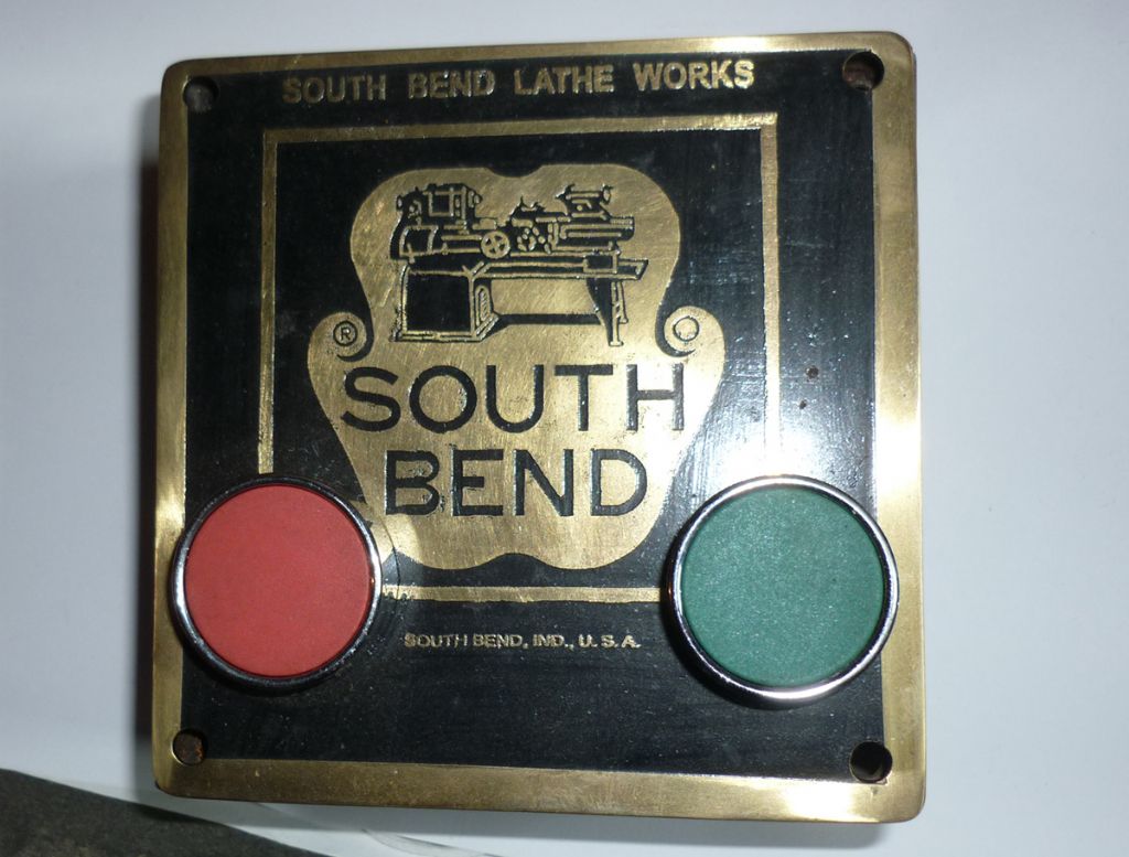

                    Kevin, i hope you get some replies,as i have a couple of inverters that i want to wire a remote pod on and all inverters seem to have different labelled terminals which certainly confuses me . On my south bend lathe i have a remote box which i salvaged from something else which has been sitting next to the lathe for 3 years .Currently im reaching over to the wall and using the inverter controls on its front panel.
                    Being electronically illiterate myself i dont follow all this 2 and 3 wire control stuff,etc…
                    Have you bought one of those pods off ebay??
                    I fitted a brass plate to the front of mine and etched a south bend design on it ,the buttons look naff but as i said its been sitting there for years. I do have a speed pot to fit on the side as well.,and id like the forward reverse switch fitted as well.
