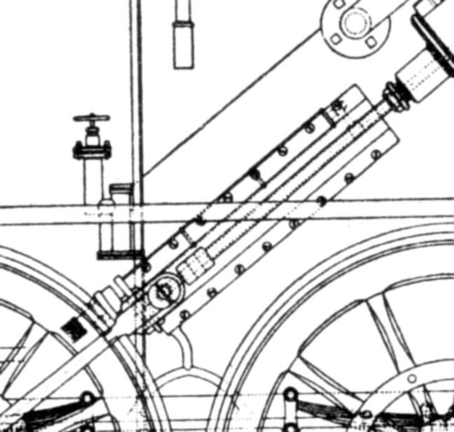

                Jonathan Howes
                  @jonathanhowes93303
                  One from the Stephenson archive. Ho does that one knob on top control the feed without hydraulic lock? Obviously it doesn’t so what is missing?

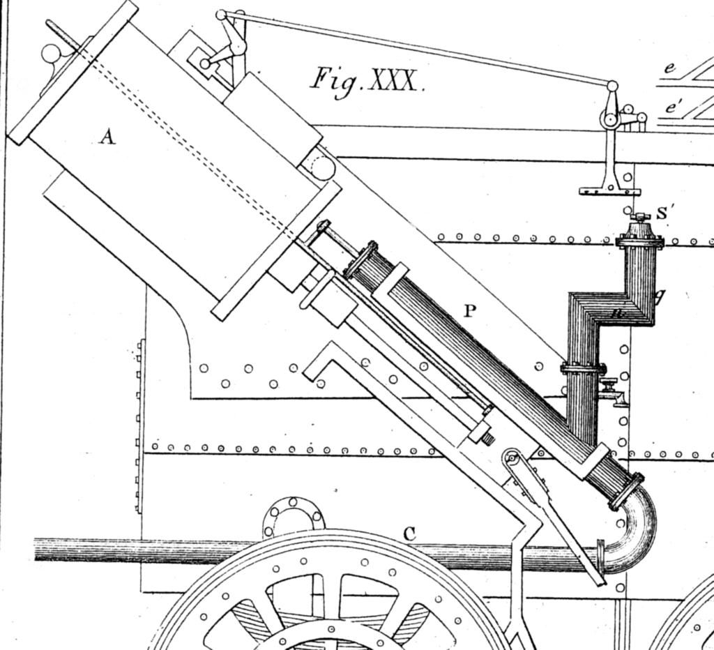

                  And one from the two French engineers who visited the engine at work, even more confusing:

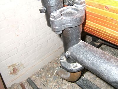

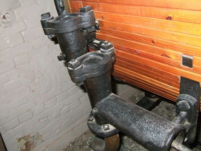

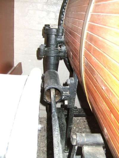

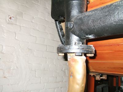

                    And four views of the Invicta unit. There seem to be two plug valves operated by square section heads implying a key in the hands of the driver, obviously regarded as a responsible job. What form of valve can be got in to the end of the ram pump to prevent its action given that there does not appear to be much room to install anything  with no access cover visible?

                    Jonathan Howes
                      @jonathanhowes93303
                      The engine was visited by the two french engineers, Coste and Perdonnet, while working on the Bolton and Leigh railway. Their description of the boiler feed goes (my translation…):
                      P, force pump. This draws water via a leather tube, from a barrel placed behind on a train T, and raised to the boiler by tube C.
                      A horizontal boiler feed tube is indicated by circle n’, q (my note; this places the feed lower than on other examples).
                      S’, the  adjustable boiler feed valve. The piston rod of the force pumpis rigidly linked to the  piston via a rod from the crosshead as shown in the figure.
                      So, still little clearer and what is that trycock doing on the vertical pipe just above the pump barrel?

                        Thanks to KWIL for sending me a drawing of the Locomotion pump. I was wondering if a three valve system was at play here. I still don’t see how the feed rate is controlled however.

                            Paul,
                            This was what I was looking for at first, the problem is that the French reference (three posts back) clearly states that the valve S’ in the figure is an adjustable boiler feed valve. Elswhere in the french text this is clearly stated as being convenient for the location of the driver as it projects through a platform on the side of the boiler on which the driver stands. A bit awkward here as the Stephenson drawing shows the valve and platform on the left hand side of the boiler, the French text describes (but does not show) the platform to the left and the pump/valve to the right.
                            From other digging, feed pipe valves do not seem to appear on locomotives until the early 1830’s, LW was built in 1828 and is a very important locomotive being the first to employ expansive working of the steam, it was also the clear predecessor of the Rocket.
