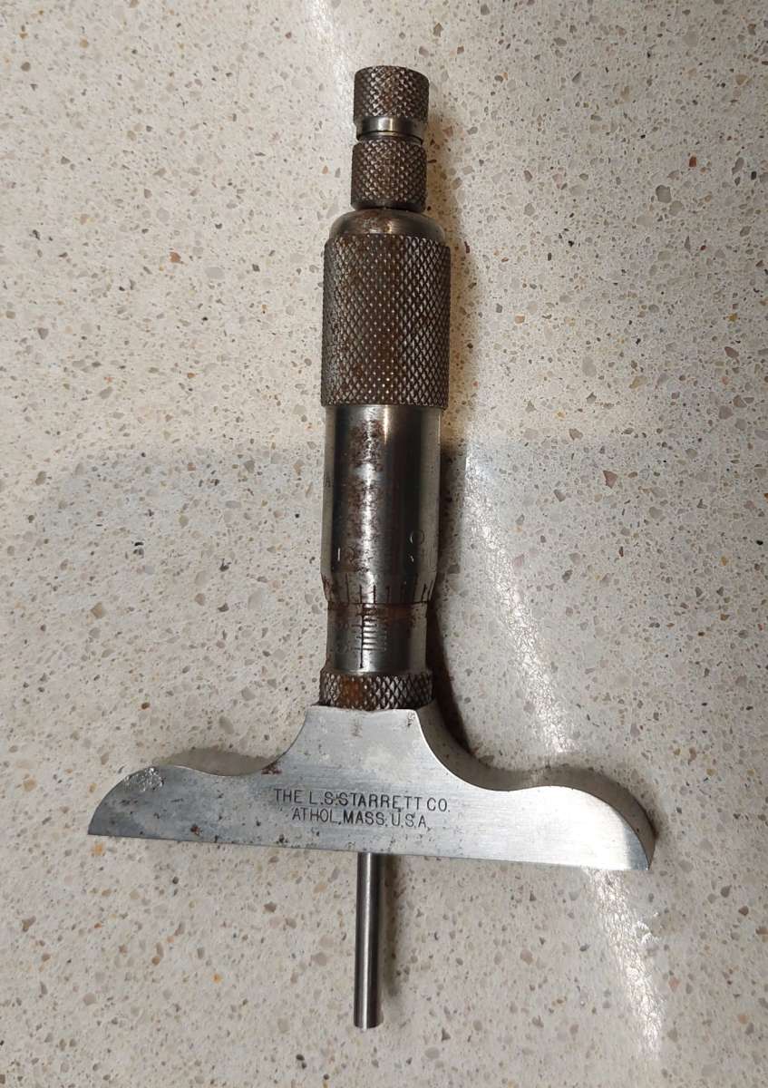

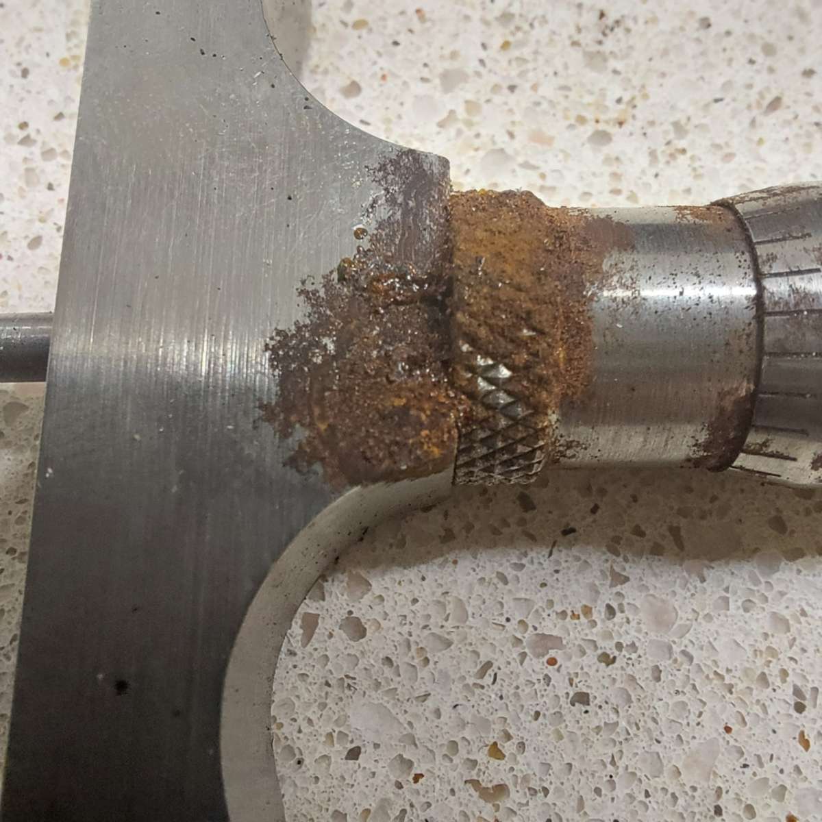

      I’ve used pretty concentrated phosphoric acid to remove rust – it keeps on going and eats the steel plus the phosphate coating is pretty nasty. I’ve used citric acid and am a big big fan – cheap in powdered form, the black residue comes off easily enough, it’s not too aggressive. I also use hydrochloric (brick) acid when I want something that’s going to go straight to paint…
      but…what should I do with this (and a 50 odd other similar pieces) – what’s going to let me get that rust off without making a mess of the whole thing? Electrolysis?
      Advice (ideally proven) much appreciated. Thanks 20250220_19554720250220_195600

        Whatever you soak it in will discolour it badly. I would be inclined to use mechanical means ie a fine brass brush and a white dish scourer very gently a good soaking with WD40 or similar for a few hours will help.  Its surprising how easy most of it will come off.

          I use a product called “Evaporust”, it works very well on such things as musical box combs where you dont want to affect the steel too much.

            I think you’ll have to accept a lot of steel has returned to Nature there. It looks as if it’s either been lying in a puddle or in contact with something that has attacked the steel electrolytically.
            With the instrument dismantled completely and the threads protected (plastic sleeve?) I think careful wire brushing first to clear the worst, then degrease and pickle.
            I’d go for the citric acid to be fairly gentle. Then careful work with ‘Scotchbrite’, one of those rubber abrasive blocks or ‘Brillo’ pad.
            May be best to work on the least damaged / least critical areas first to establish the effects. The difficult bit is going to be protecting the internal threads.

              Electrolysis for me. I’ve used it many times and it doesn’t etch the surface like acids.

                Evaporust, mentioned earlier, works well for me on measuring stuff such as vernier calipers etc.
                Do gently wire brush off any loose rust before starting, as well as a thorough de-grease; I normally use the very fine stainless steel or brass brushes that come from cheap discount stores.
                After treatment, soak/wash in very hot water, dry, and immediately spray it with something.
                The hot water, is just so it dries quicker after wiping down.
                I use Motorex 645 Protect & Shine; I still have old stock, but I think this is the latest version

                  Thats what i am thinking. Does it take the black out of the graduation markings too?

                    I restore antique torsion clocks and use Evaporust but a word a word of caution don’t leave it in for more that 10 hours otherwise it will turn black although if it does it is easy to clean  off.

                      ++1 for Evaporust. It chelates the rust causing no damage to the underlying steel. It’s water based so you do have to remove any oil or grease (solvent followed by hot water and detergent) before putting it in th Evaporust. On removal rinse with hot water and spray with WD-40 or similar or the very clean steel will start to rust again.

                        It will remove loose paint, at least that’s been my experience, so you could loose it in the markings.

                              Another way is by careful mechanical removal means. Where the faces are not dimension critical for the measurement where even extra caution is required.
                              So the process wound be.
                              For the base of the frame, a dead smooth single cut file, placed flat on the face and gently rubbed over the rust to ‘shave’ off the top layer without ‘cutting’ metal. Next, ultra fine wet and dry lubricated with WD40 or the like, supported by the file, again rubbed with the grain ( previous grinding direction ) to clean up. That in most cases will remove the rust without adversely affecting the surface.
                              Never do this by hand, ALWAYS support wet and dry with the file to maintain flatness and eliminate the risk of rounding or damaging the sharp edges. That’s the difference between bodge and care…..
                              Same approach for the barrel…
                              For the knurling…..
                              Grind a hand graver tool to match the ‘V’ of the knurling and gently ‘re-cut’ the knurling by hand to clean out the rust. Finish with a soft brass wire brush and WD 40 to clean and a hard bristle brush at the end to remove any brass residue.
                              That’s my ‘old skool’ means of de-rusting and I have done many concours level restorations in that way to very good effect, with care a near new appearance can be produced in many cases.
                              But the caveat is, that if the rust pitting is deep, it’s never going to loose the little black spots as they are too far under the original surface to be removed by such gentle means.
