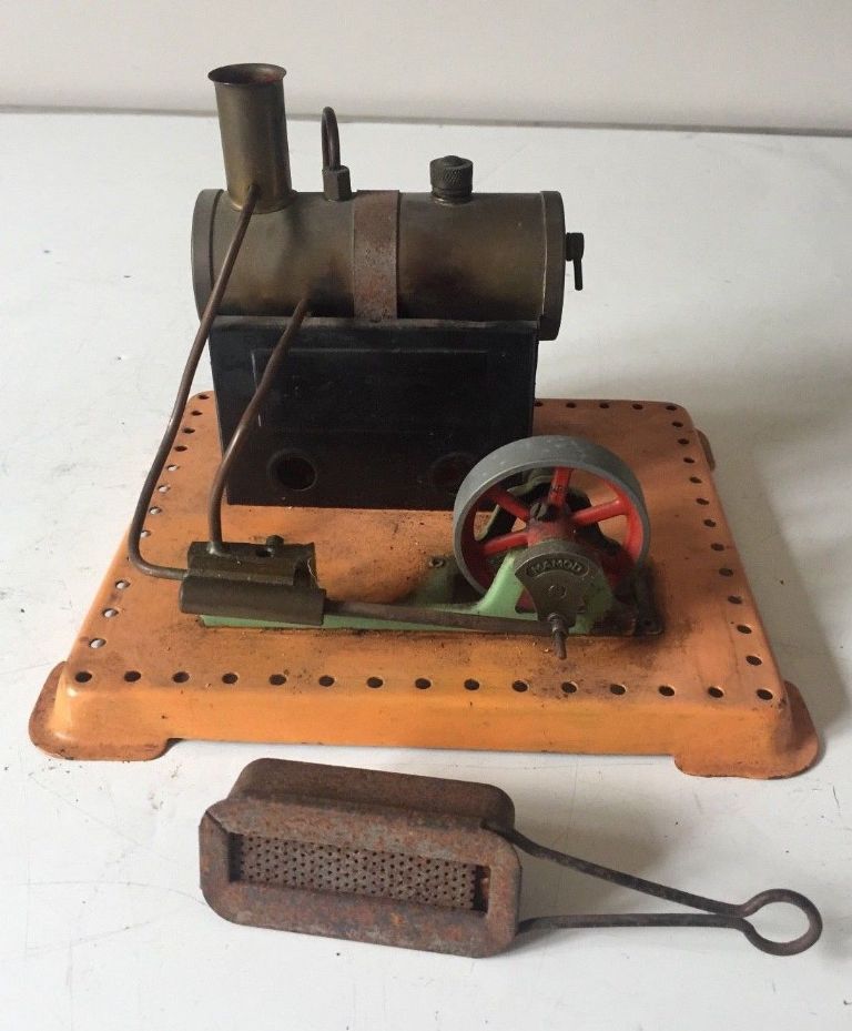

                              Meanwhile, and entirely separately from all of the above, I just treated myself to these two little gems – Mamod SE1 and SE3:
                              They will need some restoration work at some point – as though I don't have enough projects on my plate already!

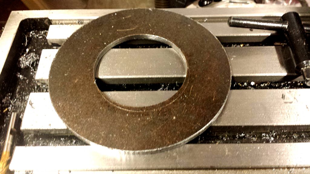

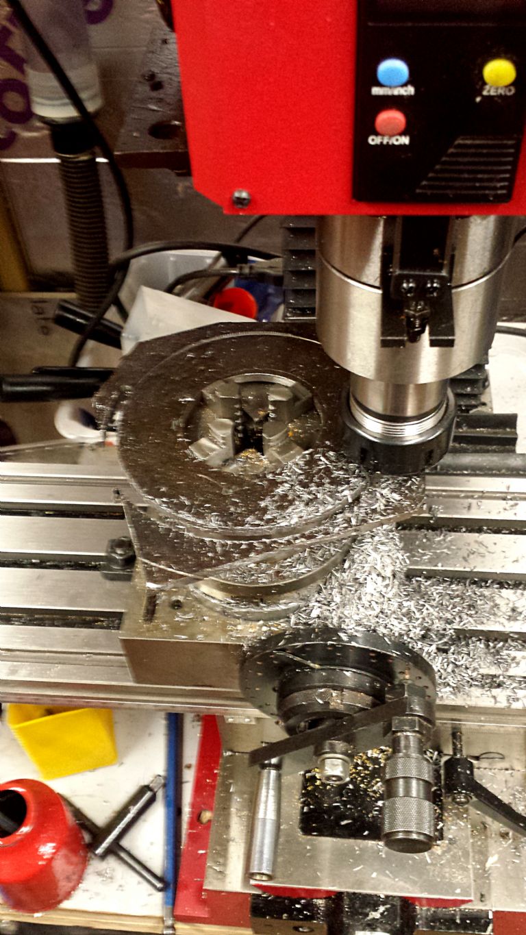

                                  So…
                                  Back on the boiler. Or I should say the firebox as the boiler itself is pretty much finished.
                                  The test firings on gas and methylated spirits went well and raised a good head of steam. However, not so the solid fuel test using small pieces of hardwood in a roughed-out firebox, which failed to produce enough heat. Not to be deterred (not yet, at least), I'm now in the process of modifying the firebox to make it smaller and more compact to keep the heat near the base of the boiler, where it should be. Again, I'll start with a rough trial version in case it doesn't work. No point in wasting time!
                                  However, in such a scenario the top plate of the firebox could be repurposed for use on a meths burner so there's no reason not to make a proper job of that from the outset. That's what I'm doing – or trying to do – now.

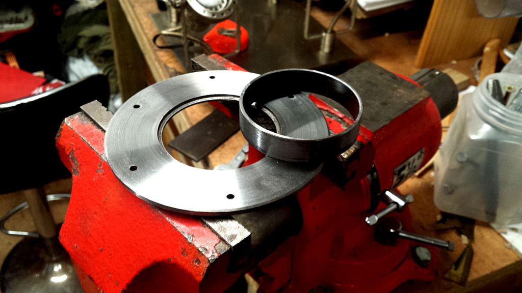

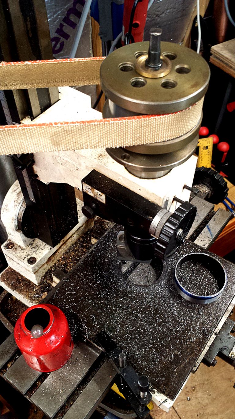

                                  First, I cut a small piece off an empty oxygen cylinder from a portable oxy-mapp kit to form a short spigot (it can be seen in rough form in the first picture below). This will be brazed on to the firebox top plate and will fit up inside the bottom collar of the boiler as the conduit of heat from the firebox. A strip of carbon gasket material wrapped around the spigot will form a cushion and seal between it and the boiler.
                                  The top plate is made of 5mm mild steel plate. I used a hole saw to make the initial hole for the spigot then proceeded to bore it to size with a boring head. I plugged the boring head into my new Sieg SX2.7L mill using a 2MT to R8 adaptor, only to realise that the thread on the drawbar of the machine didn't fit the arbour of the boring head. It was Sunday night, and I had neither the wherewithal nor the inclination to make a new drawbar. Rather optimistically, I gave the setup a go anyway. It worked at first, but as the hole enlarged and the radius of the boring head extended, the lateral forces generated pulled the boring head out of the quill. Not good.
                                  Fortunately, my customized 'drill press milling attachment' (with a drawbar which fits the boring head) saved the day:
                                  This contraption has raised an eyebrow or two in its time, but it has on more than one occasion got me out of a pinch and is actually quite good, especially as the drill press which powers it now has a three phase motor. And there are occasions when a bit of belt slippage is no bad thing…
                                  For details of its workings, see this video:
                                  With the central hole bored to size, I roughly sliced off some of the steel plate with my Evolution Rage mitre saw (wouldn't be without it) to make it manageable, and then back to the Sieg SX2.7L to cut the top plate to just over external diameter using a rotary table and small endmill. I'm finding I really like this mill – for a smallish machine it fairly hogs the metal:
                                  Cheers,
                                  gary
                                  #385170

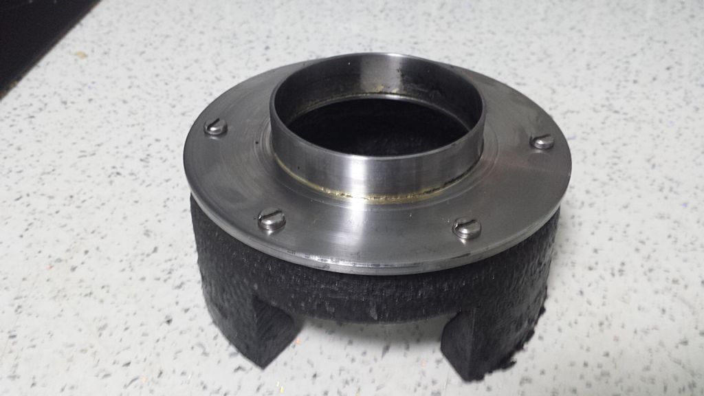

                                    The firebox top plate and spigot are now done and are ready to be brazed together and fixed to the main firebox body with M4 screws:
                                    Edited By gary.a.ayres on 11/12/2018 22:35:44

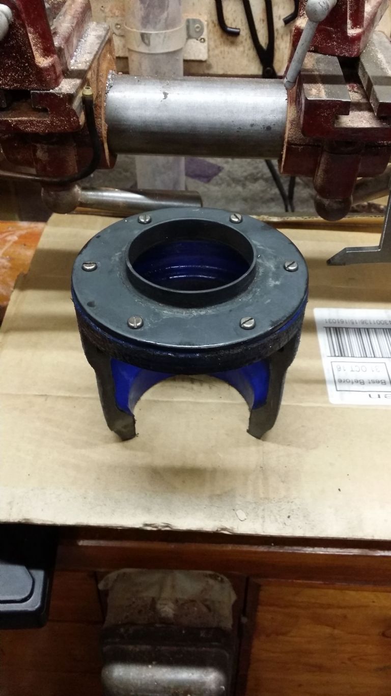

                                    #386384
                                    gary arthur
                                      @garyarthur48070
                                      I spotted through the holes in the top plate then drilled and tapped (M4) the bolt circle in the top half of the firebox body:
                                      I then took the firebox top plate off again and silver soldered the spigot for the bottom of the boiler on to it. Believe it or not my Sievert torch started playing up (again) during this operation and would not heat enough to melt the silver solder (which was cut into small pieces laid around the join), so I put the assembly into the woodburner in our living room – which had the assembly red hot and the silver solder flashing round the joint in no time. Dubious practice, but I got away with it! The join isn't the best, but it's actually better than it looks in this photo:
                                      And here's where it's at currently – the bottom half of the firebox needs to be fixed back on, a few more tweaks made and it will be ready for another try with solid fuel:
                                      And if I just can't persuade this little boiler to run on solid fuel, none of this work will be wasted as the firebox will easily convert into a meths burner housing.

                                          #386598
                                          Paul Kemp
                                            @paulkemp46892
                                            Gary,
                                            Your firebox looks quite shallow? Your fire door for introducing fresh coal needs to be far enough above the grate to give some depth of fire, I would guess 1/2 to 3/4" would be about right and there needs to be similar below the grate for air to get in (allowing for a build up of ash as it burns). The door needs to close too so that the combustion air comes up through the fire and not straight in over the top.
                                            Paul.
                                            #386623
                                            gary arthur
                                              @garyarthur48070
                                              Aha… yes indeed Paul.
                                              You'll see in my post above (the one with the pictures) that I say 'the bottom half of the firebox needs to be fixed back on'.
                                              What you are looking at above is only the top half of the firebox, which I took off to drill and tap the bolt circle for the top plate. The bottom half (which I'll be putting back on as soon as I have made some finishing touches to the top plate) has the bottom half of the firehole plus an opening for the ashpan below the grate already roughly cut out.
                                              This is all currently in very rough form for a test firing to see if the boiler will actually run on solid fuel, but it will have a makeshift cover to close the firehole as you describe. I'll post pictures once it's back together, and if it all works I'll tidy up all the openings etc which are just roughly cut out at present, and fit a proper door.
                                              Cheers,
                                              gary

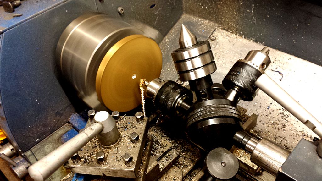

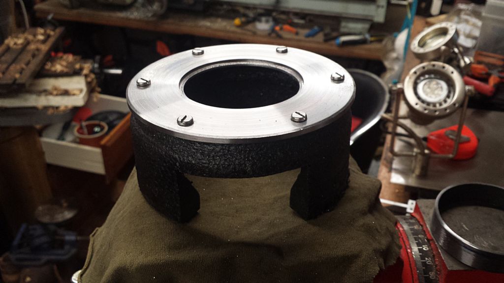

                                                gary arthur
                                                  @garyarthur48070

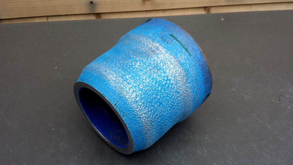

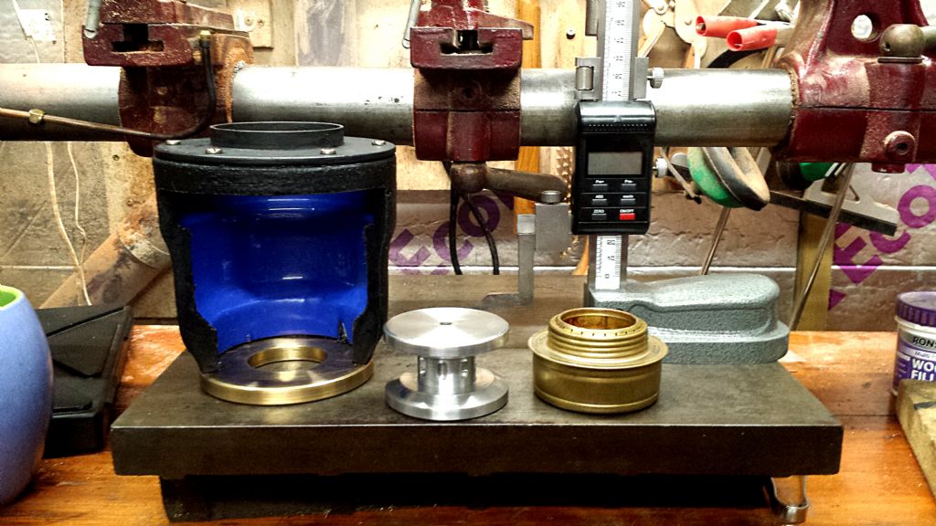

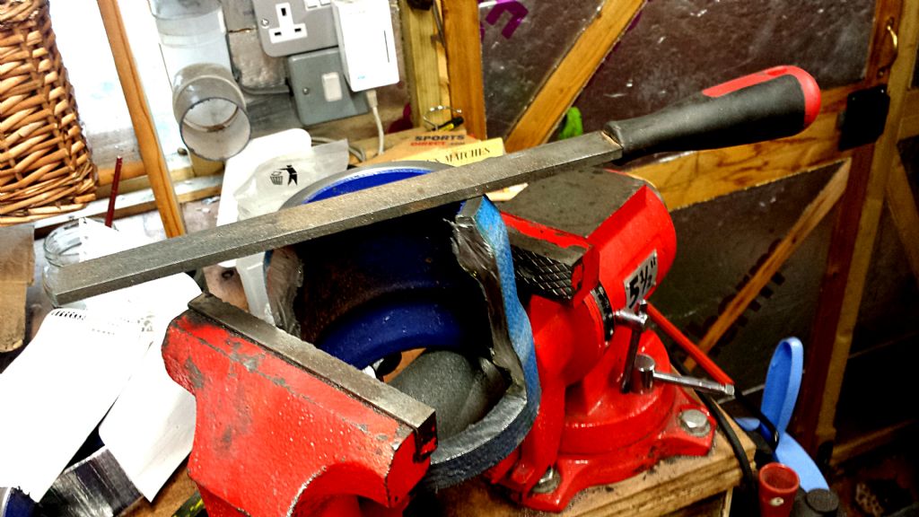

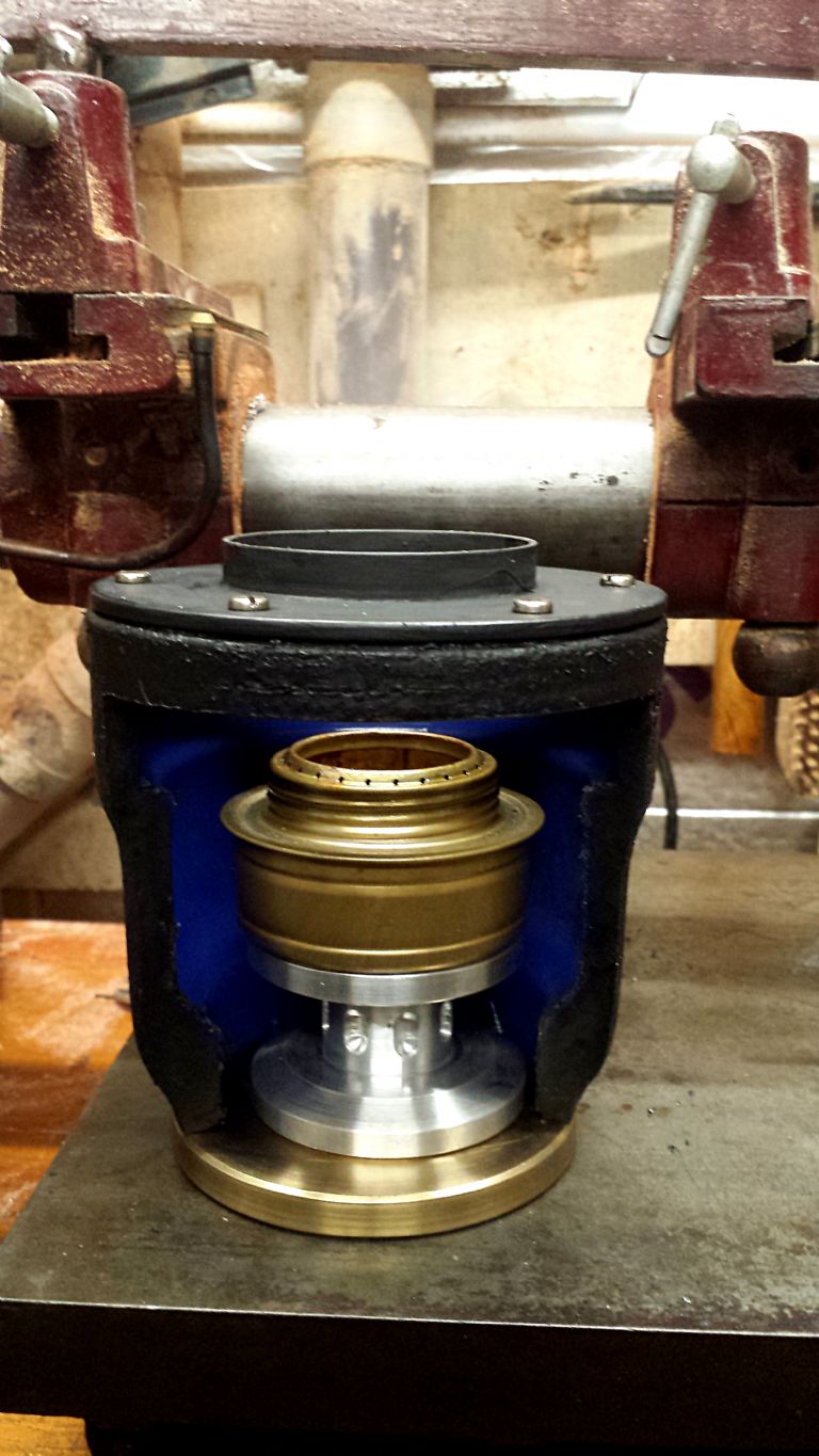

                                                  Currently working on the housing for the Trangia meths burner.
                                                  I cut the flared end off a ductile cast iron water pipe and faced the cut end:
                                                  Twenty minutes with an angle grinder and five million years with a file…

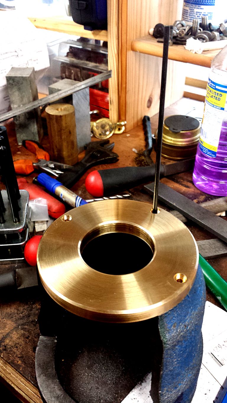

                                                  …plus spotting through the holes in the end cap from the old solid fuel firebox using my new transfer punches, and drilling and tapping resulted in this:
                                                  Beginning machining a slab of brass for the base (and showing off my Christmas present):
                                                  And that's it until tomorrow.
                                                  Not too bad a day's work I reckon.

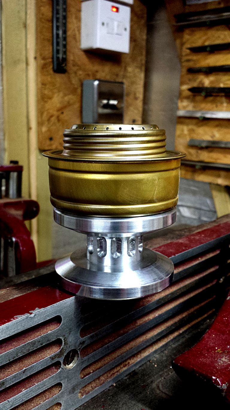

                                                  #388776
                                                  gary arthur
                                                    @garyarthur48070
                                                    Continued with the meths burner housing today.

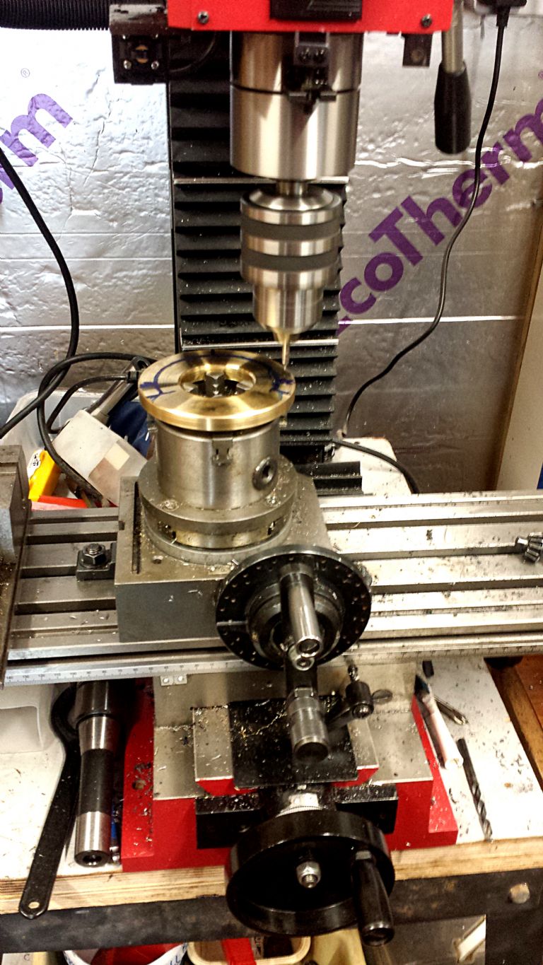

                                                    Drilling the fixing holes for the base:
                                                    I'm liking my new transfer punches:

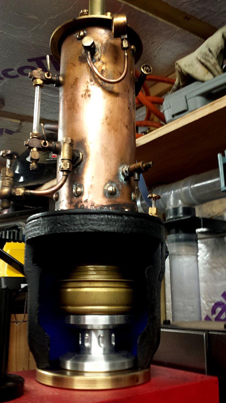

                                                    The various components – the housing, the burner plinth and the Trangia alcohol burner. The ductile cast iron water pipe end which forms the main body is lined with a tough plastic material. I like the blue colour, which I think goes nicely with the brass base and aluminium plinth, so I decided to keep it. There's a fair chance it will start to melt or scorch from the heat and need some attention, but I'll cross that bridge if and when I come to it. The exterior was painted with black stove paint :
                                                    Almost complete now – I just need to fix the various components together:

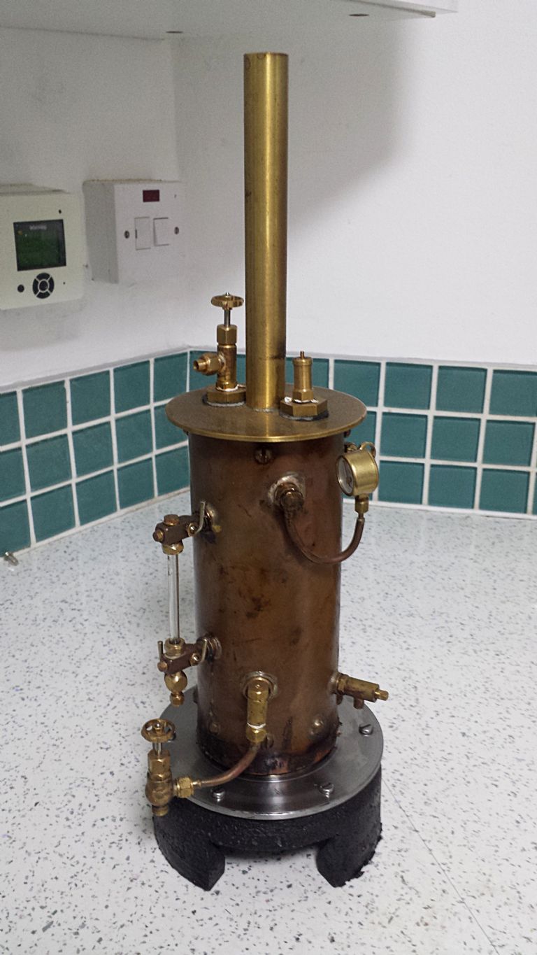

                                                    Here it is with the boiler in situ. I tested the setup a few evenings ago with a jury-rigged version which was almost identical in principle, so I see no reason why it shouldn't work. However, if the height of the burner needs to be changed, the plinth can be adjusted, and if it needs more air, holes can be drilled in the housing. Hope to have it all fixed together and tested sometime over next weekend:
                                                    gary
                                                    #389011
                                                    gary arthur
                                                      @garyarthur48070
                                                      I was unhappy with the number of flutes in the column of the burner plinth I made yesterday so I made a new one with 12 divisions instead of 8.
                                                      However, while I'm pleased with the overall look, there are still a couple of aspects of that plinth I'm still not overjoyed with, including the standard of milling of the flutes, which I know I can make a better job of.
                                                      I might redo this part yet again, but I'm going to test it for optimum burner height before I do.
