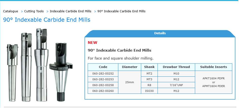

      I must have bought the last one of the above from Arc as all details have now been removed from their site. Unfortunately I forgot to note the carbide tip designations that fit to these. Does anyone know what they are please?
      Gerry
      #815072
      Mark Easingwood
        @markeasingwood33578
        I “think” it is    APKT 1604 PDFR   for Aluminium, and good for cast & steel for we hobbiests.
        Someone else will hopefully confirm.

          ARC_Indexable

            Thanks chaps for your fast responses. I can get ordering tonight!

                    Apologies for removing the said page from our website. As goods go out of stock, we try to update the site by showing less ‘out of stock’ items.
                    As Howard mentioned above, all ARCs remaining stock for Indexable tooling has been acquired by Jenny – JB Cutting Tools, for which I am very grateful to her. To the best of my knowledge, she has a good stock of SECO inserts for use in these products.
                    When we ran out of APMT and APKT inserts, for on-line sales we were directing potential buyers to APT, with links to pages:
                    for APMT, and APKT
                    Hope above information is of help.

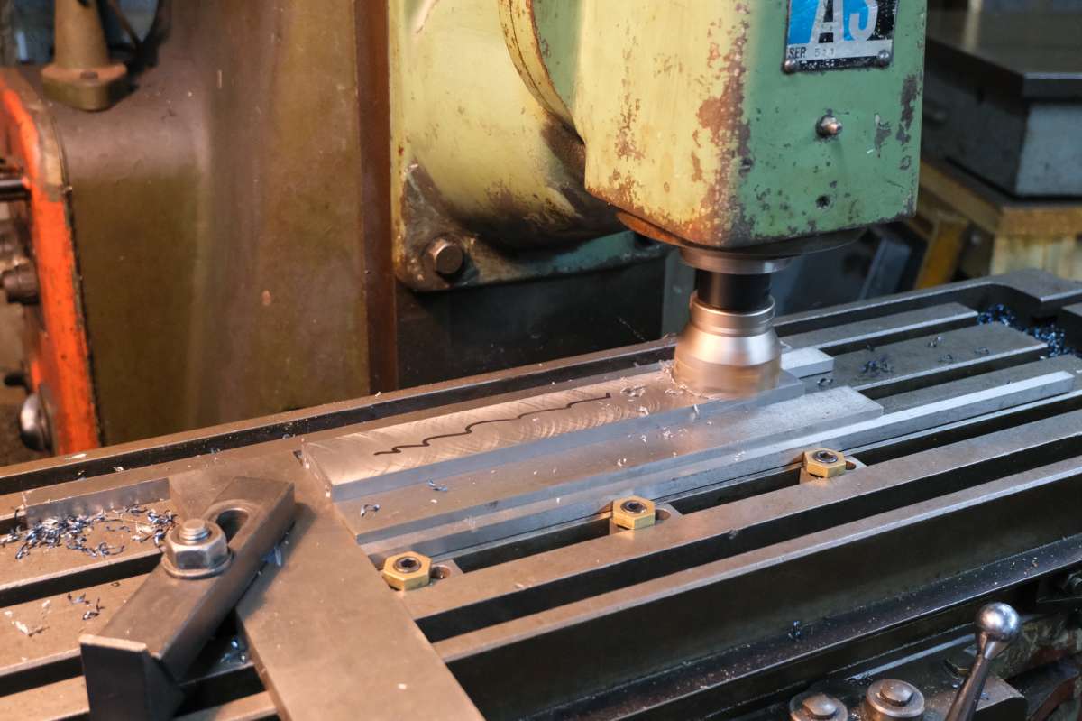

                          On JasonB Said:
                          A lot will depend on the power and rigidity of the machine you are running….
                          If not using a hobby mill then one can let rip. This is a 63mm diameter face mill and APMT inserts, from Arc, machining hot rolled steel:
                          Milling - Resized
                          Parameters were 420rpm, depth of cut 2.5mm (one turn of the handle), width of cut 48mm and feedrate of 430mm/min. The face mill has five inserts so that equate to a chip load of 0.2mm/tooth and a cutting speed of 83m/min. Removal rate is about 3.1 cubic inches per minute, comfortably below the capability of the mill. The mill is 1970s and designed for HSS cutters. Consequently it runs out of feedrate when using carbide insert face mills. I have been impressed by how well the inserts from Arc have performed.
