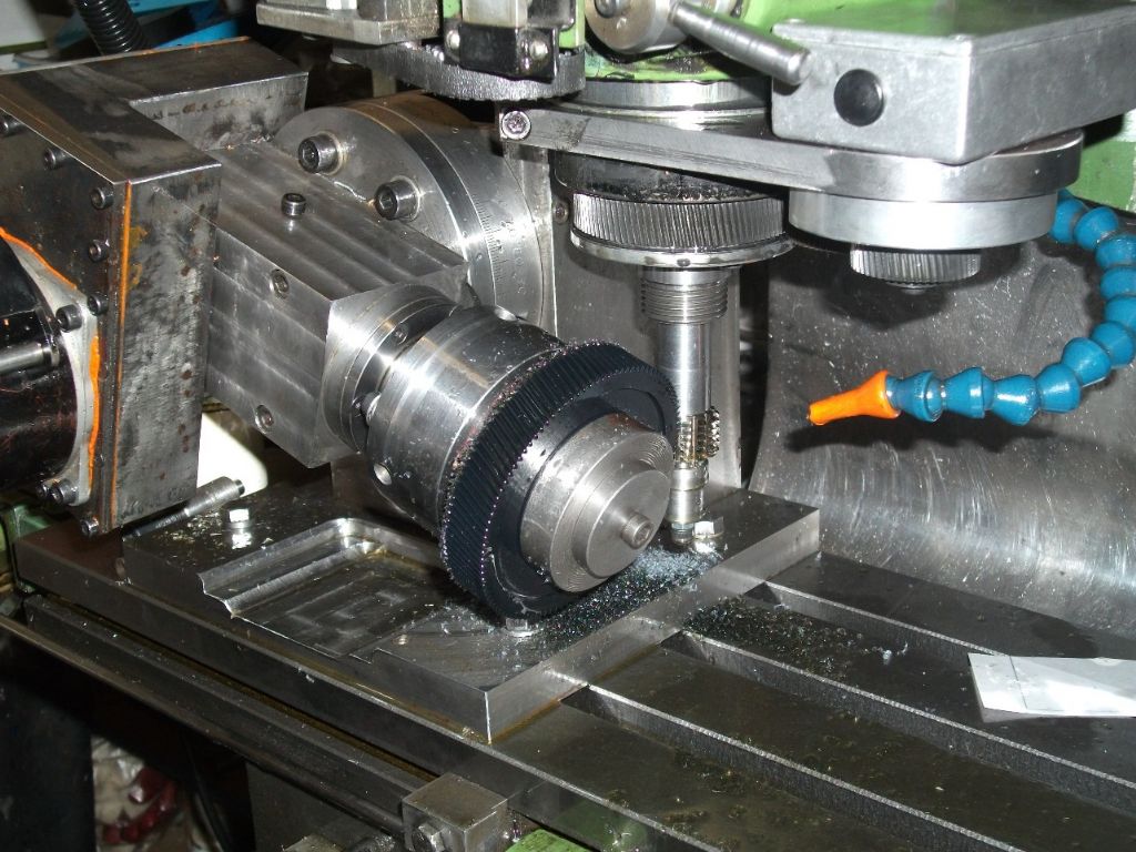

      Graham Williams 11
        @grahamwilliams11
        Got no worries about the use of a steel gear. Bikes fitted with manual a/r magnetos were fitted with steel gears as far as I remember ( based on the Clubman Viper my riding mate had) and the second hand BTH mag and wheel sourced by a local dealer that I fitted to my Viper.
        The slight mismatch between module and DP was the worry as I'm no gear specialist just a t***t a**e and making the gear is keeping me away from her indoors who's decorating the kitchen.
        Is there a Velo enthusiast out there who's desperate for a mag wheel that's willing to do an extended test, can let him/her have one cheap Lol.
        Thanks for all your advice guys

          I have made a lot of helical gears for stationary engine,timing and sideshaft,and one or two magdyno geas. What I have learnt is I now ask the customer if it is to drive a reconditioned magneto after one customer complained of gear wear,the mag was very difficult to turn the bearings were far too tight, Do not mix gears with different pressure angles ,fine teeth will really whine, eg Gardner ) 0 gas engine 14 dp ,not my gears. On course gears eg 10 and 8 dp where the engine has been well corroded in the past and the mag gear is missing ,pressure angle gears can be mixed as they run so slow. and hit and miss igniton will drown any noise.Do NOT cut the teeth at an angle they must be spiral cut, I would not use any soft material eg ali and tufnol ,try to use similar steel and the hardness of the original ,particularly when dealing with high perfomance Velo engine, they knew what the were doing. using a very close module gear does work sometimes as the difference is so small and all form gear cutters are a compromise.When copy ing spiral gears on a universal mill ,set up the spiral lead attach the old gear or a borrowed genuine gear, set a small dial gauge to a tooth and wind the table handle to ensurethat your gears are set up correctly spirals set to the various tables in Machineries handbook,sometimes a bit of adjustment of the gear ratios is worth trying to get the spiral the same or very close to the original.

            Wonder what a small gear hobber will cost to make……….. where is this going?
            An article published in MEW 193 Sept 2012 Shows an electronic system
            which is still available from Richard Bartlett ,as of last year he still had 12 of these
            available in pcb form.The article show the mechanical parts that i made and will cut
            spur and helical gears of any tooth number.
            Obviously this requires some amount of work and expense to complete to make
            this unit and also finding an 0.8 mod or 32 dp hob.
            These here sell hobs i have not bought from them so have no experience
            of their service.
            https://www.aliexpress.com/w/wholesale-gear-hobs-for-sale.html
            Without knowing the exact specification of the gear ie 0.8 mod or 32 dp if the gears
            can be hobbed the 0.8 can be cut using the pcd of the 32 dp ,i doubt you would be
            able to tell the difference as the error will be less than the backlash.
            The photo here is a 0.8 mod 17.5 deg helical gear for an align powerdrive unit.
            The gear in your photo appears to have some damage on the flanks not unlike
            the descriptions shown here in the second photo taken from a gear book, the
            descriptions of abrasion and scuffing would seem to apply.
            For this reason it would be unwise to make and fit some fudged gear and hope that
            it will run in.

            Graham Williams 11
              @grahamwilliams11
              Thanks John and Nigel. Decided to cut the teeth as before but with the correct handed helix and as a test before trying it on a bike (no takers on a Velo enthusiast to try it out for me LoL) I'm going to make a test rig with an old intermediate gear driving the mag gear (will have to provide some resistance somewhere) and see if I can detect any of the potential problems outlined. After that may well look at a hobber as the next project after refurbing an old Mills aero engine as I'm giving the locos a rest for now.
