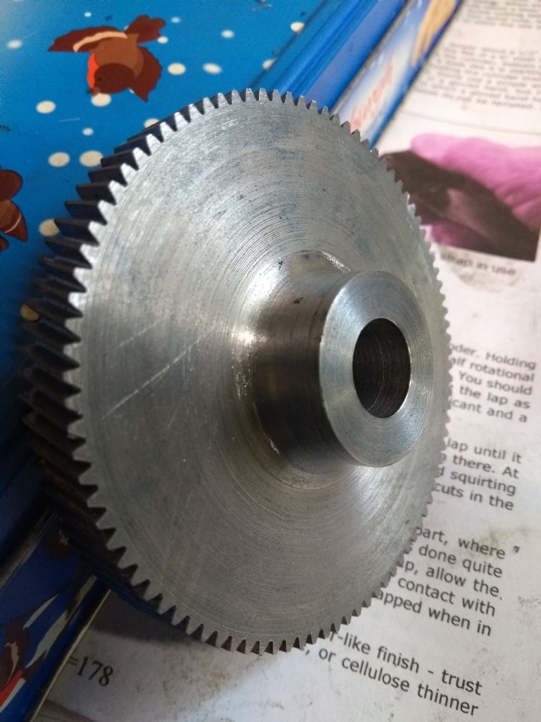

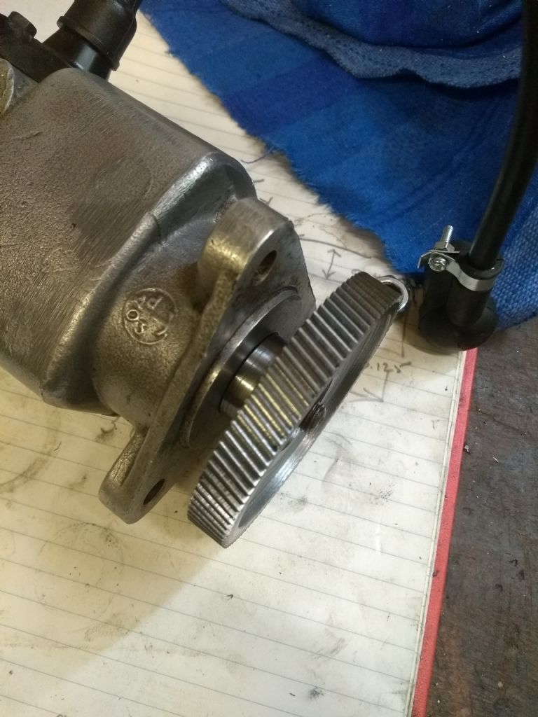

                              Made a gear today but the 'not' deliberate mistake gave me RH helix, 92 teeth cut, what fun, must pay more attention.. LoL

                                    Thanks for the 'how to' so put a couple of photos of the one I made (incorrectly) today.

                                        That's a good looking gear and, frankly, I wonder if for a gear with that many teeth and such a shallow angle one would really be able to tell the difference between one that has been cut straight across at an angle and one that has been cut in the correct helical fashion.

                                          Rod.
                                          In the Velobanjoagent link posted above you can see what Velocette's thinking was at the time, i.e they believed it gave quieter running but that with more modern gear manufacturing methods the same result could be achieved. However having said that they didn't change the gears on any of the singles at all as far as I'm aware once having made the change to helical teeth from the early straight teeth gears. Very quirky bikes are Velocettes, I won't get into the 'famous' clutch as many Velo fans will well know LoL
