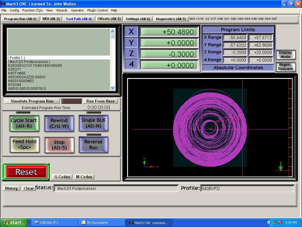

        Hi
        I am just starting out on cnc and trying to use 2DCut to generate G code for Mach3.
        I have tried several projects, some from dxf files and others drawn in 2Dcut but all with the same result.
        All seems well in the 2DCut programme, the preview works OK. It saves the Gcode as a text file, when I load this into Mach3 there are masses of circular tool paths As can be seen in the above screen shot.. The actual tool paths wanted are in there (red lines) but obviously something is a miss.
        Anyone using Vectric 2DCut and Mach3? Any ideas of what the problem is.
        Incidentally I have used Meshcam to machine some test 3D shapes without any problem so I am sure this is to do with how 2DCut is processing the Gcode.
        Any help appreciated.

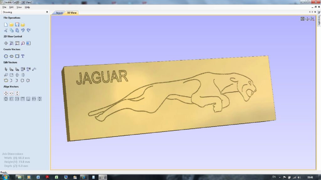

          Here is a Preview from Vectric showing what the expected result should be.
          Cheers.
          Nigel

            Nigel,
            Have you got the post processor definitely set to Mach2/3 mm (or inch)? The choice is in the drop box immediately above the Save Toolpaths button. I’ve been using Cut2D with Mach 3 for the past year and it has always worked well with no interface problems with Mach3 on a KX1 mill.
            Jim.
            #76069
            John Stevenson 1
              @johnstevenson1
              Nigel,
              I wish I had a pound for every time I have answered this question.
              In Mach3 go to the Config menu on the top line, select General Config and in second block from the left 2 down ? there are two radio buttons for Arcs.
              You will have absolute selected, change this to incremental, close the program, reopen and jobs a good un.
              As Jim says you need the correct post processor.

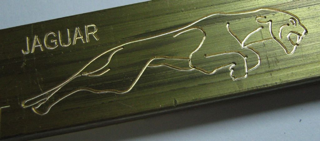

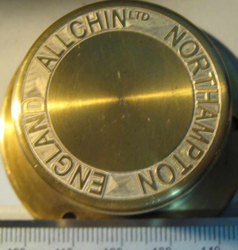

                                      Result
                                      1st Vectric 2DCut engrave
                                      2nd Vectric 2DCut – pocket mill
                                      Allchin Front Wheel Hub
                                      Milling cutter 0.2mm x 20 deg engraving cutter, 8000 rpm, 200mm/min max.
                                      23500 lines of code.
                                      A liitle more conventional machine work to do then just need to infill with red enamel and polish
                                      Nigel
