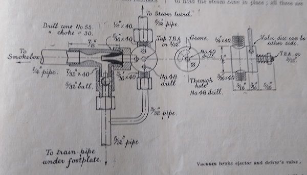

                        A few points from the discussion:
                        Not sure what you mean by "scent spray" do you mean it doesn't need much air?
                        No it works like one of those old fashioned sprays with a rubber bulb which you squeeze and it blows air through a venturi.
                        I think most of LBSC brake designs were steam brakes
                        Maisie was designed from the start with vacuum brakes in 1936/37
                        Like many designers LBSC often produced designs 'on paper' and so errors could creep in, however in the case of Maisie it was built to order and pictures of the original appear in the magazine text so if it is in there it at least worked for LBSC.
                        Looking at the drawing from the magazine in December 1936 I think that if you still have a leak from the control valve that could be destroying the vacuum and would be the first this I should try to eradicate.
                        (Apologies for the picture quality – a mobile phone image of a page in a bound volume 75 of ME)

                                The simplest way to check if the ejector is working is to take the pipes and valve off and connect to the compressor.
                                Put your thumb over the vacuum pipe and you will detect the vacuum being formed or not.
                                Before anyone comes up with safety issues remember that 20 inHg which is what I would expect a reasonable ejector to pull is less than 10psi – it is far less than putting your finger on a bike pump and pulling the handle.

                                      The original design was for simple working where applying steam to the ejector evacuates the train pipe and applies the brakes. It is not automatic where a break in the train pipe applies the brakes so a reservoir is not part of the design and would in fact worsen its performance.
                                      Or to quote LBSC "Steam blows out of the steam cone into the choke, extracting the air from the train pipe and 'plonking 'em on' with great alacrity"
                                      He could be argumentative and he might have had his failings as an engineer at times, but his writings were always readable!

                                        Just had a thought (only the one!) If the system were to be set up with a reservoir and valves for automatic working the ejector evacuates the reservoir(s) releasing the brakes and you proceed. When you want to stop you allow atmospheric air into the system which applies the brakes. When you go again you empty the system – This is not by any means instant on our club's 7¼" vacuum braked locos and rolling stock.
                                        With a simple vacuum brake you need a vacuum there instantly and hard to apply the brakes. I wonder if your commercial ejector is designed for an automatic system where the vacuum is built up over a few moments but it cannot provide an instant vacuum on demand – ie it may just be too small.
                                        It might be interesting to compare your commercial ejector which may well be adequate for an automatic system with the one LBSC drew?
                                        Just a thought

                                        #482098
                                        Paul Kemp
                                          @paulkemp46892
                                          Nick,
                                          Thanks for that, confirms my thoughts from looking at the valve drawing. Need to be careful "plonking" em on hard and fast with a Maisie though, not a massive amount of adhesion so with a train a recipe for flats on the wheels unless the stock is similarly fitted – in which case there would likely be a significant lag in application.
