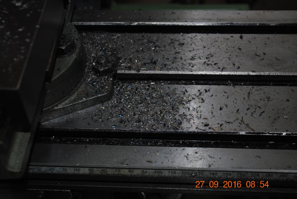

                                                Tried a brand new 4 flute cutter today & with only a light cut the machine would have danced all round the workshop if not bolted down. I have not done anything with the gib strips yet as I have only just found the manual but I am not holding my breath.They feel fairly tight. I was using a 12mm HSS cutter cutting about 1-1.5mm deep * 4mm wide at 600 to 750RPM with 1 turn of the wheel every 2-3 seconds. Somehow the 2 flute one seemed just as good
                                                Something definitely wrong. Wife has arranged for me to see a professional machinist next week ( husband of one of her golf friends) & he has offered to show me how to do this, so hopefully this will sort the problem

                                                  Sam can you post a close up of the ends of your cutters and tell us where they came from. Although they may be new they may not be good to start with.
                                                  Are you getting nice chips like in the videos that I posted or more like iron filings?

                                                      Posted by JasonB on 26/09/2016 18:46:03:
                                                      Jason

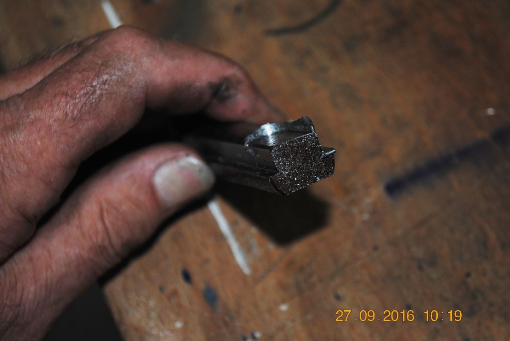

                                                      I am really having a " bad hair day" today. Seems that I may have done some damage to the new milling machine although I do not know what.
                                                      First here are the pictures
                                                      I then went to photo the cutters & realised that the brand new 4 flute cutter now has 2 chunks out of it so i threw the piece of steel & changed back to the 2 flute cutter ( From Tracy tools)
                                                      I then remembered that I had a couple of metres of free turning steel rod & when I looked at it i found that I could get my T nuts out of the round. So I cut off 4 inches & began working on it. I have to say it was a lot better & at 650 RPM & with gib strips V tight & small cuts I was doing OK. Then I got to the top part & because I was using an old HSS cutter as a parallel the top sat below the vice so to avoid hitting the jaws I needed to run the cutter between them & take a full width cut. But as this was part of a round & only 2,8mm at the highest & only 12mm wide & as a 2 flute cutter is supposed to be ok for slots I decided to take it off in one go
                                                      Going very slow I was doing OK then as I turned to dip the brush in some oil the mill stopped dead.
                                                      When I removed the work it would only run at very slow revs & V noisy. I changed from slow to high gear & it ran OK . When I went back to low gear it now runs OK again but it may be that I have stripped a tooth off the infamous plastic cog. Will have to go on the Warco thread to ask forumites for advice on that one me thinks
                                                      Here is a picture of the offending bit of steel & you can see the cut which is by no means large. It was clamped across the width with a pack under the wide flat & the part I was cutting was below the top of the jaws hence I took the full width cut so as to miss the jaws
