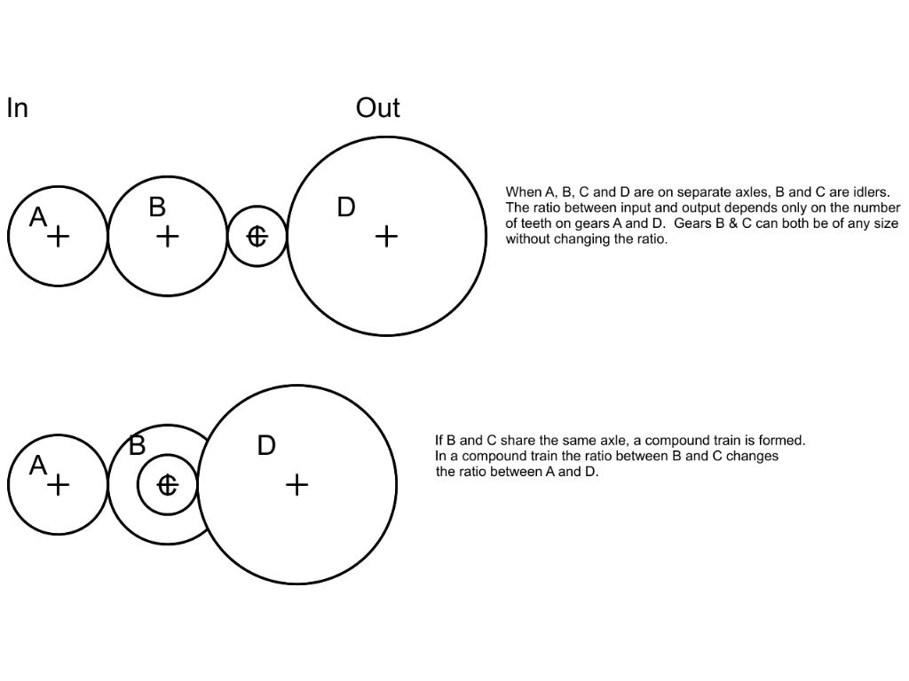

                    You have the maths right. But if you try that, I doubt you will able to get C and D to mesh. The shaft holding D will collide with B.
                    IF your lathe is like mine, you can remove the B/C key and reduce the system to three gears, all in the same plane. Then it is as others have described – A needs to have twice the number of teeth as D. The simplest solution would be that with a single (any that fits) gear between

                          There's two ways of connecting 4 gears:
                          Neil's right to comment because I was ambiguous! In the first case the two idlers (B & C) can both have any number of teeth.
                          The second case is more likely on a lathe banjo, it's a compound. B and C can still be any size for a simple ratio between A and D provided they're both the same. If they're not the same all the ratios have to be taken into account.
                          Maybe worth mentioning that idlers are often used to reverse direction of rotation between shafts. On a lathe you have to get the ratio right and finish the train with the lead-screw turning the right way. Normally the compound set-up on a lathe banjo gets this right for you.
