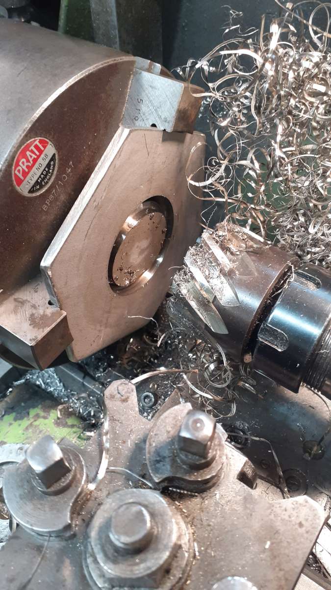

                          Martin Connelly
                            @martinconnelly55370
                            Today’s parts. I am making a couple of rings for a friend, 2 in 6mm mild steel and 2 in 5mm stainless. They need boring out to Ø74 so the first thing to do on the supplied material is to cut out a Ø50 hole with a broaching cutter. Cycle time for this was about 4 minutes. 106rpm (back gear). Roebuck RB7 cutting compound brushed onto the surface for initial cutting then just keep the pressure on until through. The cutter was held in a Ø19 ER32 collet in the lathe’s MT2 tailstock and hand fed.
                            20240111_104104
                            Martin C

                              Thanks for the information, Martin.
                              I’ve got 3/4” as well as 19mm ER32 collets, so when I get an annular cutter or two I’ll be trying them out on the mill. I can’t use them in the lathe yet because my ER32 chuck is R8 not MT, and I haven’t made an MT arbor.

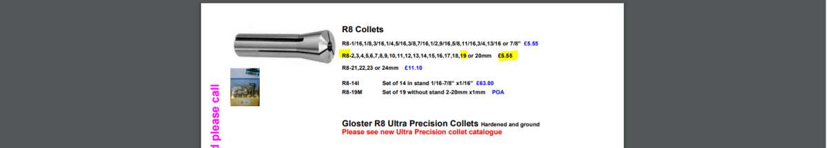

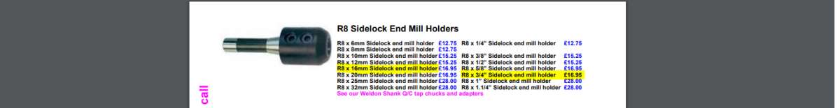

                                        On JasonB Said:
                                        I would have thought a blank end arbor bored and with two grub screws was the most secure as I don’t think you can get weldon type side lock in 3/4″ on MT3 or R8
                                        I don’t have anything R8, but would one of these be suitable; Gloster Tooling
                                        image_2024-01-11_190846730
                                        image_2024-01-11_191037360
                                        image_2024-01-11_191526015
                                        Bill

                                            Thanks for the further replies.
                                            Bill, Gloster Tooling don’t currently have a 3/4″ sidelock endmill holder.
                                            The problem with these R8 endmill holders (and I have a few in various sizes) is that the set screw position doesn’t always correspond with how far you want or need to insert the shank of your cutting tool, i.e. where the flat on it is. I’ve got a 1/4″ endmill holder, bought recently, and the set screw is way too far up the body of the arbor and way too big (M12!). I’ve not yet got round to drilling and tapping for a set screw in a more sensible location. Hopefully the steel won’t be too hard.
                                            There’s a chance the set screw on a 3/4″ endmill holder like the one in Gloster Tooling’s catalogue will be in the right place for one of the flats on an annular cutter, but given the shortness of annular cutter shanks there’s a higher chance, I’d say, that the set screw position will be wrong.

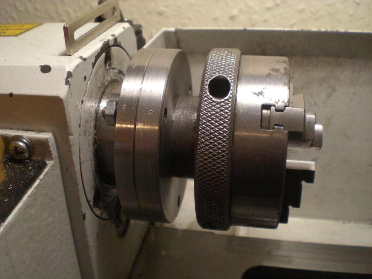

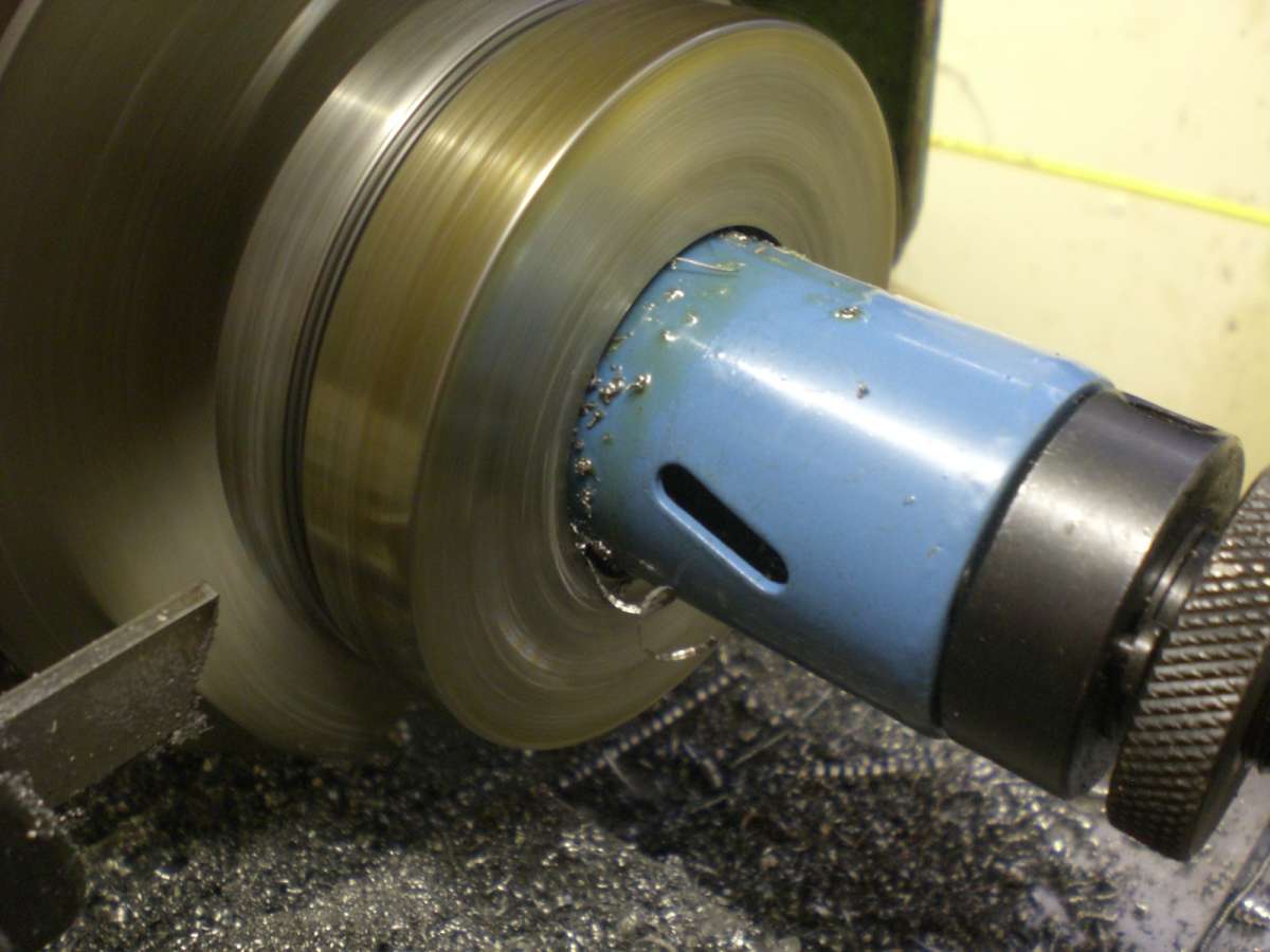

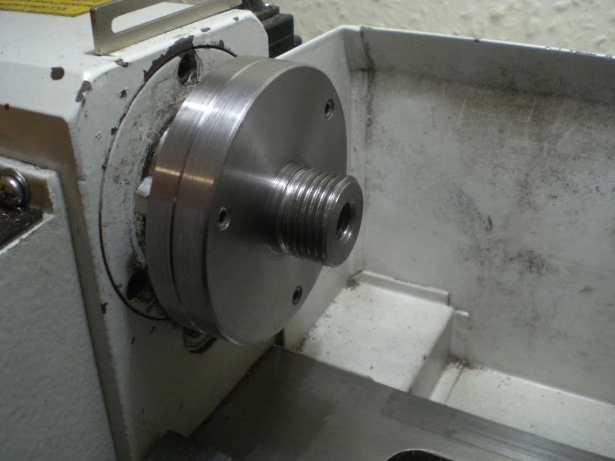

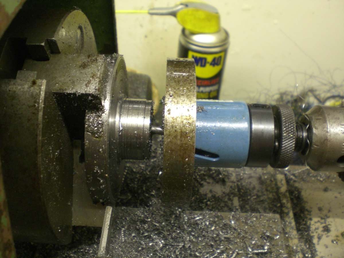

                                              Hi, I’ve used hole saws in the lathe tailstock to cut large holes, my last time was to cut a slice off a short length of 80mm diameter BMS, to a thickness of about 16mm. This was achieved by cutting a groove, using a parting tool, to a depth of the 38mm hole saw I was using, to end up with a spigot on the remaining piece.
                                              CIMG3121
                                              Parted
                                              This saved making a lot of swarf and gave me a large thick washer that was hiding in there.
                                              The other piece was then finished to size, and the spigot threaded to take a screw on three jaw chuck for my mini lathe.
                                              New chuck adapter
                                              3 inch chuck 2
                                              Regards Nick.
