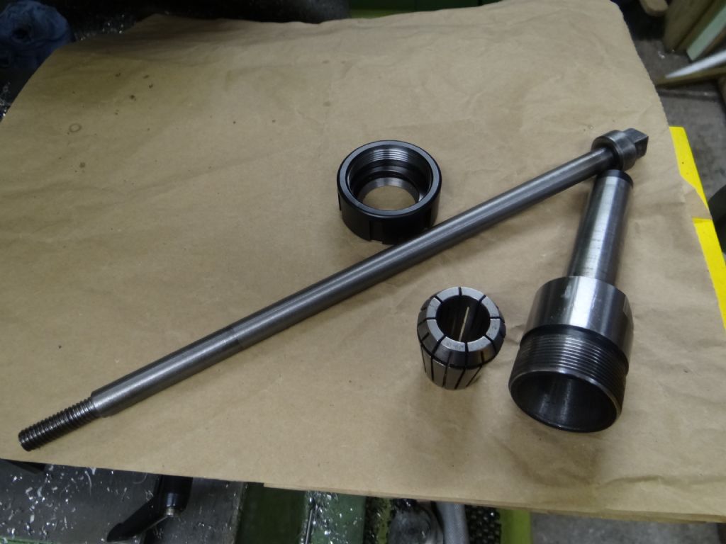

                                          Some pictures may help. These are of an ER32 collet chuck with an MT shank. ER32 is probably the most popular because of the range of collets it can hold 2-22mm.
                                          The chuck plugs into the spindle:
                                          And is clamped in position by a 'drawbar' – a long bolt, tightened at the top of the spindle. Nipped rather than tightened enthusiastically.
                                          In this simple system, the collet chuck is released by slackening the drawbar a couple of turns and then tapping it with a soft faced hammer. (I use an ordinary hammer and a bit of Aluminium as a cushion.)
                                          In bits:
                                          Most of my milling is done with ER32 collets because they conveniently take drills, cutters and anything else with a parallel shank like my slitting saw set. My collets are metric which makes them a tad awkward to use with some imperial diameters (more tightening than I'm comfortable with), so I have a Jacobs drill chuck as well. When a lot of different sized holes are needed the Jacobs is worth having because it's quicker changing drills than a collet system.
                                          When maximum space, rigidity &/or accuracy is wanted during cutting, it's advantageous to plug tools directly into the spindle rather than via a chuck. Fly cutting and boring are my main tasks where a chuck isn't suitable. Much depends on what you're doing, but I guess most hobbyists do most milling with ER collets.
