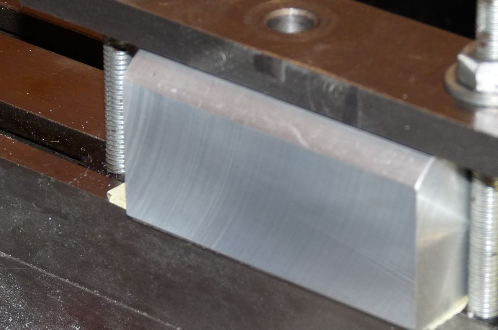

                  #334464
                    I quite often use a flycutter on smaller items and have never found it to be a problem, if the cutter is sharp and you don't go at it like a mad man they work well and in the long run will be far cheaper than milling cutters.
                    Bit of 5mm thick steel being cut earlier in teh week
                    Edited By JasonB on 30/12/2017 13:11:31

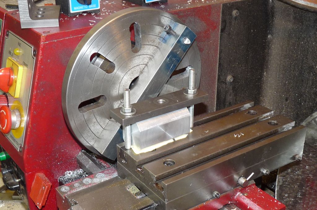

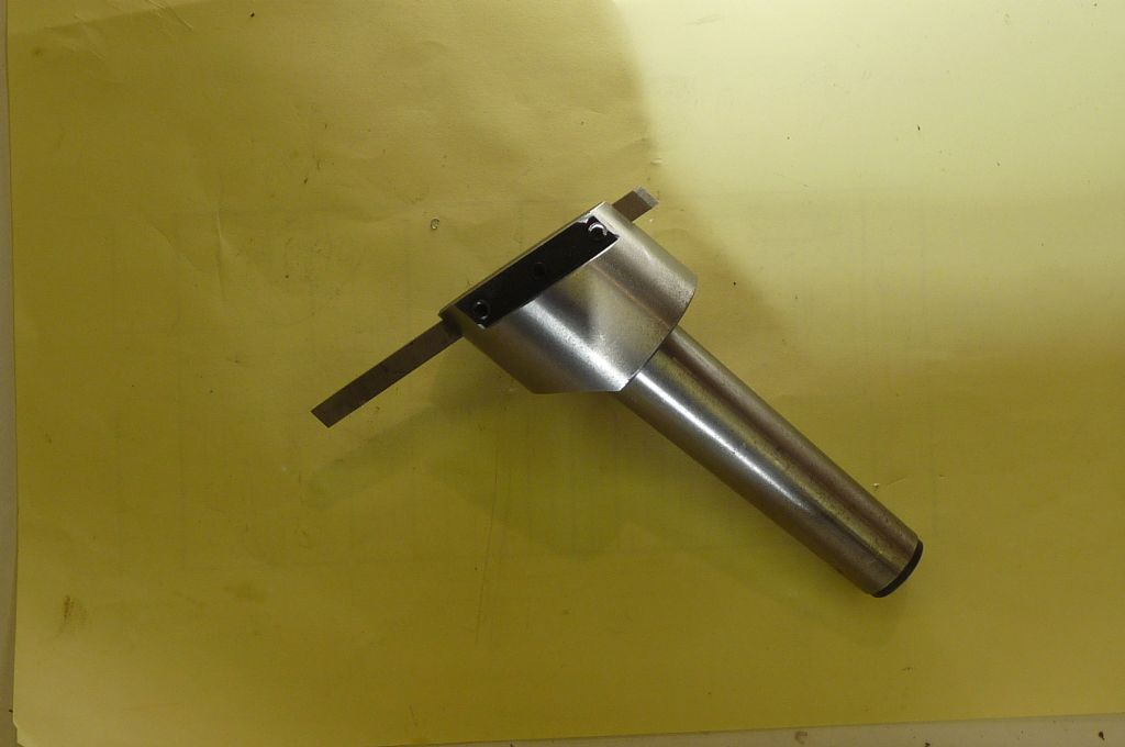

                    Steve Withnell
                      @stevewithnell34426
                      My first lesson using a flycutter was that the typical ones sold on eBay don't have anywhere near enough rigidity or mass for anything only the lightest of work. I 'made' one one by bolting 25mm square bar (with a piece of 10mm silver steel as a cutter) to the 250mm face plate on my lathe and used that to face off some large chunks off ally. I don't think the finish would have been as good on the mill.
                      Regards
                      Steve
                      #334480
                      Emgee
                        @emgee
                        Another advantage of the faceplate mounted bar is that a second cutter can be added to the other end at a smaller radius so providing means of a finishing cut by projecting a few thou more than the other "roughing" cutter.
                        Emgee
