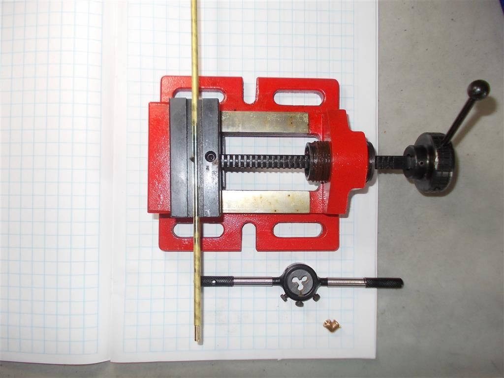

    Brian John
      @brianjohn93961
      UPDATE : My new heavier vice with the V notches arrived so I have put the brass tube in that and tried again. Still no luck as the tube keeps turning. I have got about two turns of thread cut on the tube but I cannot get any more. I am not sure what to try next. I was really not expecting to have any problems using dies : I thought using taps would be the big problem. I must be doing something wrong as some people said I should not need a vice at all ?
      Edited By Brian John on 12/05/2014 06:11:22

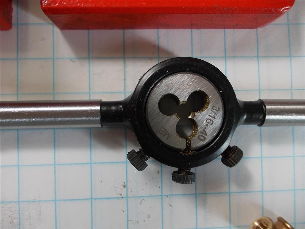

            Brian,
            Given that the depth of thread at 40tpi is only about 16thou … Yes, I would have thought it possible.
            … I would guess that the die is undersize and/or not sharp.
            Any chance you could post some close-up photos of the die, and your results with it ?
            P.S.
            It might be worth acquiring some "surplus" knitting needles, in a range of sizes around 3/16" and finding out how small you need to go before you CAN cut a thread with that die.
            Edited By Michael Gilligan on 12/05/2014 11:10:26

                a possibility is that there is a burr on the die where the screws are supposed to engage, and on the split. i have had to remove same off quite a few dies using an oilstone. the other possibility is that the screw for the split in the die (in the die holder) hasnt got a long enough thread on it and isnt totally enlarging the die.
                just a few off the wall thoughts from experience.

                  Tomorrow, I will try enlarging the die with the centre screw and have another go. I did not think that the centre screw would enlarge the die enough to make any difference but obviously it does.
                  Edited By Brian John on 13/05/2014 06:02:11
                  #152344
                  Rick Kirkland 1
                    @rickkirkland1
                    Brian, you are right in thinking the centre screw makes that much difference. In fact on a decent quality split die the adjusting screws can make a difference between a thread which is too large to enter the nut and one which is too small to be of any usefull mechanical strength and all this without causing the die to break in two. Cheap dies are sometimes not even hardened let alone tempered for correct use and I have known them to have no relief whatsoever thus causing binding problems and chewed up threads.

                      Have you checked the clearance of o/d of die to i/d of the holder ? I've had holders that would not allow the die to expand,. die o/ds and holder i/ds do seem to vary. Apologies if I'm beeing simplistic.

                          Success…I think ! I opened the die out as much as I could using the centre screw. I was still having problems with the brass tube turning in the vice but I persevered by turning the die stock back and forwards about 10 degrees left and right ( a see sawing movement). Eventually, things became easier. I overdid it a bit as you can see : far too many threads
                          I think all my problems were caused by incorrectly fitting the die to the diestock the first time. As others pointed out, the centre screw was in the wrong place and this closed the die up too much.
                          1. Is that new vice okay ? As you can see from the top view the red base is not quite parallel with the jaws. I am not sure if this affects its grip ?
                          2. I have put a machined ell piece ( by PM Research) on the brass tube but it only goes on about two full turns. This seems to be the norm when buying machined parts as I have tested some of their other fittings with each other. These are straight pipe, not MTP. I thought they should screw on further than that ?
                          3. How do you clean all the filings from the die once you have finished with it ?
                          Edited By Brian John on 14/05/2014 06:04:23
                          Edited By Brian John on 14/05/2014 06:08:24

                            It looks like you are making progress now, Brian; although I would have expected the pipe to screw further into the fitting [perhaps six threads?]
                            If you now loosen the centre screw a little, and tighten the outer pair, it will reduce the diameter of your thread.
                            I see that the fittings are made to the Unified form [60°], whereas your ME Die would be Whitworth form [55°]. … This should be no problem, so it's probably just that your thread is a couple of thou' oversize. You have plenty of thread on your test-piece, so have a go.

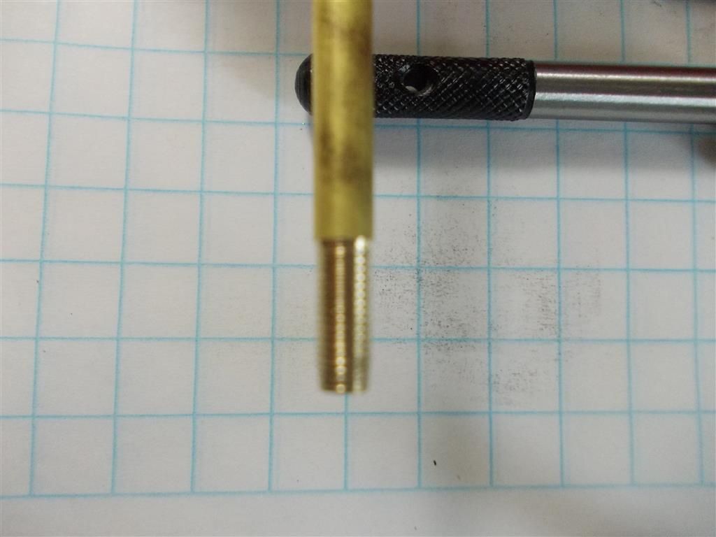

                                Brian,
                                Could you please measure the outside diameter of that thread that you have cut.
                                It may be an illusion, but it looks considerably smaller than the OD of the pipe … which would explain why you are having difficulty cutting it, but not why it doesn't screw into the fitting.
                                Dreadful thought: are you certain that the fitting is 40tpi ?
                                #152447
                                Brian John
                                  @brianjohn93961
                                  Outside diameter of the pipe = 4.73mm
                                  Outside diameter of the thread = 4.59 to 4.64 (It varies according to where I measure it. I think this would be caused by making adjustments to the centre screw.)
