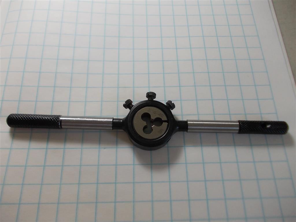

      I have posted many questions on taps (quality and how to use them) but I have never asked about dies. I thought they would be simple to use ! I have some 3/16'' copper and brass tubing and I need to put a 3/16-40 thread on them ; they are to be used for live steam plumbing on a stationary steam engine.
      I put the tubing in a small vice ; the tubing was wrapped in leather so as not to mark it. But I cannot get the die to cut. I am cutting from the side with the stamp ''3/16-40''. The other problem I am having is keeping the tubing from moving; I do not think the leather provides enough grip. I have ordered a larger vice with horizontal and vertical V notches to better hold the pipe but it has not arrived yet.
      The dies are CS and purchased from Tracy Tools. The die holder just arrived today. It was purchased from ebay (''Faithful'' brand). There are some photos here. Have I got it set up correctly ?

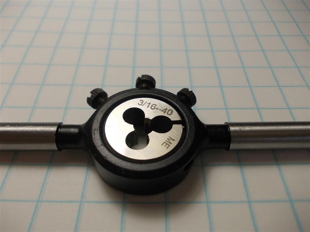

          Brian,
          Try rotating that die so that the middle screw engages the split.
          Loosen the two outer screws and tighten the middle one, to spread the die open a little … Don't over-do this, or you could break the die [it depends how accurately the die and the holder are made] … then tighten the two outer screws and proceed. ___ If the resulting thread is slightly over-size, loosen the middle screw and re-tighten the outer ones, then go over it again.
          It's also worth lubricating the work with Rocol RTD "tapping compound" … Copper is can sometimes be nasty stuff to thread.

              You also need to have reasonably thick wall tube, something like the KS range brass tube is too thin but the stuff sold by the ME suppliers should be OK if the right gauge.
              I don't find copper tube too hard to thread, its more of an issue to tap.
              Also worth pointing out that dies have a lead taper much like a taper tap so make sure you use the right side, its usually the one with teh writing on it.

                            Brian,
                            This seems a very strong indication that the Die is adjusted much too small [which is quite likely, the way you have it installed] … either that, or the tube is over-size !
                            With everything set correctly, I would expect to be able to thread 3/16" 40 tpi comfortably, without the job slipping …

                                                If you have turned the die round so the centre screw is in the slot ( it should be tapered ) and screwed in to open up the die and the pipe is the right od you shouldn't have a problem, once you have thread on the pipe screw the centre one out 1/4 of a turn and run the other 2 screws up and keep doing till its the right size,
                                                Hope this helps

                                                  Hi – Just a thought – have you tried a mic. on the tube to make sure it is in fact 3/16 and not 5mm – I had similar problem with on line supply of copper rod (3/16 listed and ordered but 5mm sent)
                                                  #151819
                                                  Brian John
                                                    @brianjohn93961
                                                    The pipe was order from the US so I am sure it will be 3/16 inch. I will check it now : 4.64mm
                                                    Edited By Brian John on 08/05/2014 10:54:42
                                                    #151824
                                                      Posted by Brian John on 08/05/2014 10:54:16:
                                                      So, it's actually slightly undersize !!
                                                      … Sould be easy with the right tools and technique.
