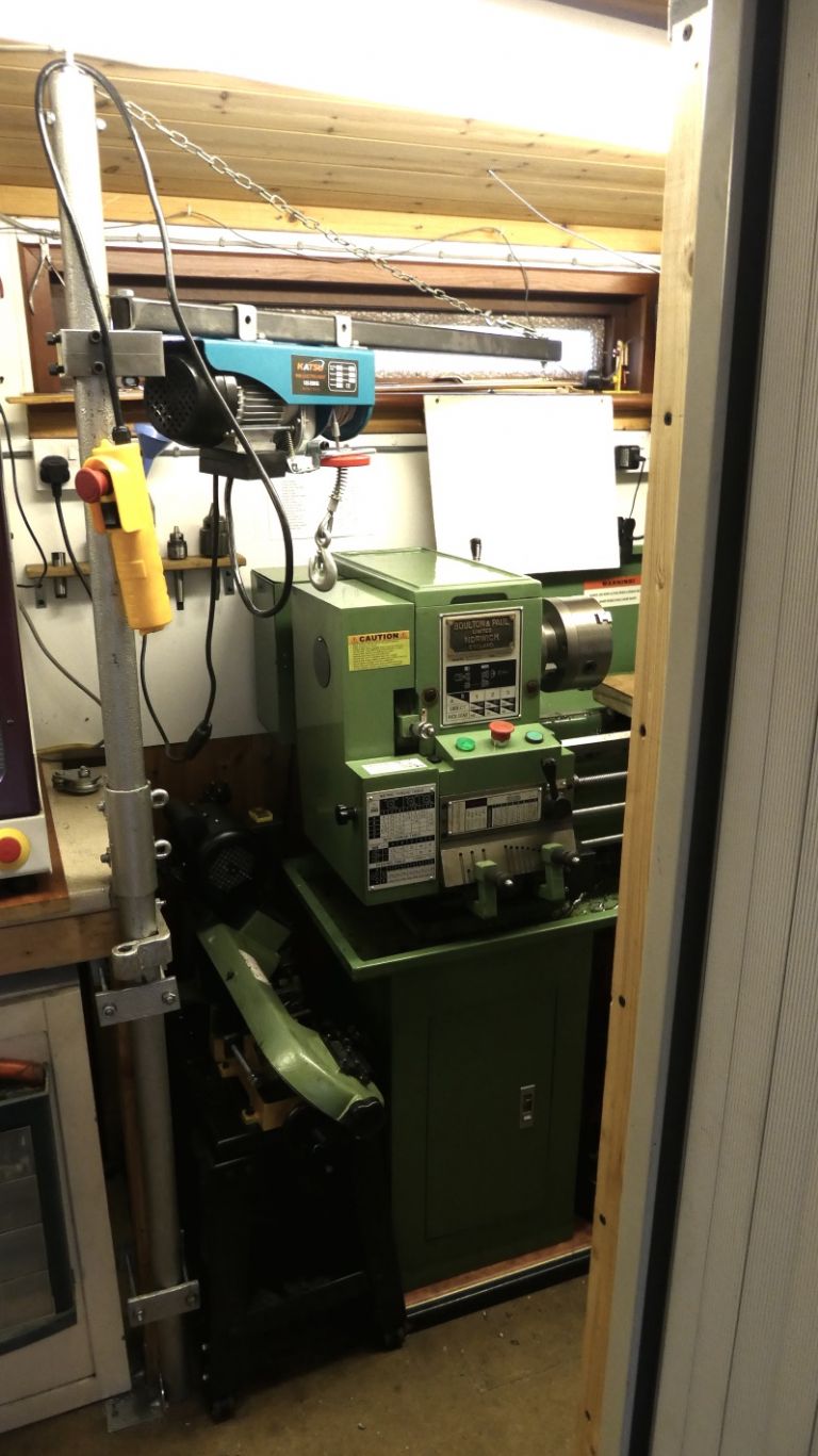

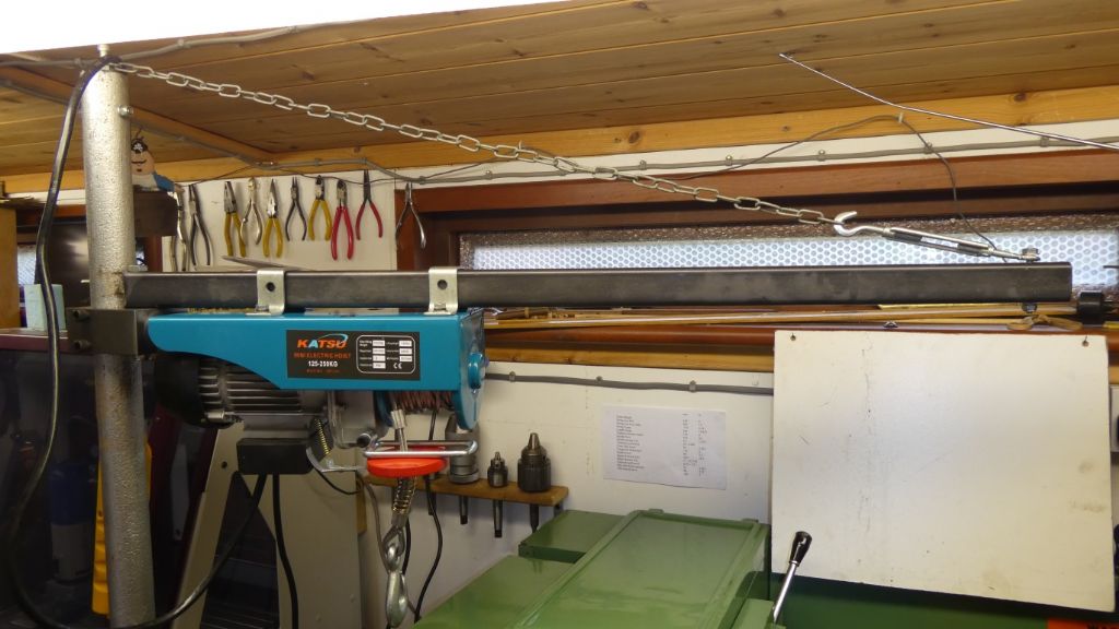

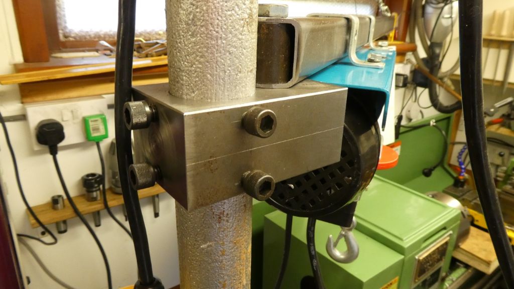

      My reconstructed spine restricts me to a max 5kg lift. Both chucks on the new lathe exceed that – in fact the 8” four jaw with back plate is far to heavy for me to lift safely at 15.5 kg.
      An overhead hoist was out of the question as the timber ceiling/roof is not strong enough to support any sort of weight so I have constructed a hoist where the weight bears partly on the floor and partly against a bench with a small electric winch from ebay doing the lifting.
      I used an old Victorian barn door hinge to help brace the scaffold pole against the direction of lift.
      I pinched the braced jib idea from a commercially available design but as I already had suitable materials to hand I made my own.

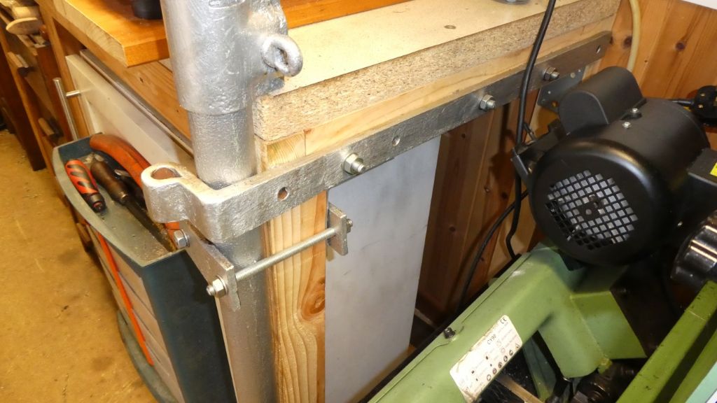

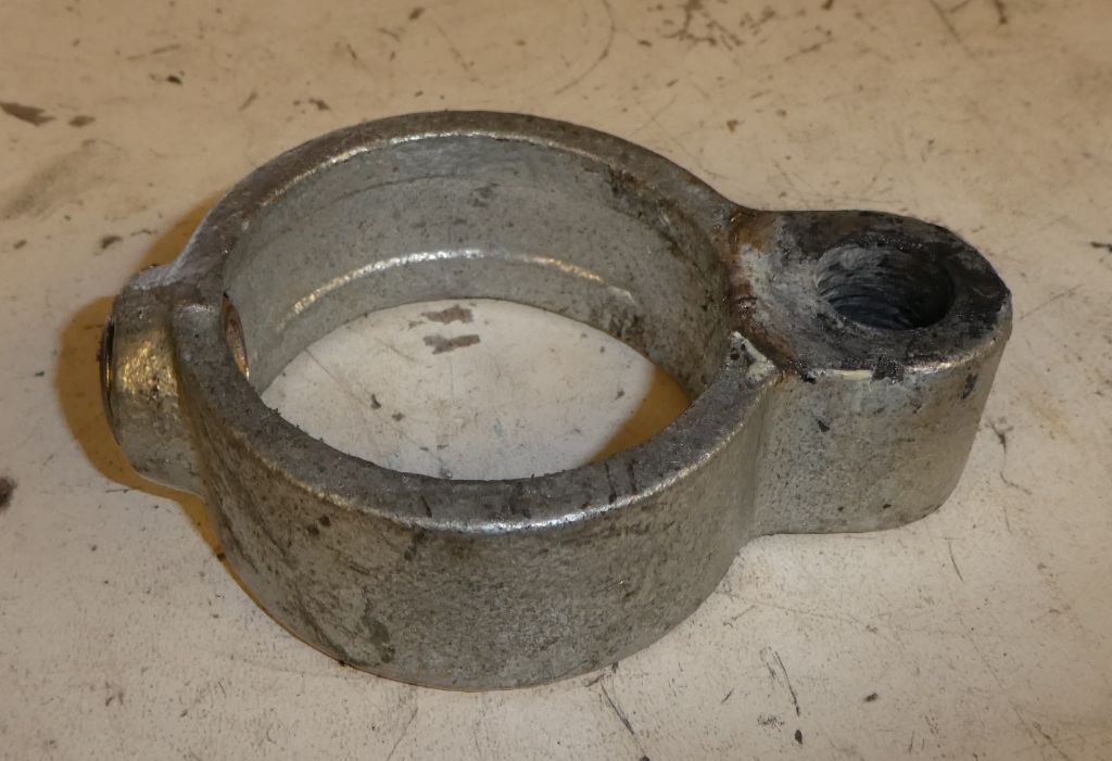

      On the first attempt I used a scaffold gate hinge clip as the main jib pivot but it did not work very well – everything was very wobbly even when the clip was supported from below with a second scaffold clip which is still there but now redundant.
      So I replaced the gate hinge clip with a block I made from a lump of 70 x 50 MS secured to the scaffold pole with six 3/8” Whitworth UNBRAKO cap heads and that works very nicely.
      Making the block offered a good chance to check out the lathes capabilities by boring the hole to suit the scaffold pole. This was done with the lathe in back gear set at the lowest speed and feed to prevent the lathe from jumping up and down with the off centre workpiece. After going through with a 20mm drill each roughing pass was done by applying a cut of 100” depth which opened the hole out by .200” each pass. It did not take long to get to size. I think it could have handled a deeper cut but I like to do machining by feel and in this case I felt comfortable. So the boring bit?………….
      **LINK**
      ………..and up she goes!

          Just watched your video -looks good. If you add a pulley block to the cable and anchor the hook back onto the hoist it will run at half speed when lifting and lowering – that will make it safer and lessen the snatch as it first lifts
          .Martin
          #316258
          Rik Shaw
            @rikshaw
            Thanks Martin for reminding me there was a pulley block in the factory carton – I'd quite forgotten it was there. Of course as you suggested with it now fitted the lift is far less snatchier – good thinking!

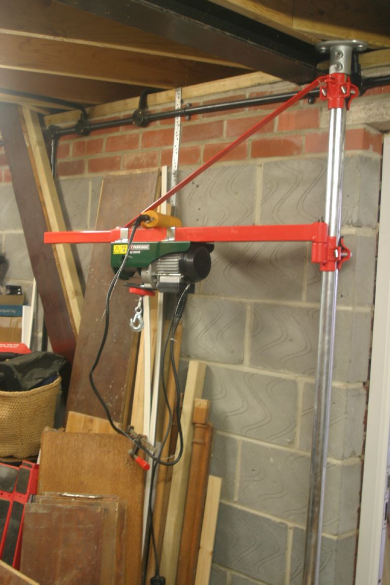

              I built my own hoist powered by the motor from a garage door opener, it runs on an overhead rail made of two bits of angle iron back to back and welded, and uses 4 ball raced as wheels. I have an 18V DC supply around the workshop, and the hoist uses this although it is actually a 36V motor. The load is taken on the RH chain fall. The drive from the motor to the chain sprocket is via a bit of bike chain with a 4:1 reduction.
              Ian S C

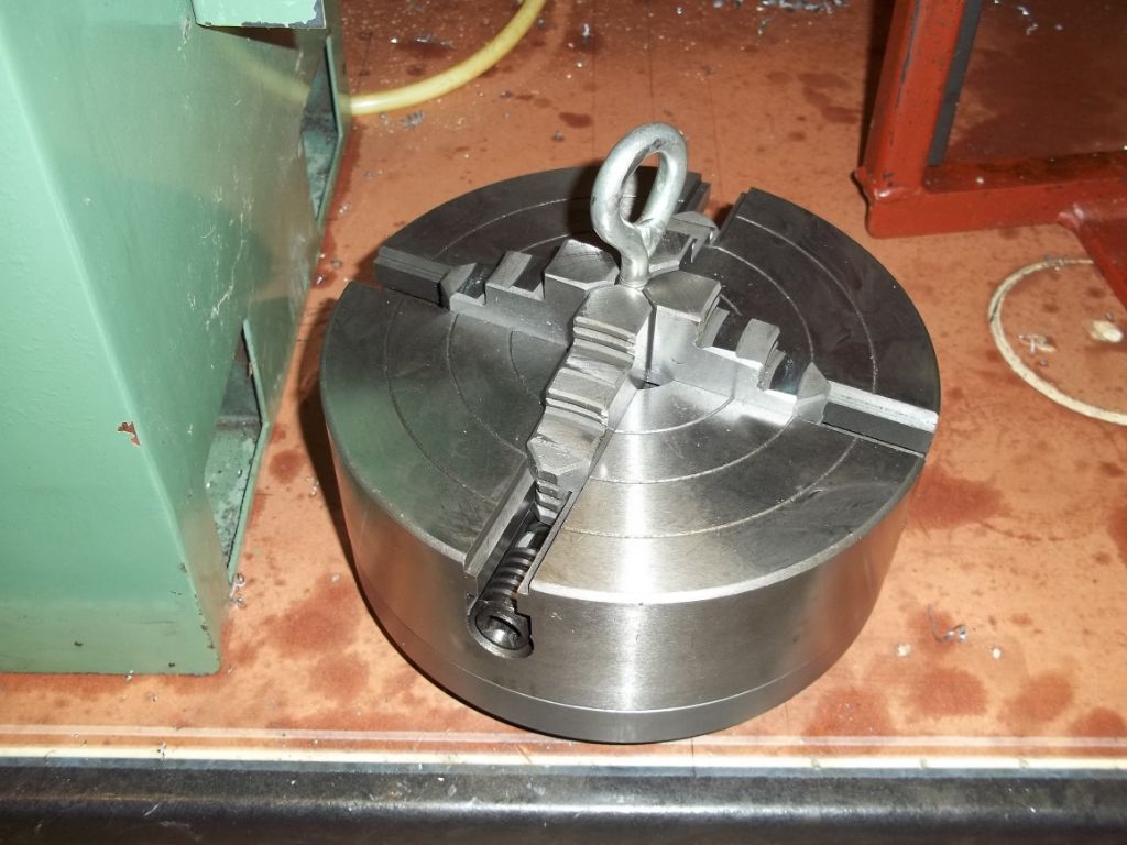

                                          Can I suggest that when lifting a chuck as shown in the early picture – with a ring-bolt held in the jaws – you ensure that the thread of the ring-bolt goes through the jaws and you add a nut on that side?
                                          More of a fiddle, but … anyone who is not strong enough to lift the chuck might also have difficulty tightening it enough. And if it is a heavy chuck it will do no good at all as it hurtles against you / lathe bed / spindle nose / toolpost.
                                          I'm sure you all thought of this, but did you?

                                                      My origional hoist was a 5:1 block and tackle on the same over head rail, and that worked well enough. The chucks are 8", but seem to get hievier each year. This is the chuck in the lifting attitude.  the box hanging to the left of the chain is the control box.
