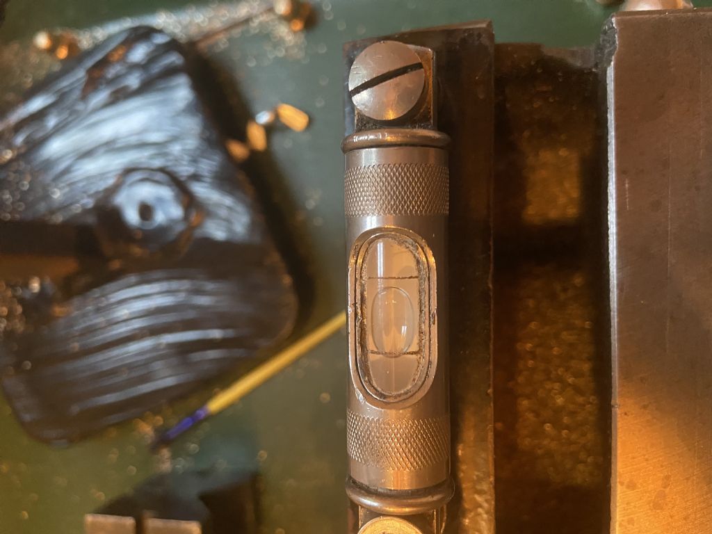

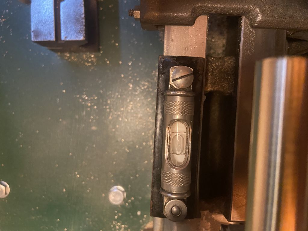

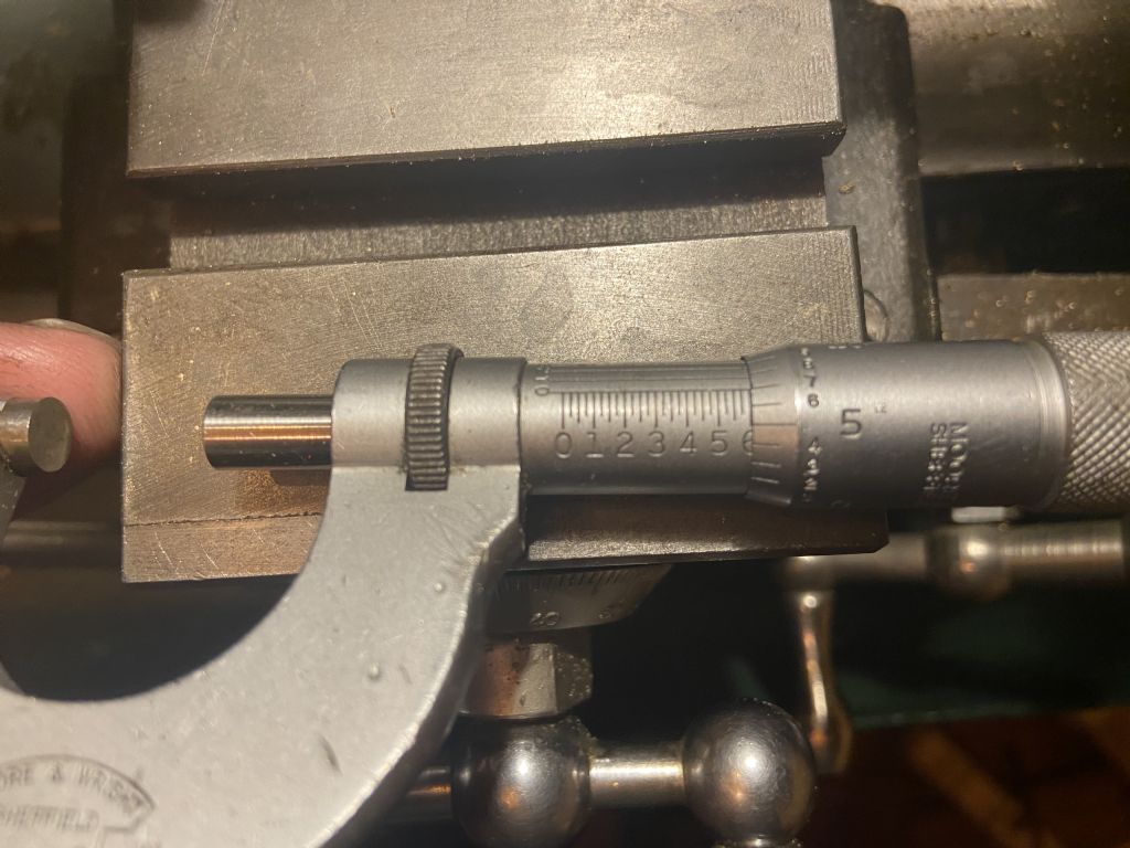

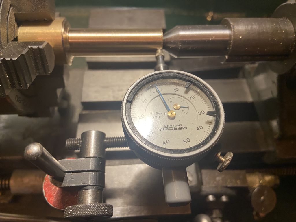

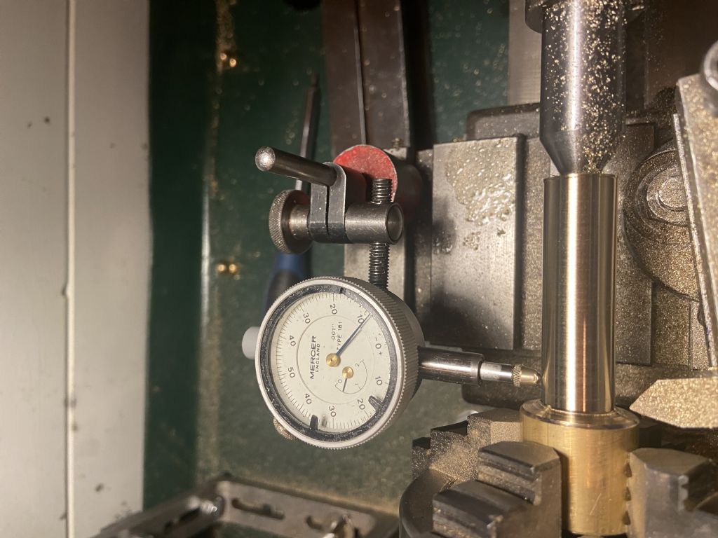

      I am trying to turn a 2” long brass  cylinder to 0.5” diameter, at the same time I’ve been trying to follow Harold’s lathe adjustment instructions on his website.
      I am finding I am getting an unwanted taper of about 0.008 across 2”.
      1) I have used a level to check the ways for twist and it seems minimal.
      2) The gibs all seem tight
      3) I added tail support (I was getting 0.015 before I did that). I realigned the tailstock when I did that.
      can anyone please suggest the most likely thing to check or recheck?
      A few pics below.
      thanks
      Steve
      Edited By Steve355 on 02/10/2021 20:09:35

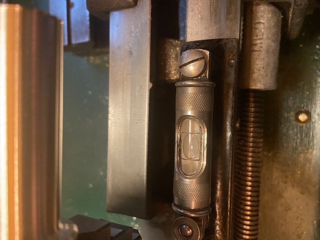

        #565249
        Anonymous
          What sort of level? If you're going to use a level it needs to be an engineers precision level; DIY levels aren't even close.
          There are methods of correcting tapers that don't need levels, but I'll leave those to others to explain as I've never needed to use them. To start with don't try and machine/measure with the tailstock in place. It simply creates two variables (bed and tailstock) to adjust but only one measurement. So it's doomed to failure.
          Andrew

            thats a lot so im guessing your tail stock is not correctly dialed in. If I ever get taper it is always my tailstock alignment which it to blame.

              Posted by Andrew Johnston on 02/10/2021 20:40:55:
              Andrew
              #565254
              Anonymous
                Doesn't look like a precision level; I'd expect to see a number of graduations? What is it's sensitivity? For example on my engineers level one division equates to 0.0005" (half a thou) in 10".
                Andrew
                #565255
                  That’s a neat looking little level, Steve … but have you checked its sensitivity ?
                  At that length: If you want to ‘level’ the lathe with it, a piece of cigarette paper needs cause a visible movement of the bubble.
                  Edit: Andrew [predictably enough] beat me to it.

                  Steve355
                    @steve355
                    Posted by Michael Gilligan on 02/10/2021 21:04:10:
                    Edited By Michael Gilligan on 02/10/2021 21:05:31
                    Obviously it’s an eBay special, but I had to try to find a small one as the lathe is only tiny, I don’t have much info on it other than it’s a Starrett. I will check it with the smallest feeler gauge I can find and see what it does.

                    Pete Rimmer
                      @peterimmer30576

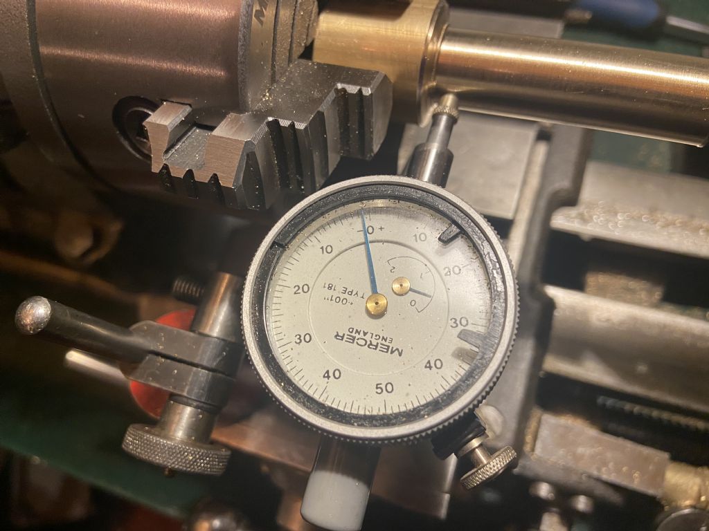

                      Put the mag base for the dial gauge on the front of the saddle and do your measurement again. That way the dial gauge will be following the path of the tool and should read zero all the way.
                      That gauge setup is a poor way to check for taper if that's what you're doing Steve. You should be using a micrometer to take measurements at each end of your cylinder. The dial gauge reading can be affected by twist or wear in the bedway.

                          Steve355
                            @steve355
                            Posted by Pete Rimmer on 02/10/2021 21:10:42:

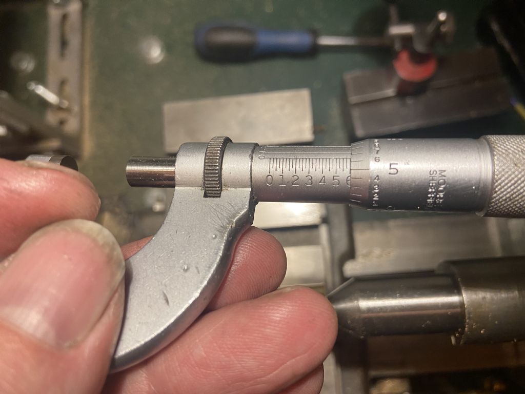

                            i measured it with the micrometer and got exactly the same result, but it’s easier to show on a picture with the dial gauge. But I will try what you suggest,thanks.

                              Starrett improved machinist level series is a truly American product that is available in varying lengths of 4/6/8/12 inches. The company offers five different models under this series each having a long graduated spirit level that has a sensitivity of 0.42 millimeters/meter or 0.005 inches/foot or 80-90 seconds of arc.
                              Given that your vial is not graduated, I have to assume that it comes from another range.
                              Maybe inferior, or maybe just earlier … but certainly worth checking the sensitivity.

                                Steve355
                                  @steve355

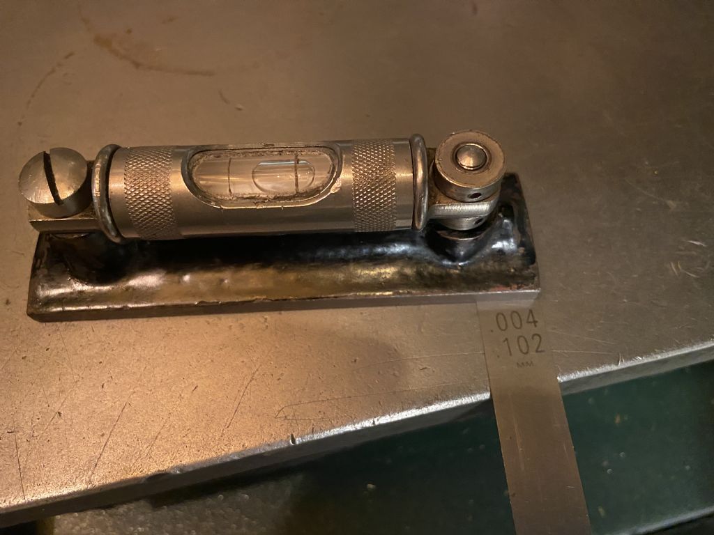

                                  Ok, just had a close look at it, it isn’t a Starrett but a Rabone. That makes more sense,
                                  here is a 0.004 feeler gauge under one end. I would imagine that makes it sensitive enough to be useful?

                                  Steve355
                                    @steve355

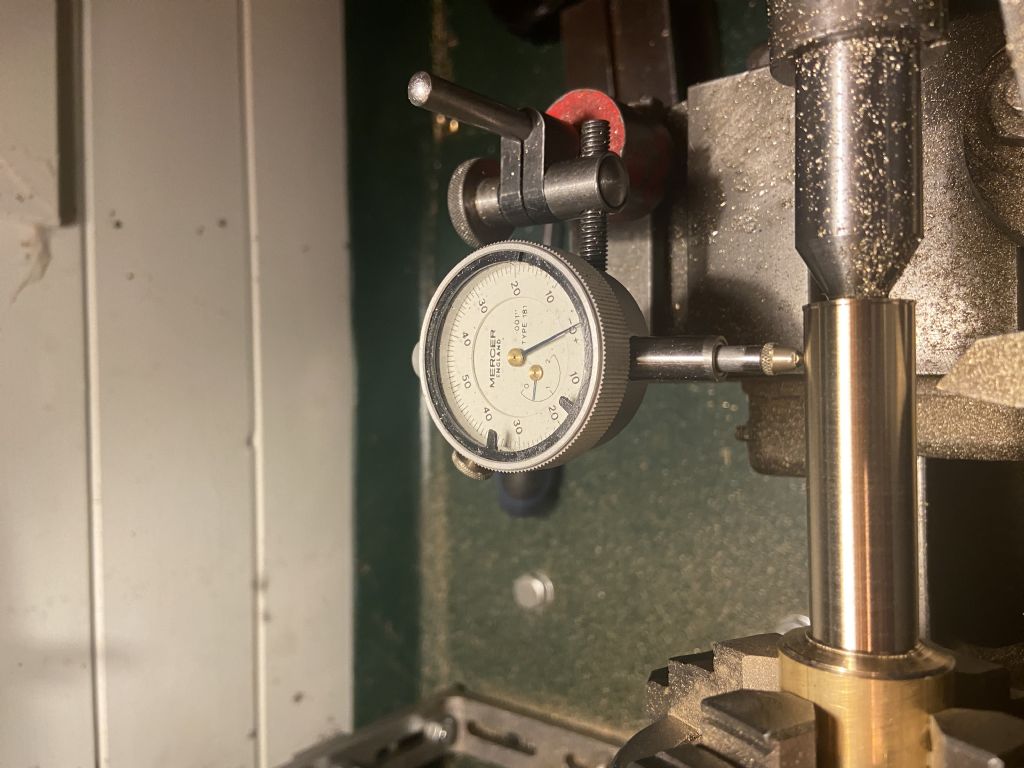

                                    Posted by Steve355 on 02/10/2021 21:18:56:
                                    i measured it with the micrometer and got , but it’s easier to show on a picture with the dial gauge. But I will try what you suggest,thanks.
                                    Ok, you are right, it’s all me. I did that and it’s very close to parallel – about 1 thou out. I checked again with the micrometer and got the about .5 thou. Luckily this is the “beginners” forum so I am allowed to be an idiot.
                                    Why did it give me an incorrect reading on the other side then?
                                    #565268
                                      Posted by Steve355 on 02/10/2021 22:06:57:
                                      I agree … so that’s one ticked-off the list yes

                                        #565270
                                        Anonymous
                                          Not really, it needs to be more than an order of magnitude more sensitive, along with multiple graduations.
                                          Andrew

                                          Pete Rimmer
                                            @peterimmer30576
                                            Posted by Steve355 on 02/10/2021 22:17:10:
                                            Hard to describe in words coherently but easy enough to show.
                                            Your dial is not actually measuring taper as such, I mean it MIGHT be or there might be a taper when it's showing no movement. To measure taper with a dial you'd use a comparator stand.
                                            With the dial on the front and mounted on the saddle it is following the same path that the tool took when it did the cutting. It should therefore give the same reading all along the length. If there is any wear or twist in the bed then where the tool was caused to move away from the centreline of the part, so would the dial point. It would show no change.
                                            With the dial on the opposite side of the part if there was wear or twist causing the tool to move away from the centreline of the part then the same wear or twist would cause the dial to move TOWARDS the centreline which would give a rising reading.
                                            #565298
                                              To be explicit, an ordinary bubble level won't cut the mustard. They're good for putting up shelves and most other purposes but aren't sensitive enough to detect a twisted lathe bed.
                                              You need an Engineers aka Machine Level. They are made to detect tiny deviations from level, as required to set a lathe accurate to a thou or two over several inches. Typically, in a new installation the lathe stand is set up with an ordinary level first, and then the lathe is tested. If not cutting straight a Machine level is used to check for bed twist, which can be corrected by shimming a foot: some machines have screw-adjustable feet.
                                              This example is made by Dasqua and sold by RDG.
                                              In theory new lathes are confirmed to cut straight on a true level surface in the factory, so plonking them down on any decently stiff flat surface should be good enough. In practice, don't expect too much of inexpensive hobby or elderly lathes. Note flat rather than level. It's not necessary for lathes to be level provided the bed is straight: they work perfectly well in storm tossed ships. Levelling is just one way of eliminating twist, and a bent stand is one way of accidentally twisting a machine.
                                              In my book Machine Levels aren't good value for money. Pricey and much too sensitive for ordinary work. Fussy and the bubble takes an age to settle. Good for anyone installing lots of machines, dubious for putting one into a shed! After being used once to set-up the owners lathe, I suspect most Machine Levels end up in a cupboard. As an alternative, Rollie's Dad's Method takes longer and is more complicated to do than detwisting with a good level, but it requires no special equipment.
                                              A word of warning: high-precision measuring is so difficult it's quite easy to lead oneself up the garden path into a deep maze of confusion. A wobbly DTI moving on a slide will cause trouble. When measuring into the 0.02mm / 0.001" region don't rush to adjust anything based on amateur measurements: they're likely to be flawed because taking them properly is a skill you don't have!!! Therefore, keep measuring simple and use the right tools: detect taper with a micrometer, not a DTI. Check everything – it may take several hours practice to get a micrometer to repeatedly read the diameter of a precision rod consistently. Positioning the micrometer correctly is important, and so it applying the same pressure to the screw every time. The ratchet helps, but trained craftsmen rarely use it; they develop a 'feel'. Some are better than others, so find out how good you are by practising. In the meantime, don't jump to conclusions!

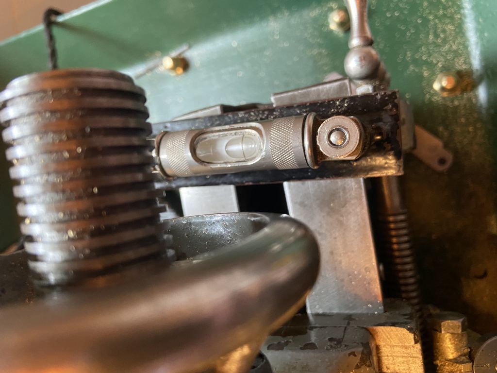

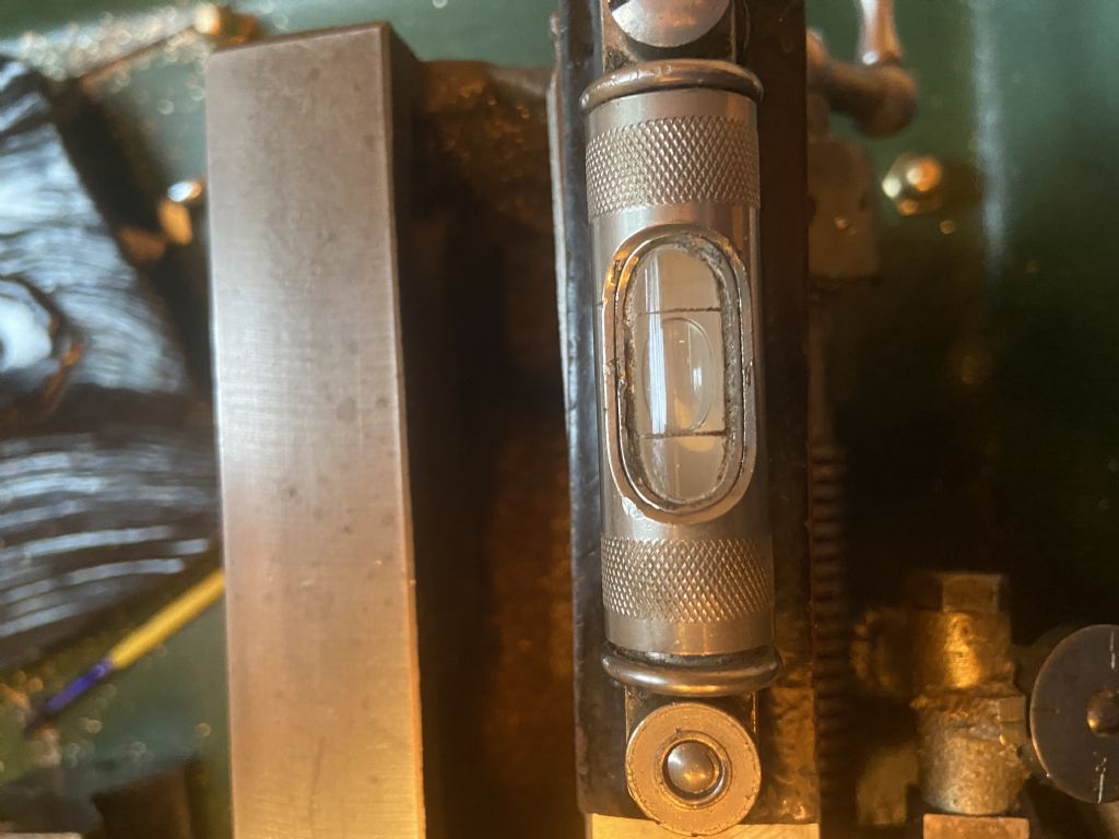

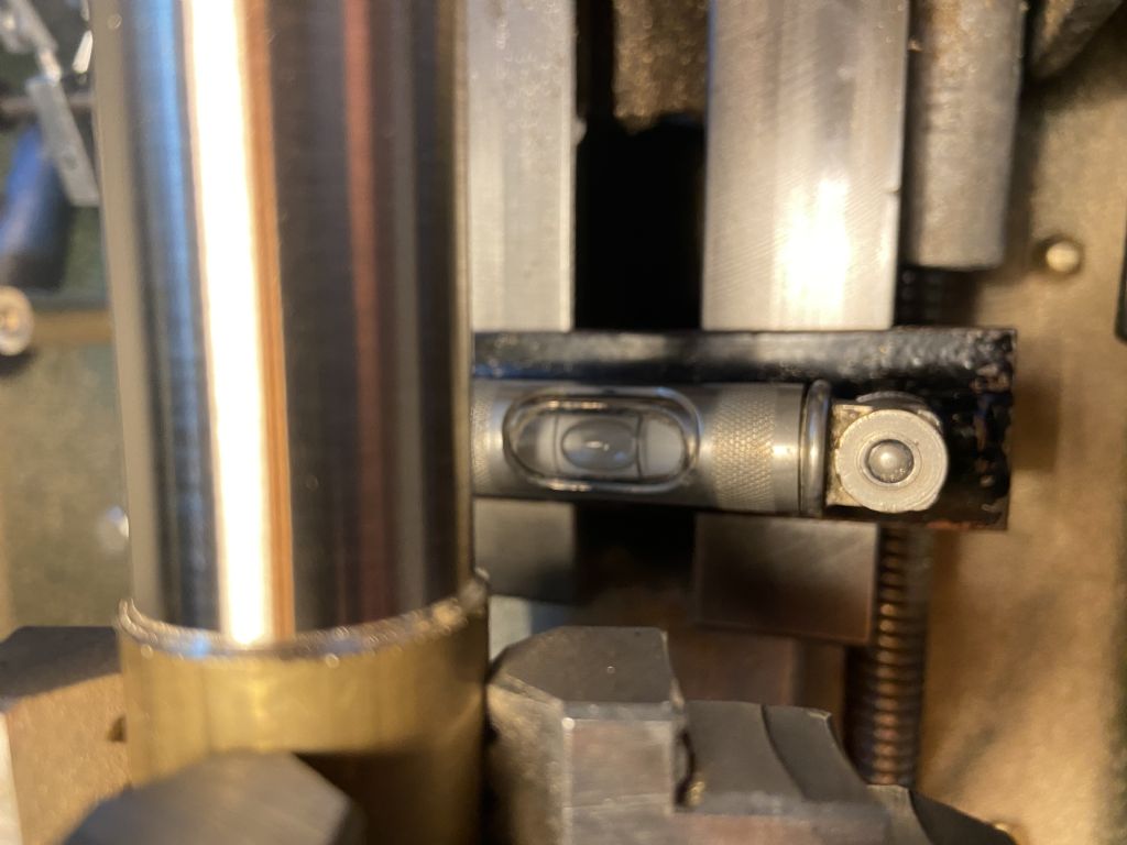

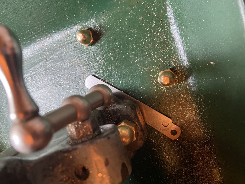

                                                    when I remeasured my work this morning the taper was back 😢 no idea how but it clearly is
                                                    So I thought I would try what several have suggested and turn a new piece of brass rod without tail support and try shimming the tail end to get it parallel. So I did that…
                                                    my first measurement was 935 at the headstock and 961 at the far end. I added shims tightened it back up and took several more cuts and measurements.
                                                    now I have quite a lot of shim (about 030) and my level (love it or hate it) indicates a significant amount of twist that wasn’t there before. Headstock:
                                                    tailstock:
                                                    shims :
                                                    my latest measurement is 908 at the headstock end and 920 at the tail end, so quite a lot better but nothing like close enough. I am starting to think this is nonsense, because I seem to be adding twist to try to reduce taper. In addition the finish is bad at the far end of the bar, which is what one would expect I believe, and probably enough to account for the taper.
                                                    basically it doesn’t seem to be working. I’m worried too I could damage the lathe.

                                                      Steve you might well damage your lathe If you keep that up. You don't say what lathe is actually is. It could be that your bed is level but the headstock is not pointing straight down it.
