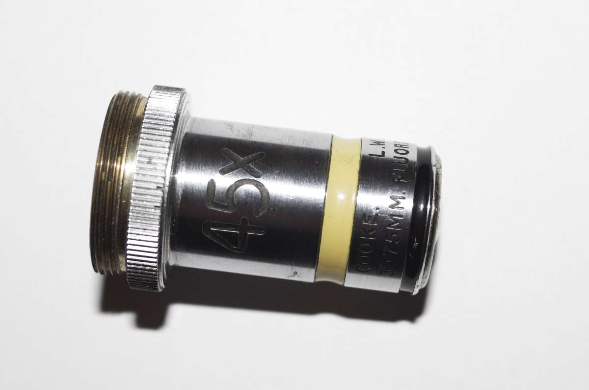

      I bought a job lot of microscope objectives really cheap which were not in usable condition. This was to get hold of the bodies to convert some of my existing objectives to sprung because I have been destroying some slides lately. Amongst the collection were some which had been labeled as unfocussable, rather than the commoner delamination.
      One is a Cooke X45 0.95 fluorite oil which is also marked LWD. I couldn’t see any trace of the common delamination which ruins most fluorites but couldn’t get it to focus with oil. This objective is rather short, about 33mm long, so I had to use a parfocal extender and was just giving up the tests when it snapped into focus. The working distance even with oil is about 1.5mm which needs a large drop of oil. It might get shoehorned into a Vickers body if I can reduce the body diameter by 0.35mm, or bore the Vickers out that much. It would probably be worth it as the image is very good.

          The idea is to convert the Cooke to sprung nose.
          As for the non focussing, the original owner and myself were trying to use the lens much too close to the slide and it was pure luck that I lowered the stage while still looking through the eyepieces. I have a cheap set of prepared slides which won’t work with higher magnification objectives, the cover slips are nearly 0.5mm thick.

                I would normally avoid fluorite lenses as they are very prone to faults. They delaminate and it is impossible to clean the fluorite surface as it is soft. Fortunately, modern low dispersion glass formulations make fluorite obsolete. There was a time when some top end camera lenses also used fluorite elements, they tended to have short lifespans. The old Cooke is very rare not to have any optical deterioration that I can detect.
