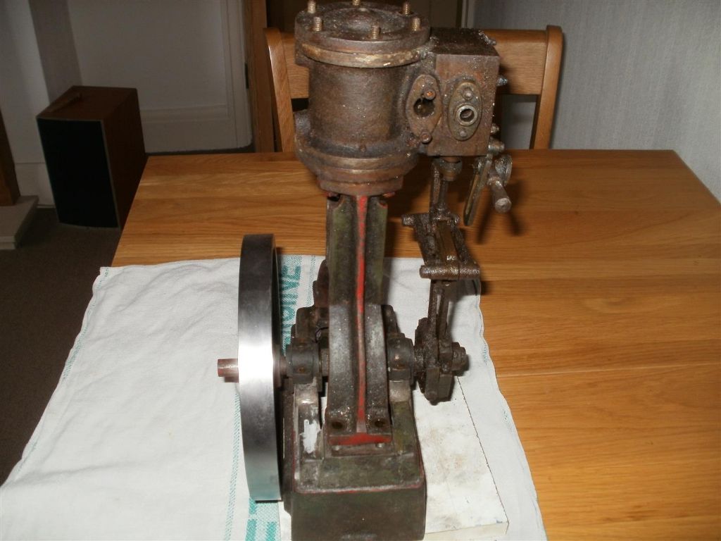

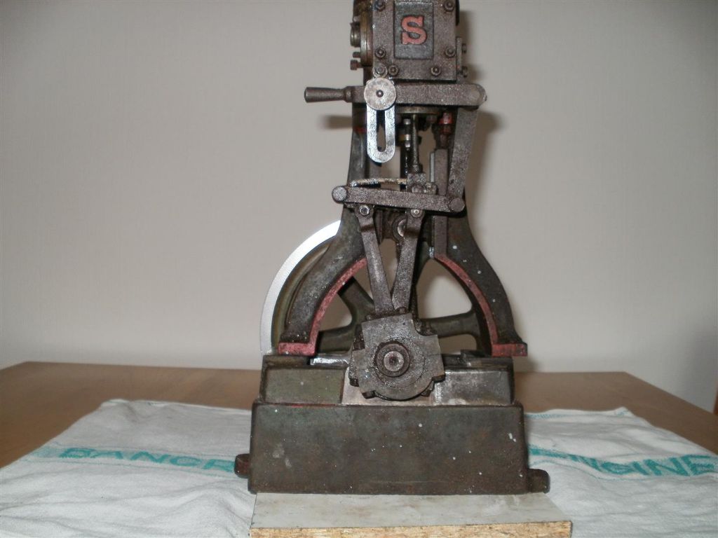

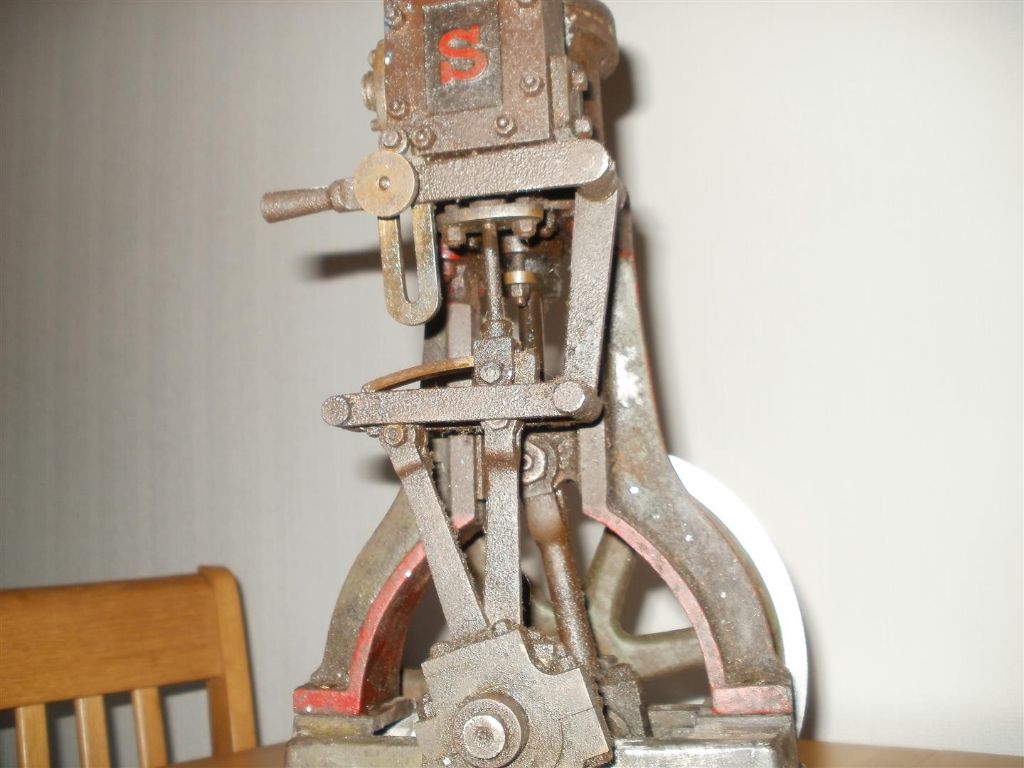

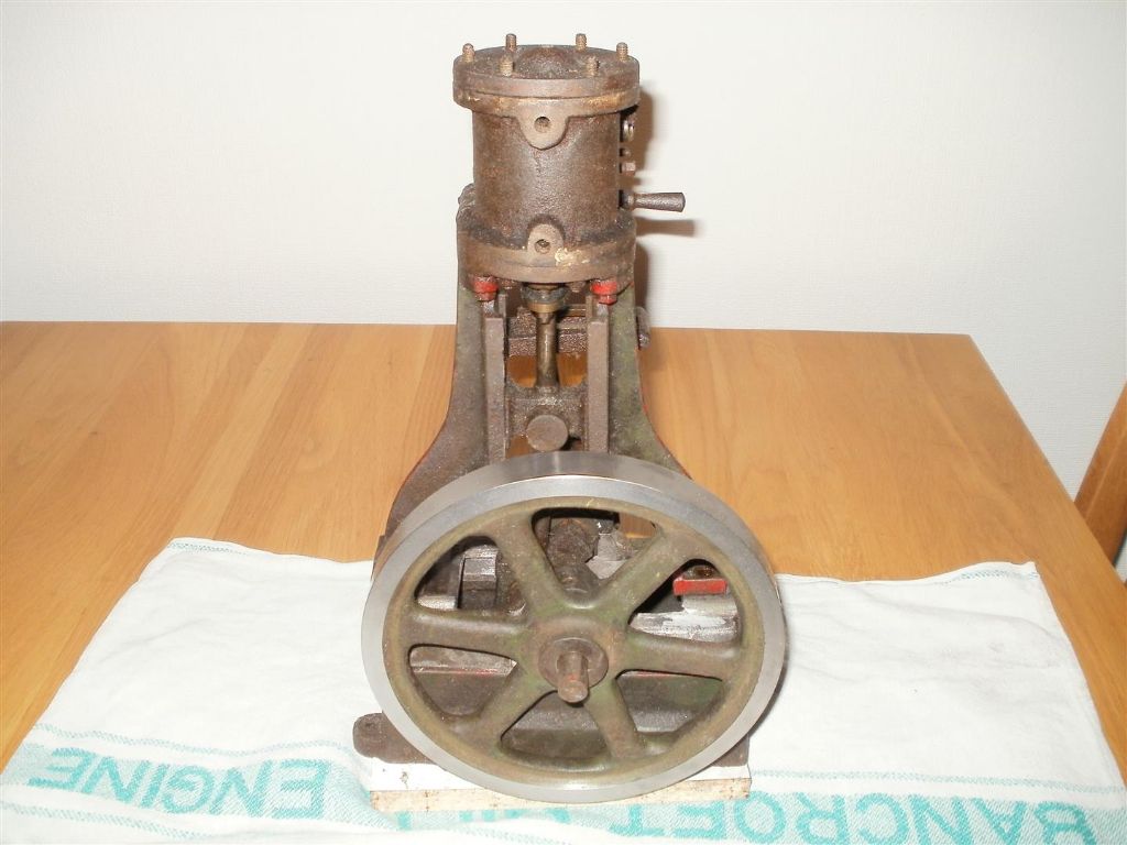

        pb261860 (large).jpgpb261862 (large).jpgpb261867 (large).jpggood Morning.
        Can any body help to identify this Stuart Turner engine.?
        It's 13 1/2" high, 2" bore & stroke with a 7 1/2" fly wheel..
        The steam inlet and exhaust are on the same side of the steam chest/cylinder..
        The cylinder bore/stroke would suggest it's a number 1 but as you can see it has two separate vertical standards with the piston rod/ crank small end guide running between them.More photo's in my Stuart Turner album.pb261853 (large).jpg
        As you can guess it's a restoration project!
        Thank you.
        Ian

          Hi Ian ,
          ​Looking through the Stuarts catalogue I would suggest it is a No1…with a modification to the frame work & reversing gear added…
          George

            Ian.
            I do not have my early Stuart catalogues ; my son seems to have them for some reason. However what you have is probably an early No 1 engine, and by early I mean pre WW2. I seem to remember that these machines had two cast standards rather than one standard and a support column. When I lay hands on my catalogues I will have a look.
            Mike Potts.

              As Michael says I have seen other early No1 engines with the two part standards like yours, think they may well be pre WW1

                    Just to correct the fly wheel dimension. it's 71/4" not 7 1/2" as I originally stated..

                      Hello Ian,
                      I think it's a number 5 (Not 5A). I have one that was built in the 1920's and entered into an exhibition in Liverpool. It is indeed 2"x2" and similar to the number 1 except for the double standard. When I have a spare minute, I'll post some pics along with a page from a 1924 Stuart catalogue that lists the casting set.
                      Best regards,
                      Steve.

                            From my 1961 cat it looks like a No 1 with various mods. Left hand support is a bar not as shown in your photo.
                            Certainly the reversing gear looks like the one shown on the No 5
                            No 1 has a 2" bore and Stroke and is 13" high.
                            No 5 has a 2 1/4" bore and a 2" stroke and is 15" high.
                            Hugh

                                  Posted by Rik Shaw on 27/11/2017 16:05:39:
                                  I've got one. It's a 5a.
                                  Rik
                                  5A has a tubular trunk guide and the "A" frame standard is a single casting. The one in the photo has flat guides and the standard is two separate castings.
                                  5A is also 2 1/4" bore but the 5 is 2" bore and 2" stroke so possibly a No5

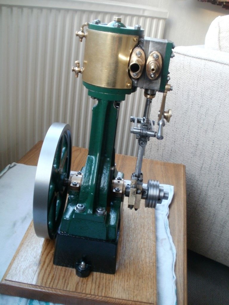

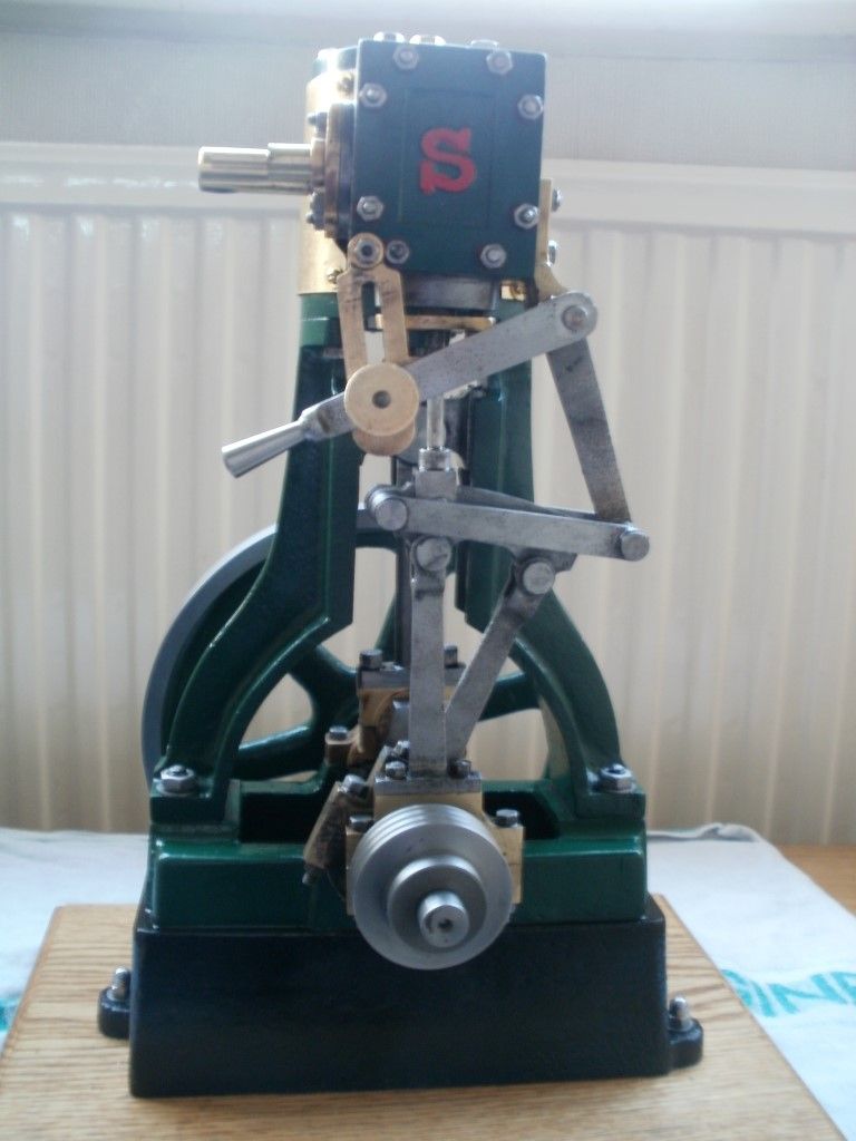

                                          p1101885 (medium).jpgThought I would just update you with a couple of photo's of the engine.I made several new parts:-
                                          New crank shaft, piston rod, valve rod, slide valve, exhaust and flange and piston rings.
                                          Painted satin mid Brunswick green.
                                          It runs on compressed air quite well but it's got a knock which I'm pretty sure is coming from wear between the cross head and the bottom of the vertical columns.
                                          Here is a link to a short video of it running on air;-
                                          **LINK**
