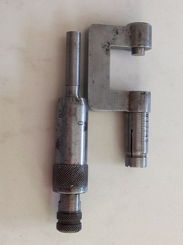

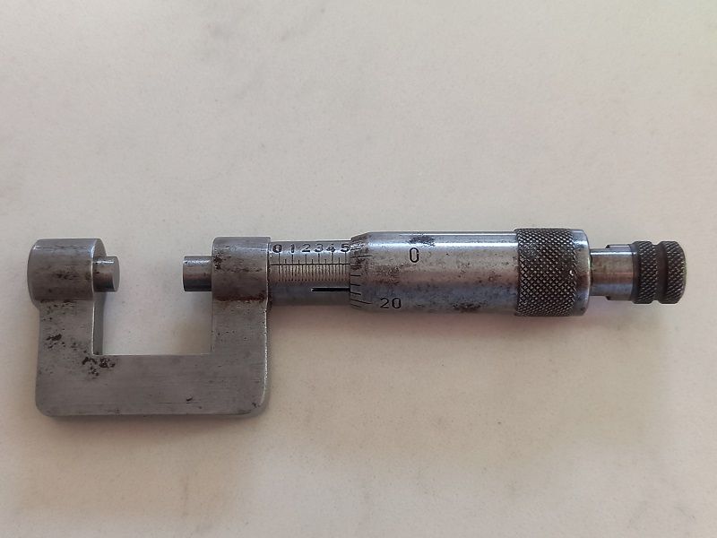

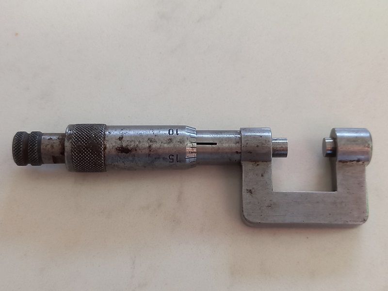

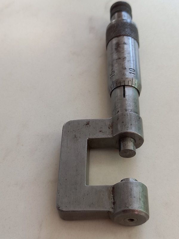

      I have an old unknown brand of 0 to 1/2 inch micrometer in 1 thou steps, 25 thou per revolution . Does anyone know what country it may have been made in, and what approximate years these were made? It does have an adjustable thread band, and the nut is split into 3. It also has a constant pressure ratchet on it as well.
      Thanks in advance for any information about it.

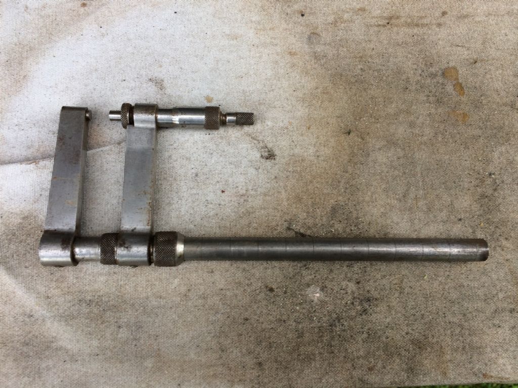

            Could be an apprentice toolmaker exercise ? This is an adjustable 0 – 6" in 1/2" steps that I "inherited".

                  Probably made between the wars by a no name assembler supplying commodity instruments to tool distributors or direct to factory. Basically buyers would choose a standard frame, choose the micrometer head from a list and order a large quantity. Micrometer heads would have been bought in by the assembler. That one is unusual in having a proper adjustable nut and setting ratchet. The general run seem to have been rather cruder sans ratchet and having rather poorer markings. I have a metric 12 mm one that is pretty typical of the lower end of the breed.

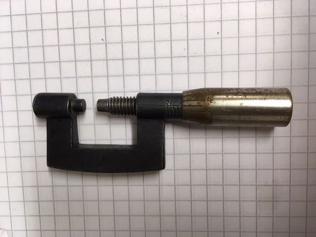

                  Ordinary metric thread form cut direct in the body, fixed scale, screw adjuster on the reference anvil to set zero position and rather crude brass thimble fixed to the screw. Appears to be little used and surprisingly accurate. Good enough to use for real on anything that isn't precision job.
                  Yours won't be a proper, recognised micrometer make as that style of frame would be very old fashioned. Pretty much abandoned by the turn of the century when "proper" measurement tooling makers went over to more sophisticated forged bows and the like.
                  Clive
