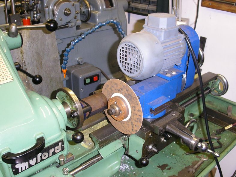

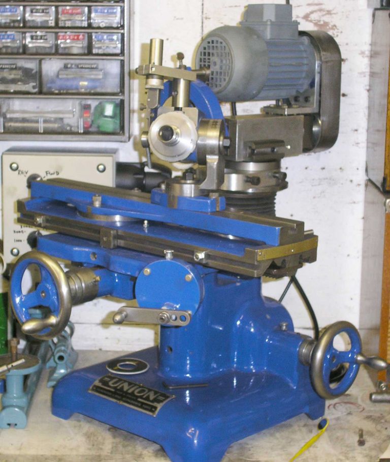

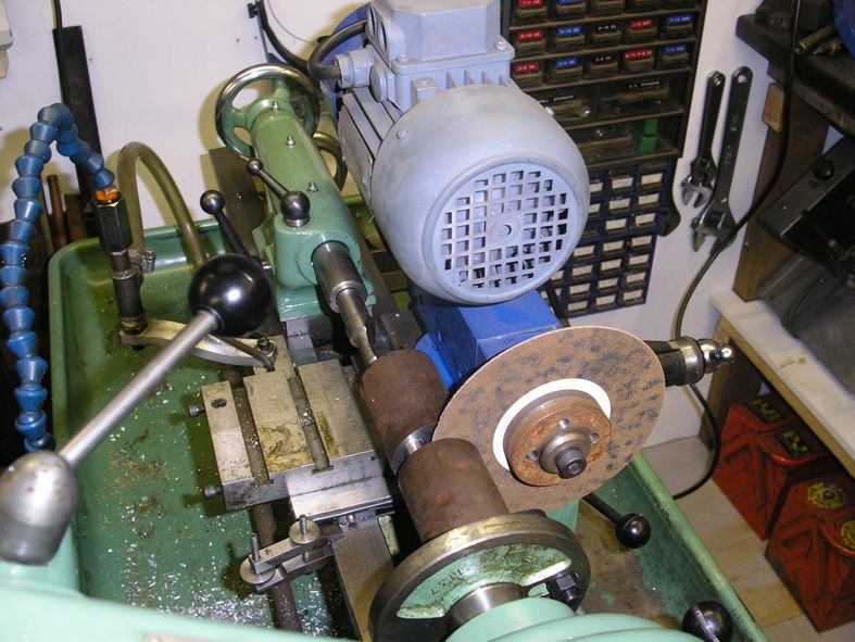

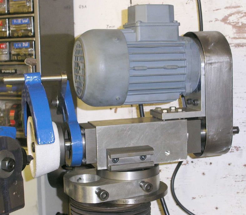

                        Phil P
                          @philp
                          I had similar issues when I rebuilt my Union grinder, another problem is the motor speed is not high enough for the smaller cup wheels. I decided to do my own thing and make a complete new variable speed head for mine.
                          The head also fits straight on to the Myford cross slide for odd cylindrical grinding jobs.
                          I also rigged up a head for doing four facet drill grinding, see photo's in album.
                          Phil

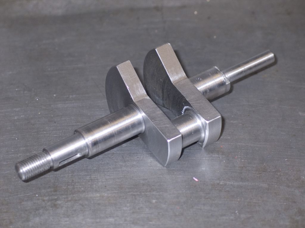

                              Phil P
                                @philp
                                This is what it looks like on the Myford doing a spot of crank journal grinding for a model petrol engine crank made from solid bar.
                                Phil
