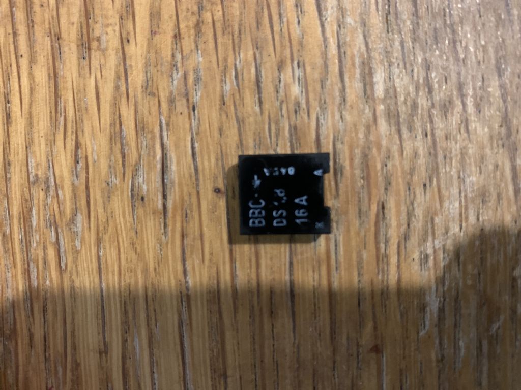

      Hi All,
      Trying to find the fault that is causing the "differentiator" to trip in our consumer box when I plug my Unimat into the socket has resulted in my terminally breaking the diode that allows low speed.
      Can anyone identify this – or propose img_3364.jpgan equivalent that I can hopefully find from my Big Box Of Electronic Scrap

        Andy_G
          @andy_g
          Looks like a DS 1.8 16A general purpose rectifier – 1.7A If / 1600V PIV
          https://www.web-bcs.com/diode/dc/da/DS1,8-16A.php?lan=en&cl=1
          (Possibly used to half-wave rectify the incoming mains to give reduced speed, based on your description, but I have no knowledge of the Unimat circuit).

          John Olsen
            @johnolsen79199
            Yes, that diode gives the reduced speed on the half way position on the switch. It is unlikely to be the original problem since even if it went short all that would happen is that you would get full speed all the time. It is more likely that you have a problem with an interference suppression capacitor, which you are likely to find inside the motor itself. They are intended to reduce the interference from sparking at the commutator, and would usually be connected to ground, so if they are short, or leaky, or sometimes just too large they can trip an earth leakage breaker.
            If that is the problem, make sure that any replacement is of the correct voltage and service rating as they are across the mains and so require to be rated for 240V AC. So a DC rated capacitor is not suitable, even if it has a higher voltage rating.
            It is also possible that the motor windings have gone leaky to ground. Unimat motors get worked quite hard and it is easy to get them too hot. That is why I have two dud ones lying around, and the machine now has a small three phase motor with a VFD.

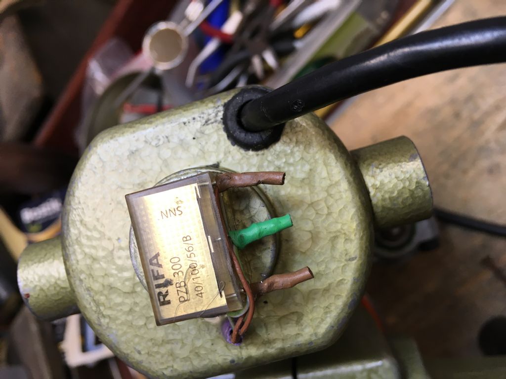

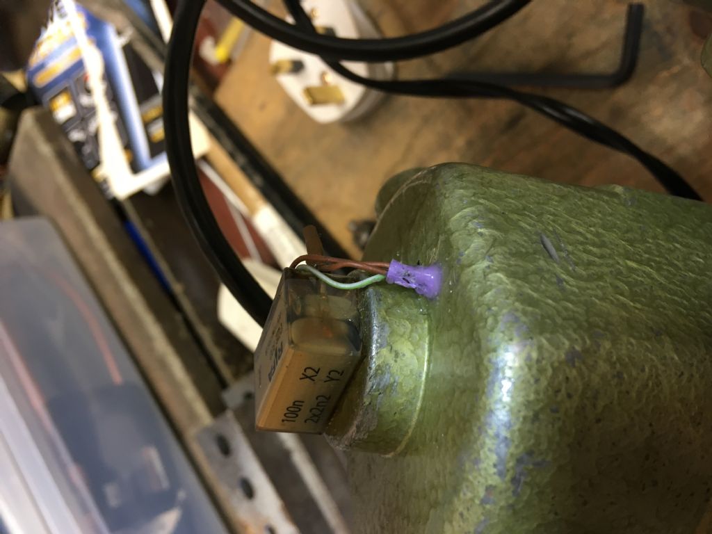

                          Hi Gary
                          From R/S Components –
                          KEMET PZB300 Paper Capacitor, 275V ac, ±20%, 100nF, Through Hole
                          Stock no.:121-5449
                          It is a little too big to fit inside the motor so I added extra lengths of wire to take outside the motor cover. I will try to add a picture of what I have done.
                          The motor is running fine and back on the lathe.
                          J

                            @johnpenfold74932
                            Here are the pictures – rather big I think. J
                            Unimat Capacitor 2

                            John Penfold
                              @johnpenfold74932
                              The side view. J
                              Unimat Capacitor 1
